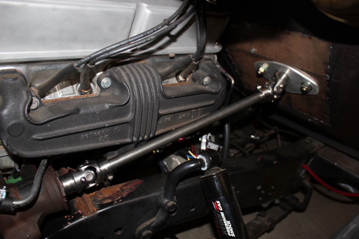

    More of the same lately on the progress. More wiring mostly. But I also mounted a power steering box out of a gen I chevy astro right in the place of the old manual box. (pics to come) I don't even think I'll need to trim the inner fenders. I also made the steering shaft from the firewall to the box.
    And then I bought a speedway tie rod with the pre-tapped ends. And since I was having trouble finding the exact specs on the speedway tie rod, I'll just lay it out for everyone. It IS in fact DOM tubing 7/8" OD x .156 wall. The one I got had a nice black coating on it. My measurements apparently ****ed, so I had to cut mine down. There were enough threads (about 3 in depth on each side) for me to shorten it 2 inches without re-tapping. That's when I found out that my measurements really ****ed, so I had to cut it more and re-tap it.
    The clearance is a little tight with the axle having been flipped, but hey, clearance is clearance.

    Then it came down to adapting the pitman arm to the drag link arm. And since the back of the pitman arm (or drop arm technically) is close to the leaf spring at full suspension compression, I had to keep the drag link connector flush on the back. So I drilled and tapped a 3/4"-10 in the pitman arm, then I had to single point thread the 3/4 shaft (because I didn't have a big enough die). I ***embled it, and drilled and tapped for two set screws to lock the 3/4 shaft in small detents I made.
    When I finally ***emble it, I will threadlock everything. What do you think, is that enough?
    And here is the drag link. I made a bung for the 3/4 rod end, and I had an 11/16-18 one laying around, so now I just have to weld these in. I ordered some cone spacers for the rod end as well. Then of course I'll cut the 3/4 shaft to length. DPP_0006.JPG
    And finally, the steering shaft linkage. I used the same 3/4 shaft, and just milled the DD on each end, and yes, they are in phase. DPP_0003.JPG

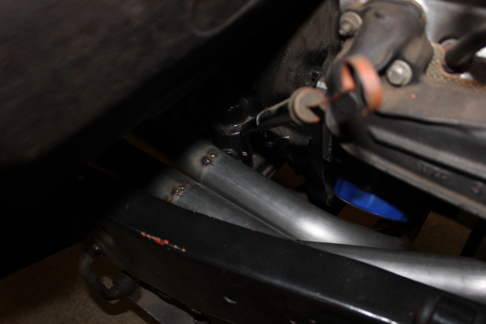

    Here is the latest. I've been doing the fun stuff, building the exhaust. One of those things that's a little easier with the fenders and bed still off.
    From the front,
    driver side:
    driver side
    DPP_0002.JPG that pic was kinda dark, anyway, along the trans:
    and snaking around the trans crossmember:
  12. TroyZC3
    Joined: Jun 26, 2012
    Posts: 230
    TroyZC3
    from Alpine, CA
    And then to the muffler:
    out and over:
    And the grand finale:
    Now I've got to make some hangars from 1/8" plate, take it apart and TIG it up all nice.

    Looks great! I'm liking the astro box solution.. is the drop / pitman arm the one from the Astro itself? Would you want to make another bracket? :) Can you post a couple more pics on how that bracket mounts to the frame? Did you weld tabs on the top of the frame to mount to the back of the bracket? Was the frame cut at all around the pump?
    The job you did on the exhaust looks really sanitary, excellent work!

    The drop arm is from the astro as well. It is nearly a perfect geometry match to the original manual box. I don't think I could make a bracket and be ***ured it would fit your application for a couple reasons: I tucked mine in real close to the engine to avoid cutting the inner fenders (haven't tried to fit them yet, but if I have to trim, it will be a minimum). And also because it is sorta a tack-in-place operation to make sure there is no binding. So the bracket is welded to the frame at two points and bolted to the front crossmember at one point. The two welded sections were split, then a lap-type joint welded to the frame side, then nuts welded to the back of those, then the removable "cage" type part needed thru holes to bolt on. Those are the four bolts you see in the very bottom of post #218. When I remove the box for painting soon, I will take more pics that will explain it clearly.
    And finally, no, the frame was not cut at all, but the box is so low, it is essentially sitting on it. And as a side note, for my axle setup, the box had to be reverse rotation, meaning clockwise input = counter clockwise output (from looking at the ends of the shafts).
