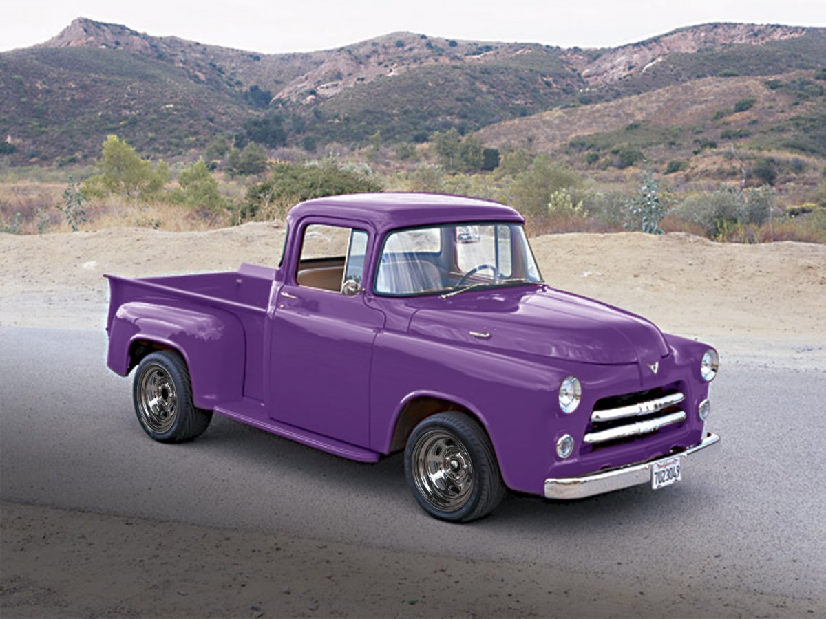

    I had some good progress lately. I sorted out all the leaks in the brake lines (for now). But when I went to roll it outside to do some more engine tuning and test the transmission, one of the temp tires blew. So now it is time for getting the real wheels and tires.
    This is how I feel about wheels. When I go to a car show, I always see these cars with flashy wheels, but since it is the first thing that pops out, a lot of hot rods look the same at first glance. So I want to go with a steel wheel. I thought about some smoothies, but I don't want chrome center caps. So then I thought about like an old style race wheel, and I found Aero race wheels. I had the photoshop forum do a rendering for me with future plum crazy paint. What do you think? Plum Crazy Rendering.jpg
    I definitely want to have a little more sidewall filling up the fenders, but I think it is pretty close.

    Is purple/tan your final color choice?
    ...how about some cop-car wheels?

    I do like the cop car wheels, trouble is finding them in the correct bolt pattern(s) because I have 5x4.75 on the rear and 5x4.5 on the front. The good thing about the other wheels is I can get whatever offset, boltpattern, etc.
    And the color should be darker than the rendering for sure, and the interior will be black, so minor differences. I'll look around for some of those police wheels.
