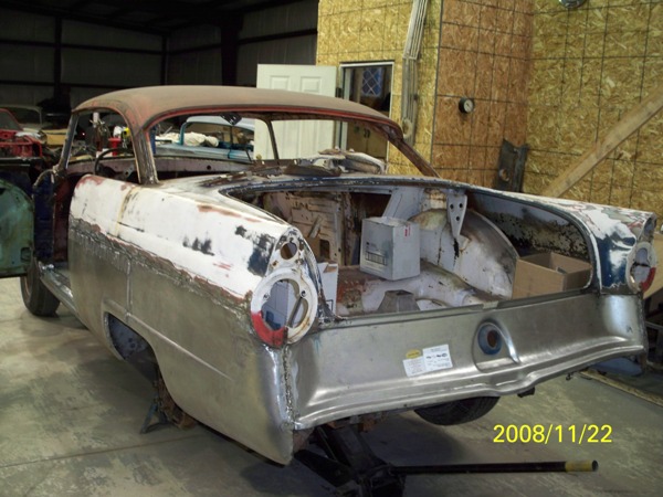

    Those side mouldings, door handles, tail lights, and the trim around the grille opening really need to come off before you do any primering and painting. Tape lines between trim are where a lot of chipping and peeling start. To remove all that stuff shouldn't be more than a couple of hours of work. I generally do that stuff first, to avoid getting sanding scratches and welding spatter on the trim.
    Looks good though, you're not that far away from paint at this point. I see mud where the V8 emblem and the Customline script were. Were those holes welded shut, or just filled in? If they were filled, you might want to grind them out and weld them shut while you're at it. Mud over a hole will shrink back and sometimes bubble out even if it's not a rust hole.
