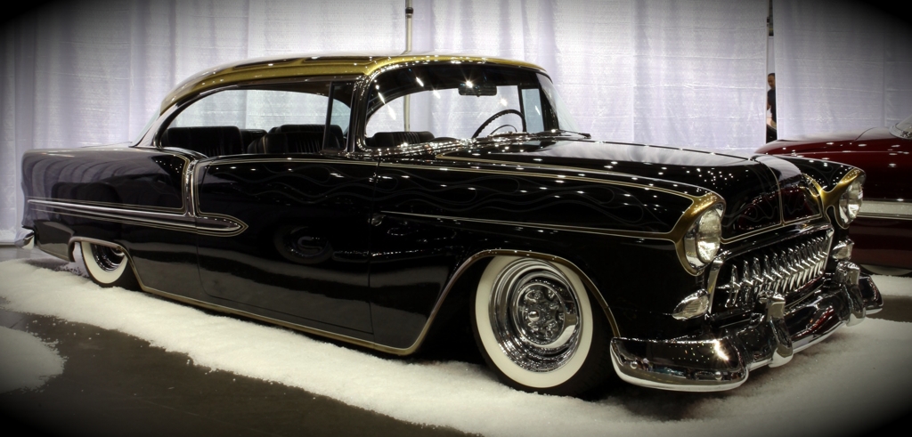

    I do like the styling, going mild custom for sure. Roof doesnt need a chop, looks low enough to me as it is. Just removing some excess badges, maybe shave the handles. As far as paint though none of the stock ones are getting me excited. Right now i'm leaning more toward something like this...Black with some fancy roof work. ditch the striping.

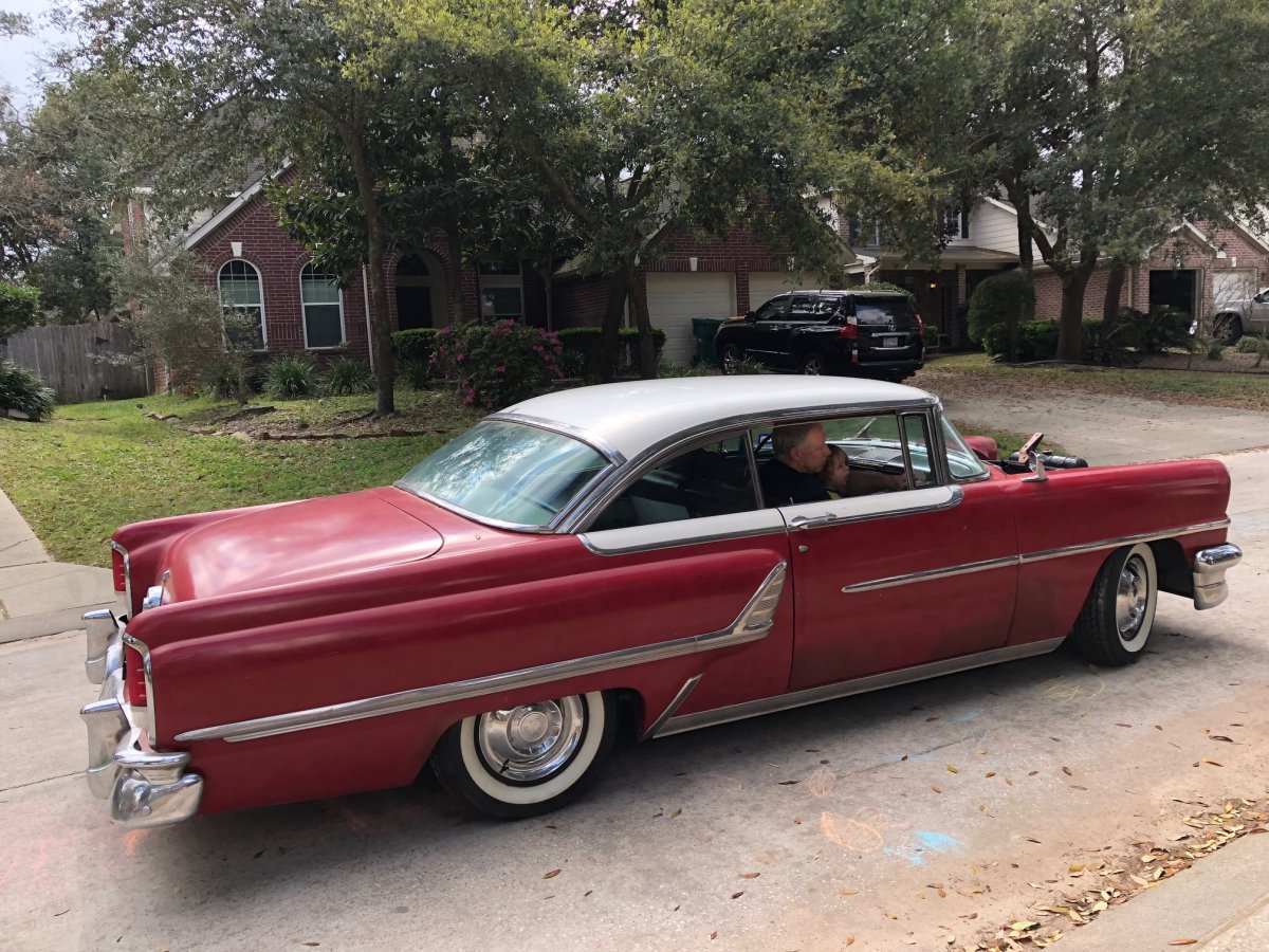

    Most recent photo ive got out on the road, squint and you wont see the mirror. I really want to find some '56 side trim for the rear quarters, ive seen that swapped out and it looks sooo much better. The only difference is that its flipped with the long strip of the trim at the top

  17. abonecollector
    Joined: Oct 7, 2009
    Posts: 411
    abonecollector
    Yep. that's the way it should look.
    hans mercman likes this.
