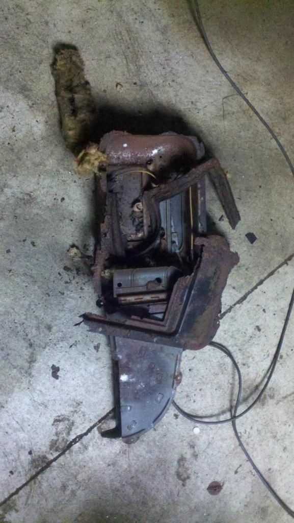

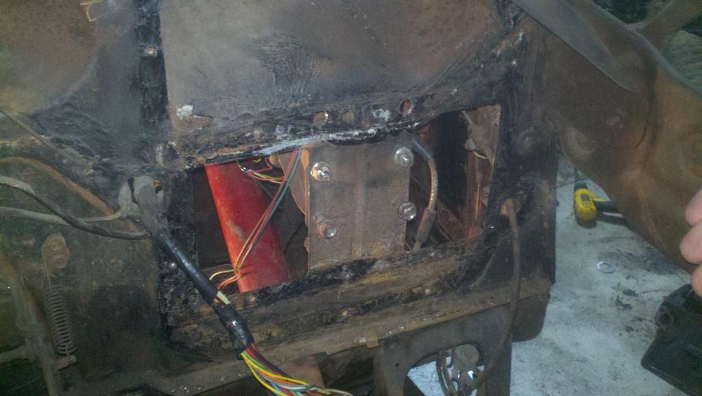

    Here is my heater box. Anyone have a spare one? There is no fixing this. This is why draining the cowl through the blower box is a bad idea. The heater core was good however.

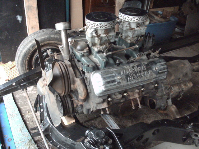

    like the aluminum intake idea it make those motors look sweet. here is a couple pics of mine in progress. it will need to be rebuilt but i had to set it on the frame and get a good look at it, i like it!!:D

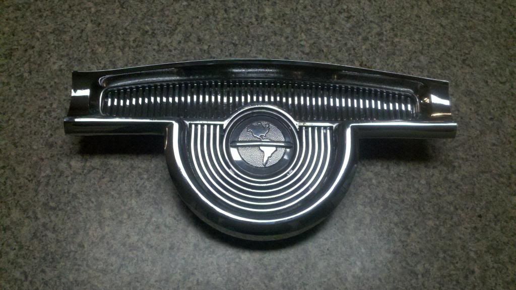

    Finished gutting the interior (dash) and cleared the firewall off. I got the instrument cluster off and cleaned up, as well as the speaker grill/clock bezel on the passenger side. My car came with a clock, except somebody swiped it before I got the car, so I made my own clock delete plate using the center of one of the bent up full size hubcaps that came with the car. I cut it to size, enlarged the hole in the clock bezel a little bit and held it in with two screws I robbed from a spare light switch that way laying around in the garage :D it looks perfect! I love it. Check it out.

    Cool clock delete! I was lucky enough to find a 55 Olds with both a clock and radio delete. My other 55 Olds had a clock, but I wasn't creative like you and just put a convex mirror in it's place.

    nice clock delete plate you could almost swear that was a factory set up.

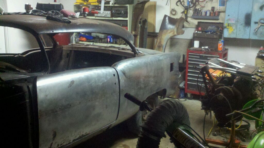

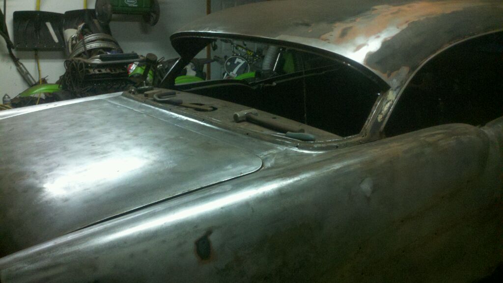

    Got the car stripped down to bare metal today. Its very encouraging when you finally get to the transitional period from disassembly to reconstruction. I dug some lead out of the joints that were questionable, and didn't find anything catastrophic, just some rusty spots that need patch panels. Pictured are the rear roof posts and the rust on them, which is a common place for the tri-five Buick/Olds/Pontiacs to rust. A few bends in the brake and patching will be no problem. I also got a very nice heater box and heater core from fellow hamber 1954 rocket 98 (thanks again mike!)

    man you have been bustin ass on getting that paint stripped looks good, i need to get busy on mine now. does that rocker panel look like its going to work?

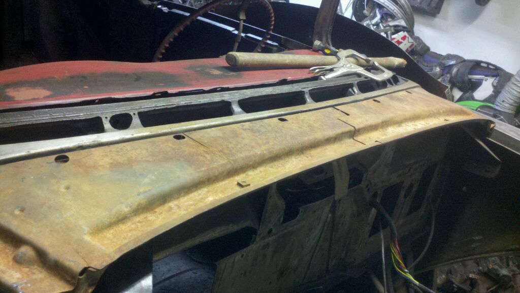

    Been slow the last couple weeks cause of the holidays, but I got the dash sanded ready for nice dark red and made pieces for the rear roof pillars. Came out pretty good.

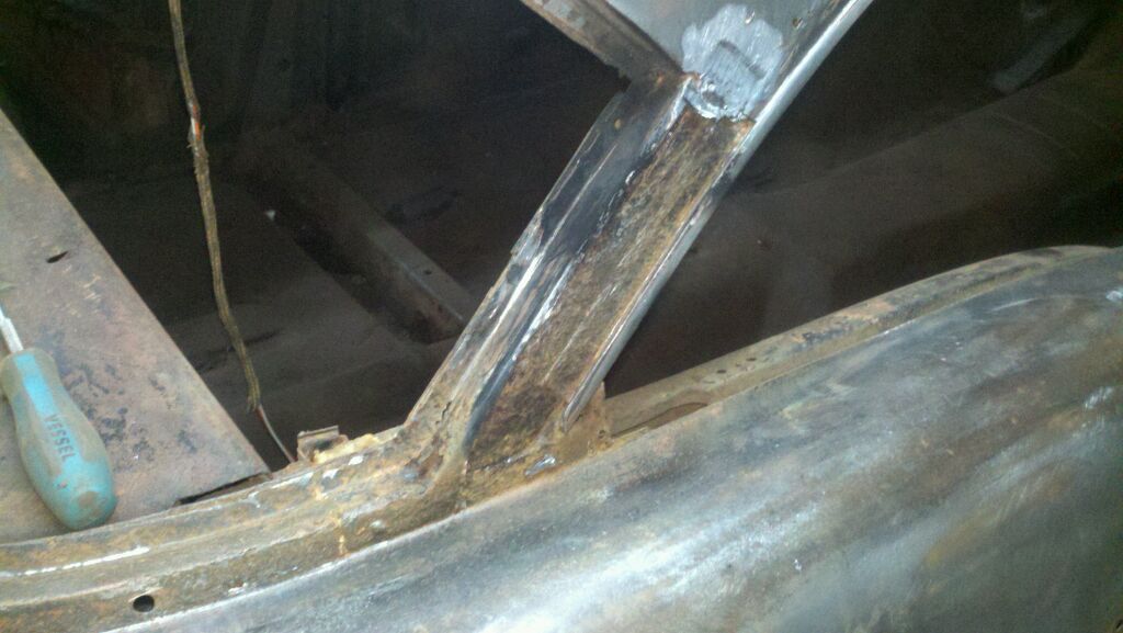

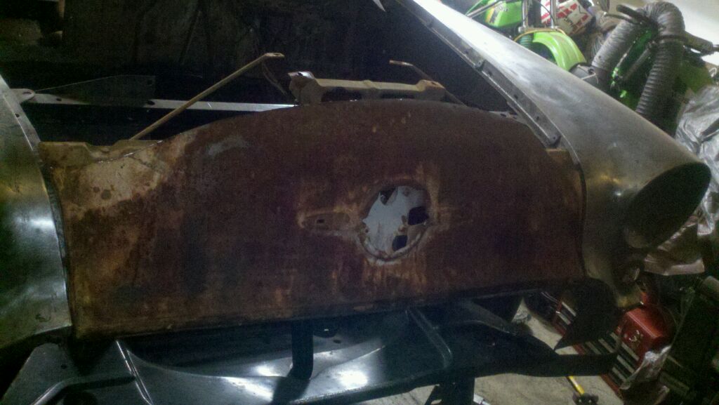

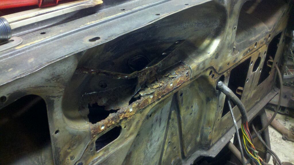

    Got rid of some more rotten steel on the firewall and made patches to go in. Its amazing how a small rust hole isn't so small once you start digging.

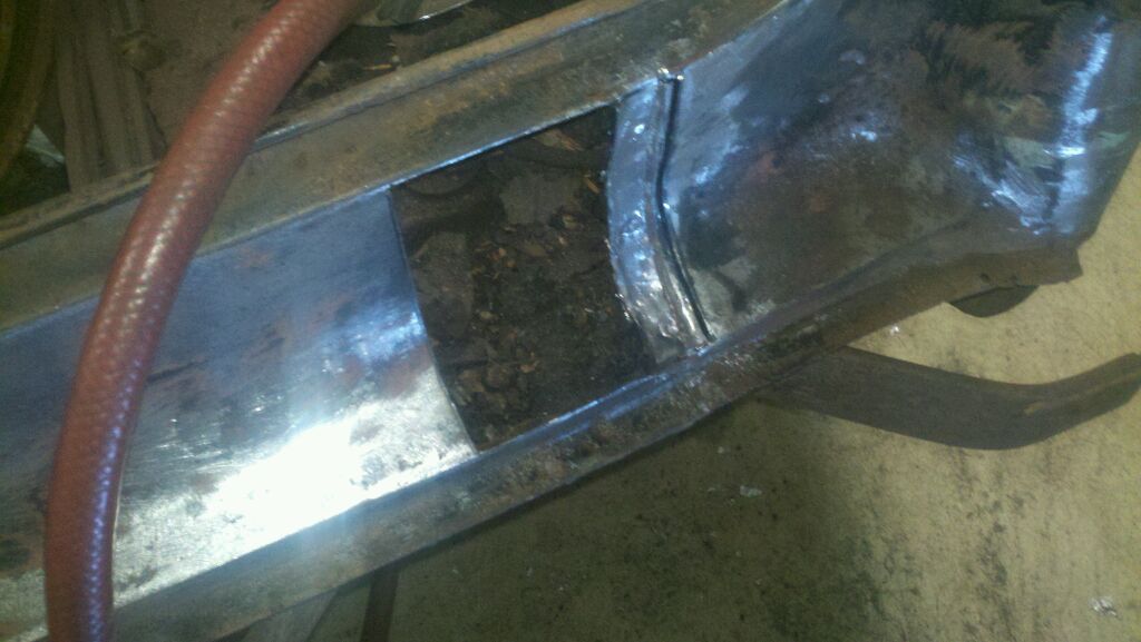

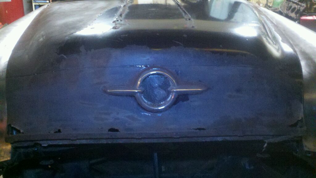

    Got the doors and trunklid gapped, more rotten steel cut out and patch panels made. I am also making one good hood out one, replacing the front edge and passenger back corner (the original hood was rotted at the front lip, and kinked). The second one I have is solid but very bent up ( I think it was walked on). We got floor pans, rocker panels on the way and I got a replacement hood plane and world emblem thanks to a fellow hamber.
    I can't believe how many hours I have in bodywork already and im not even halfway done. Its alot of fun however and everytime I work on it, it gets a little better.

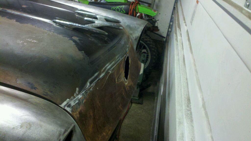

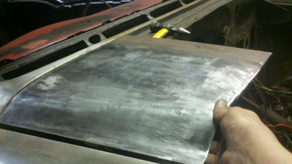

    Cut the front of the original hood off and went through the painstaking process fitting the piece from the second hood, cutting a little at a time until it fit just right. Took me about 4 hours.
    The hoods on these cars were notoriously problematic. The spot welds holding the framework the hinges attached to broke away from the hood itself and they never closed right, chipped the paint on the edges and ultimately kinked. I will show here how I will go about fixing mine for good.

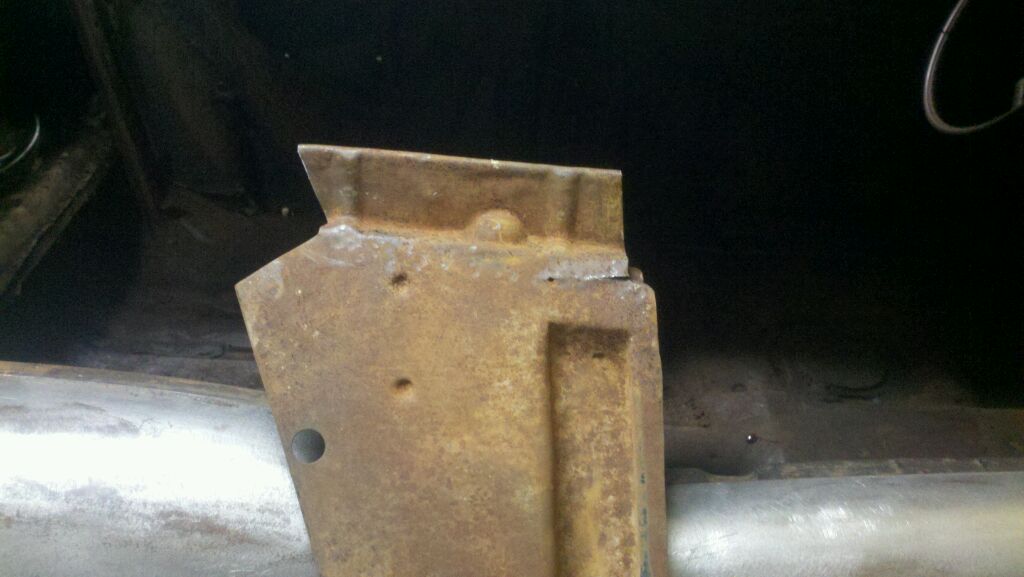

    I pictured the cracks in the hood framework from fatigue. We are going to weld up the cracks, add quite a bit of gusseting, and weld it back into the hood skin to never come back out.

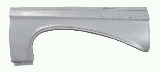

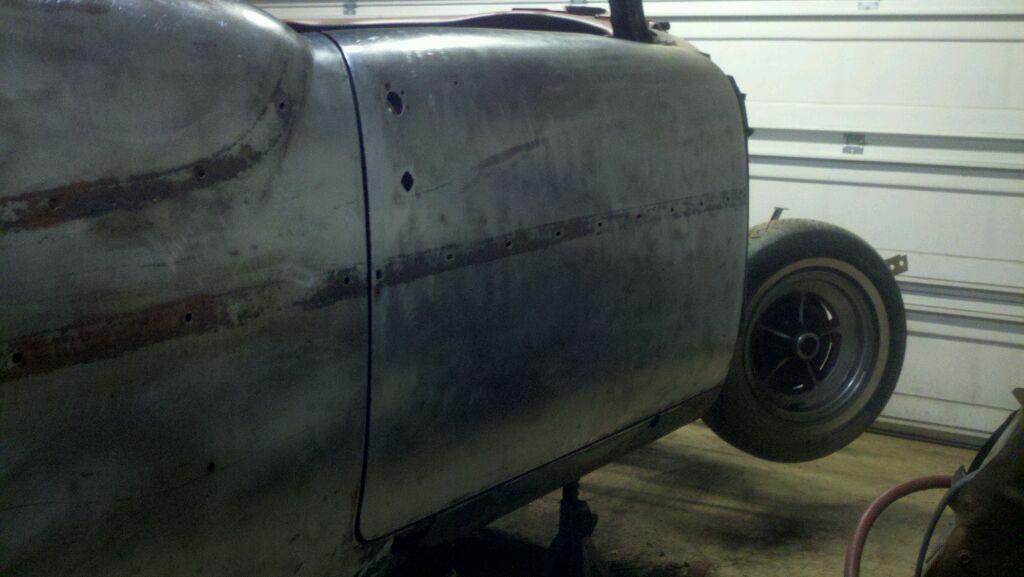

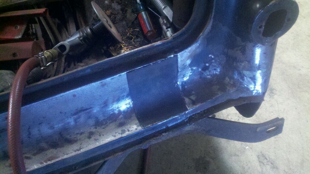

    This is all that's left of the front fender. I patched every rust hole in the body with the exception of the rocker panels and floor with this fender...and I didn't use it on the car because it was rotted bad on the bottom corner! The rest got put to good use. We are welding starting in about 30 minutes...soon as my slow ass brother gets here. Im super excited. The days of work spent cutting, shaping, filing, grinding will be put in for good. Pics to come.
