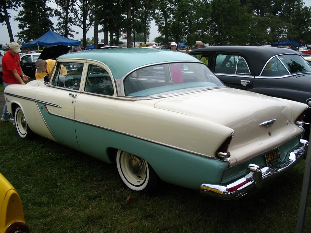

    Here is my intended victim. Notice her newly aquired V8 badges.
  15. Nice belvedere! My '56 was a sedan, not a hardtop, but very similar. You're going to have a really bitchin' car when you get done. That thing's in awesome shape! :D

    We were looking for a '56 when we found this '55. It is in really nice shape, I almost feel bad about cutting it up, almost :D.

    The car will be painted like the one in the pic below and it will sport the stock hub caps on widdened steel wheels.
