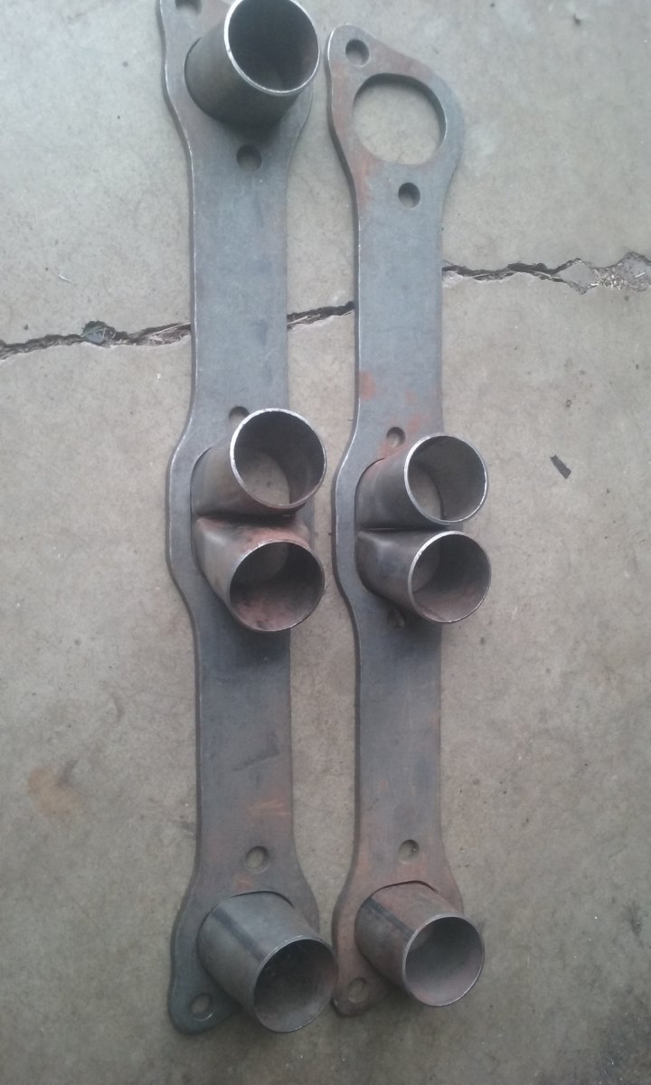

    Flanges are from hedman, these are matched to their step plate that allows larger tubes. Collectors and pipes from summit racing. My first tubes are 1 7/8 than go to 2". For some reason their 1 7/8 collectors were twice the price. You would be fine with 1 3/4 or get the speedway fat fenderwell 1 5/8 headers and cut them up to fit a pontiac.
    I have an old set of flanges with stubs , missing 1 stub that would work for you

    Kinda was thinking 1 7/8th as I don't want to have to make another set later. Maybe I should go the inexpensive route on the first set????
    I'll get with you on the flanges but it sure helps to see a set mocked up before starting.

    With your combo 1 7/8 is too big imo. Could lose some backpressure and power. I'm running mid 11's with just 1 5/8. the one missing is an end so shouldn't be hard to shape a pipe in. My initial outlet pipes were long u's I cut in half to save cost. 20160228_131155.jpg

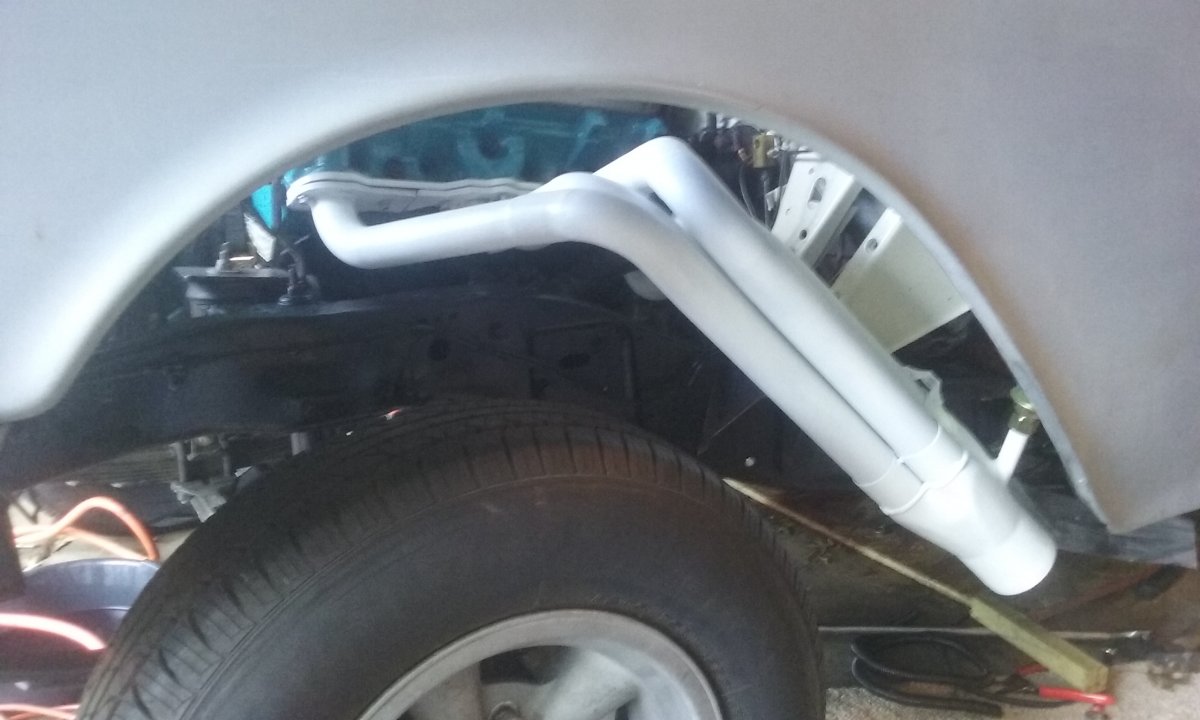

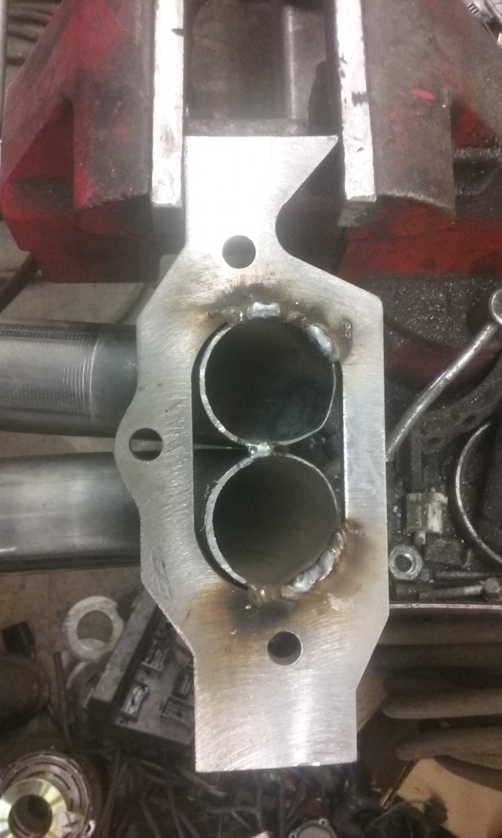

    Headers are getting closer, had to reshape the center tubes. Than I'll grind it all down and run a belt sander over to make sure it's all flat. 20160309_165100.jpg 20160309_181137.jpg

    The Hedman header flange is 10175, comes with a set of gaskets and bolts to bolt to step plate, without stubs
    wrong pic in add , I bought the step plates used so you would have to contact Hedman for those

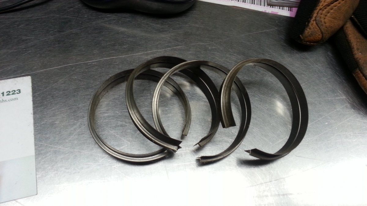

    Not to say you will be building another set of headers soon but if you are you may want to get some of these tube alignment sleeves. 20160310_083656.jpg

    I cannot recommend these enough!
    I don't honestly know how I got by before a mentor threw a bag of these at me.
    Traditional?

    I've never seen those before. Most of the tubes only have 1 joint and that's where it's stepped to a larger tube .

    .....nice job on the headers,...but how you gonna remove the driver's side to finish weld em?

    Yea I got ahead of myself a little. Removed the back tube, cut the header flanges up and reset it back up and retacked the back one.
