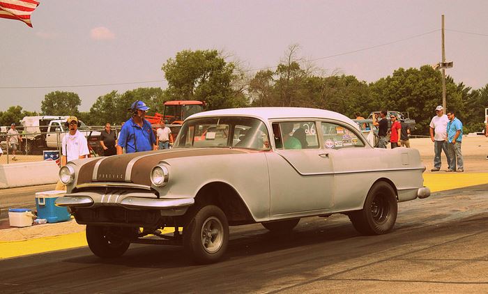

    I have a few updates and a few pics with the "new" front wheels (ET II) , got the engine back together over the winter and up and running again. A little bigger cam & torque converter. Getting the 60 ft's down to 1.66 and working out the tune for the new combo. I went to the local track for the nostalgic race and got invited to run with the Nostalgia G***ers group. Looking forward to running with those guys more once I get a few more things done and straightened out. http://www.nostalgiag***ers.com/

  10. OahuEli
    Joined: Dec 27, 2008
    Posts: 5,243
    OahuEli
    from Hawaii
    Your car looks good man. What E.T.s do you expect?

  12. 55chieftain
    Joined: May 29, 2007
    Posts: 2,197
    55chieftain
    Looking to get to lower 11's, maybe just mid 11's with my weight. At least with these heads, a nice set of alum dports would/should get me in the 10's.

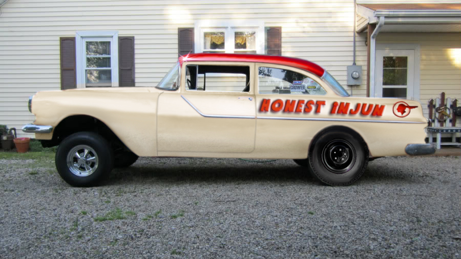

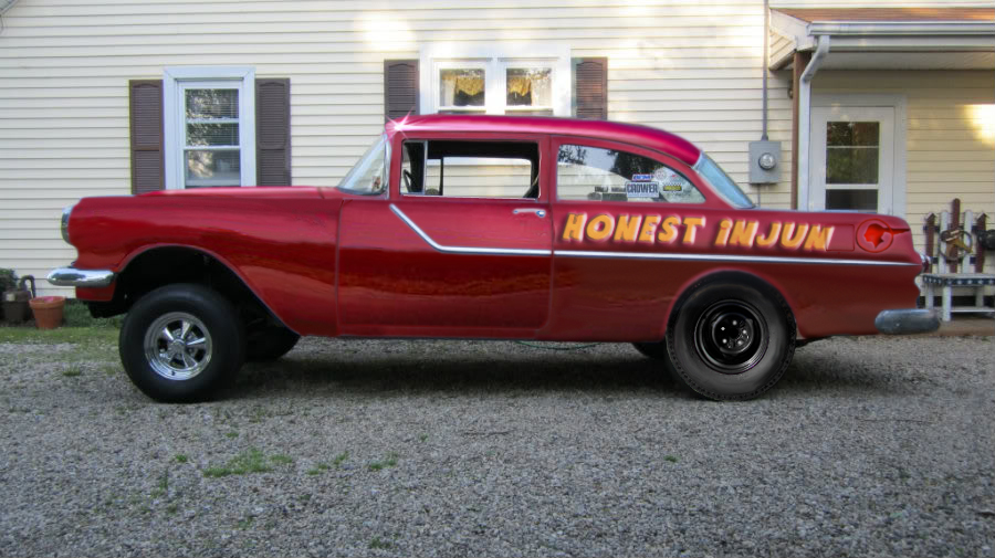

    Thanks for the comments, ended up running a best for now 7.50 in the 1/8 which is a 11.70 1/4 mile. I have 1 more race left before i'm done for the year.
    I had a couple renditions done for my car in the photoshop thread i'm considering , thanks to themoose.

    56PonchoWagon
    from El Paso TX
    Definitely liking that top color scheme
  20. bobwop
    Joined: Jan 13, 2008
    Posts: 6,136
    bobwop
    from Arley, AL
    I prefer the lower color scheme. One color suits a two door post in my opinion
  21. cgaswillys
    Joined: Oct 5, 2008
    Posts: 1,076
    cgaswillys
    from New Jersey
    Top one looks better. White with a red flake roof would look cool.
  22. 55chieftain
    Posts: 2,197
    55chieftain
    With the way my body work is I may have to opt for the lighter color. It's not a show car by any means.

  25. loudbang
    Posts: 40,347
    One more for the bottom choice all red one.
  26. Rusty Heaps
    Joined: May 19, 2011
    Posts: 1,005
    Rusty Heaps
    I vote for the red also. The only criticism I have is that I would have tubbed it instead of cutting quarter panels. I have wanted to go that route on my '55 Chieftain.

  29. How about red/cream/red?
  30. 55chieftain
    Posts: 2,197
    55chieftain
    Still undecided, might just leave the roof white and lower candy apple red or whatever. Right now just looking forward to doing some more racing this weekend.
