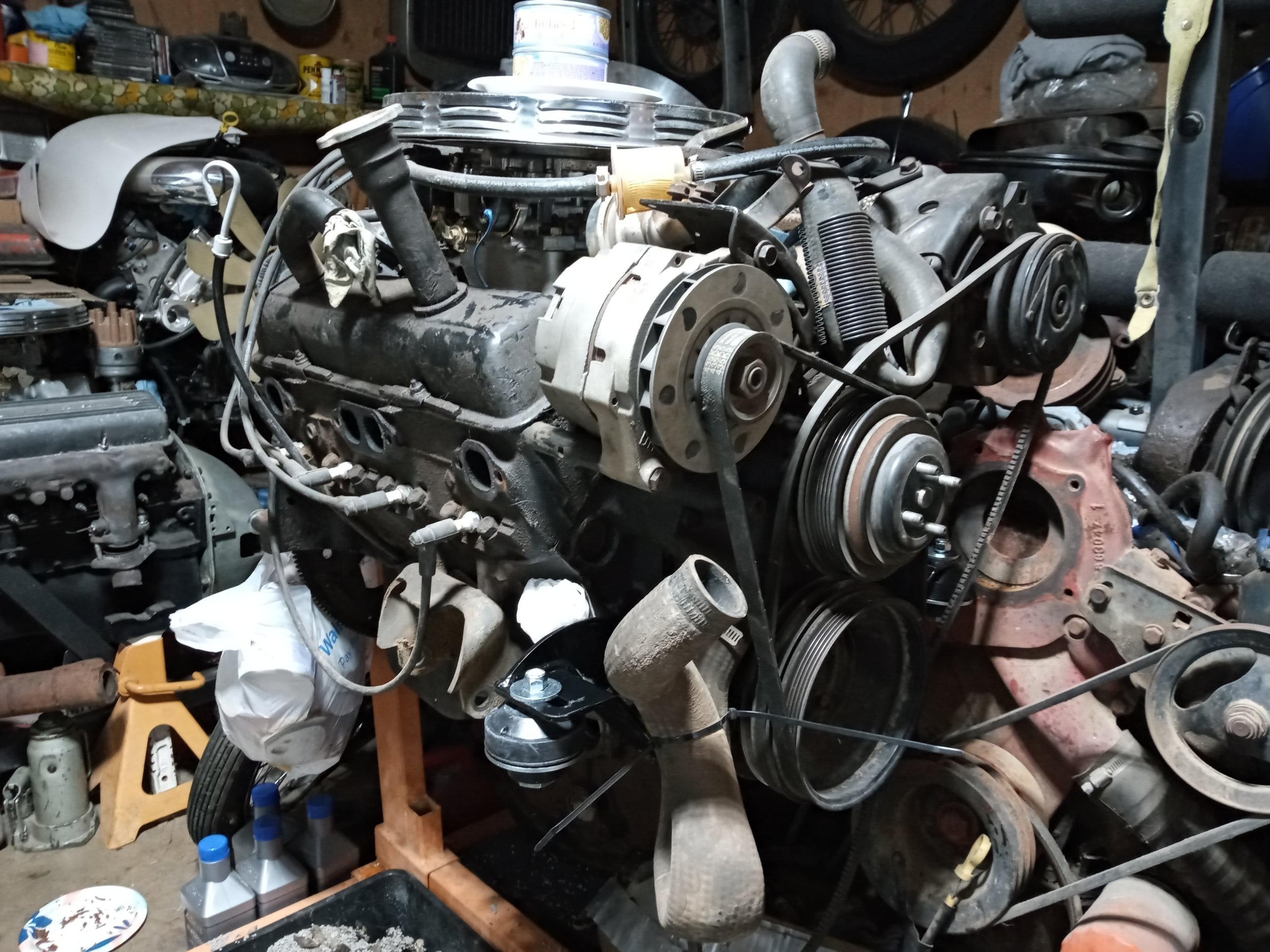

    The biscuit wouldn't even fit on the bracket.

  3. Do you ever have one of those "Ah Ha! I'm such a dumbass" moments? Had one today.
    The C1 Corvette motor mount. It's perfect for what I want. Let's me keep the fuel pump AND an 8 inch harmonic balancer.
    Best part is that I have one with frame mounts. It's on...

  6. This is what I have:
    There's a guy who makes custom C1 Corvette engine mounts that takes the stress off of the water pump.
    Got into contact with him last night. If everything goes right, I should be getting a set from him in the near future.

  7. Jmountainjr
    Joined: Dec 29, 2006
    Posts: 1,868
    Jmountainjr
    The Hurst type engine mount uses a 1/4" or 3/8" spacer between the mount and block. You do not lose the fuel pump.

  8. You're wrong. I posted pictures in this thread. Go look at my pictures. There's not enough room for the motor mount.

    Looks like the solution. I’ve never owned a C1, just out of curiosity what were the rest of the engine/trans mounts?
  11. Mr48chev
    Joined: Dec 28, 2007
    Posts: 35,601
    Mr48chev
    The spots that the mounts bolt to on my 292 Six are offset and I bought the last pair of 292 mounts that Chassis Engineering Inc. sold before they sold out to Heidt's Plus I got them at a "we are getting rid of this stuff" price. I bought the Ford Biscuits for a 52 F-1 Ford for pocket change and they are no doubt Hencho de China. These don't have the right angle but it is a similar idea to what Ididntdoit960 showed.
