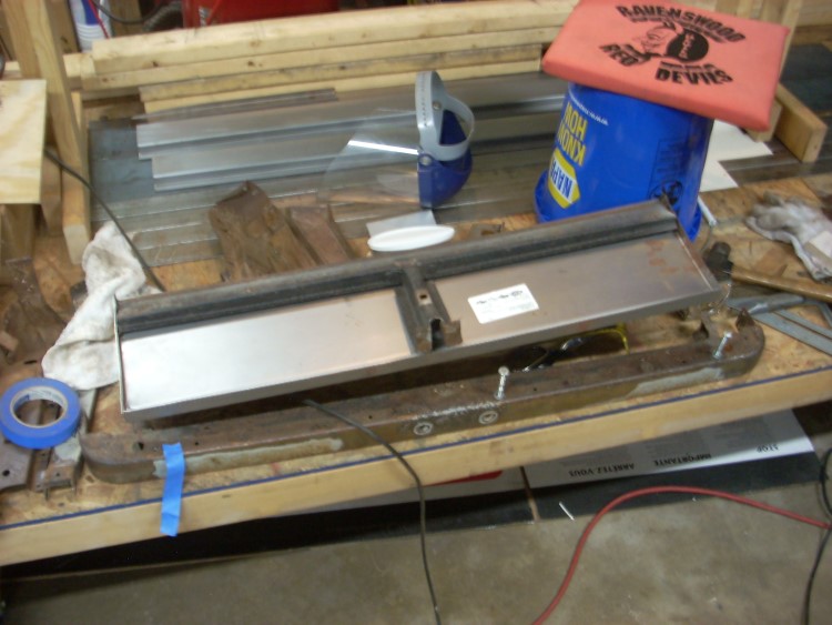

    on the fence about using this panel under the decklid pinholes everywhere some rot i cut out . i think its gonna be easier (time wise) to re skin and use the orig inner structure. I already chased some pin holes around while trying to weld them up .

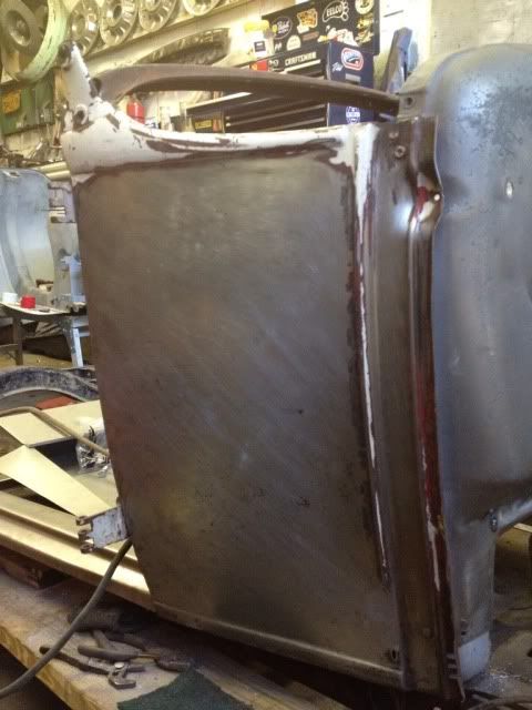

    put a door on
    next onto the triangle pieces onto the rear quarters
    and how much the repops are off compared to orig ones

    found some goodies at canfield today .
    an older repop panel for below the decklid . not anyway like the ones they sell now
    i put Jeffs orig inners in it and i think this ones gonna fit like a glove!!
    no weird twists or turns and an even gap on the bottom of the subrail im excited!1

    made the inner bracing today for the panel under the decklid
    nows its looking like something !! ordered the new brackets that go behind the door pillar from brookville
    a nice fit !!
    and the door fits well

    well i put a door skin on the passenger side today as it would save about 6 hours of work total in the end betwen metal work and body work .
    turns out jeff had a badly bent hinge as well if you notice the gap
    notice the gap after a little work with a big pair of channel locks
    i couldn't be happier with this roadster and the way its fitting together like a jig saw puzzle .
