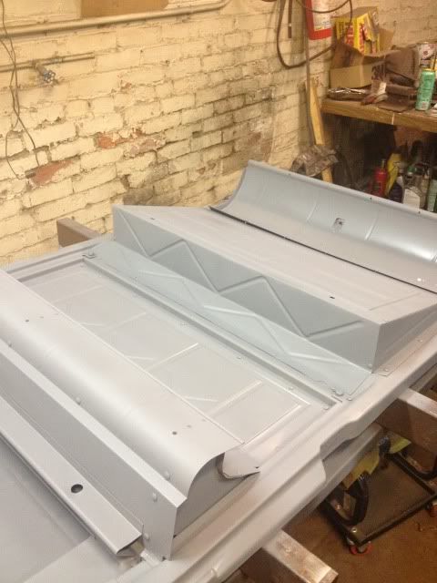

    well the subframe is pretty much finished up ...minus a few brackets ... thats next !!:):)
    well i got ahold of a nice henry bracket that rivets to the curved panel and bolts through the spare tire holder!
    sometimes you have to use some odd pieces to align the panels !!
    and the curved piece in place with the bracket riveted on
    the whole deal !!

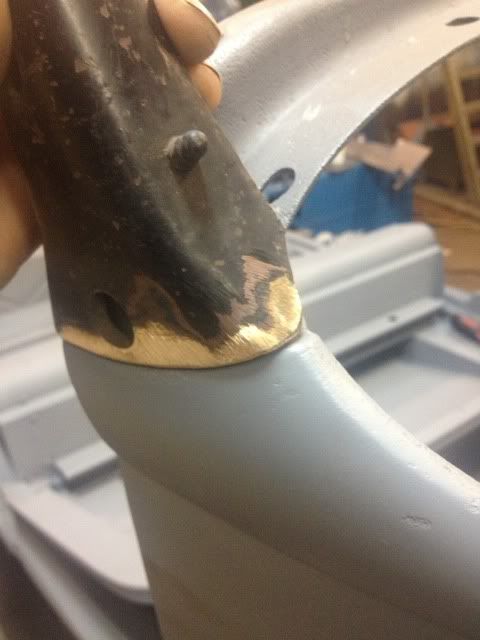

    stanchions gotta fit right ! kinda look sloppy here
    with a little work
    gaps gaps gaps

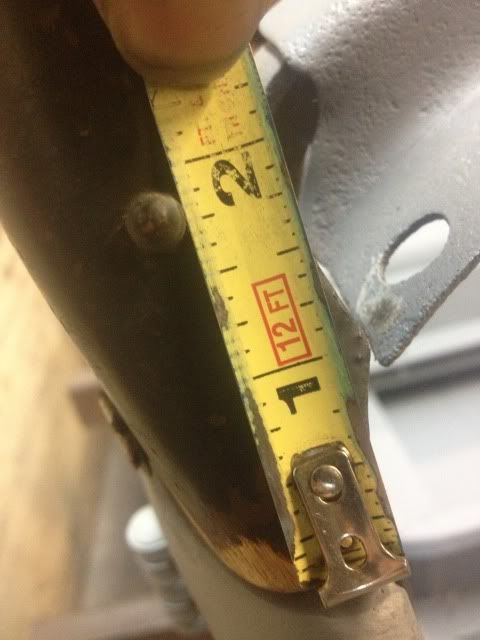

    brass stanchion?
    a little different compared to the steel one on the drivers side and seems to a little worse off in the fit dept .

    My old restorer buddy said he has often found both steel and brass substanchions on the same car over the years. Looks great man!
  17. 48fordnut
    Joined: Nov 4, 2005
    Posts: 4,215
    48fordnut
    I have one of each on a 31 cowl.Looks original,but who knows.

    thunderbird we are now looking for another steel stanchion. the brass one has a horrible fit . very weird .
    interesting 48ford!!

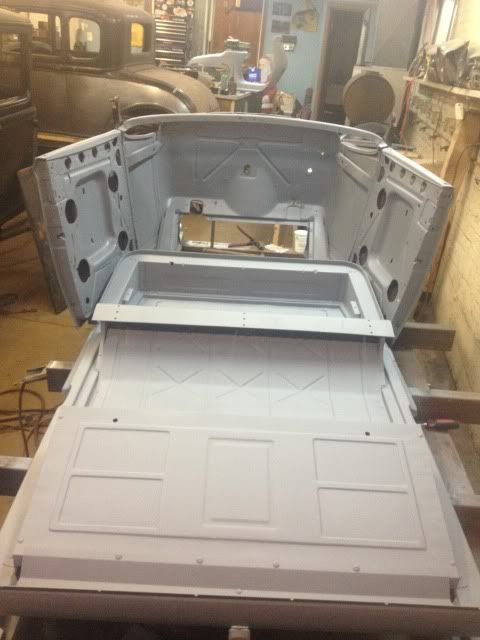

    well it took a little battling but it fit in its hole relatively well.
  25. Flop
    Joined: Jun 8, 2006
    Posts: 3,885
    Flop
    brooville ,brattons and 31ster here on the hamb came through with the parts!!
    getting everything lined up
    they are not the ovals ford had in them but they served their purpose. well at least the top and bottom holes
    dash rail . had a pretty big dent so that came back off
    curved panel with rumble stops installed
    package tray sitting in place . also borrowed some door handles to set the holes and d nuts!
    also faced the bolts to remove marking so they look more original .
    does anyone know why Henry used some square nuts and some regular nuts ? or some square nuts been replaced?
