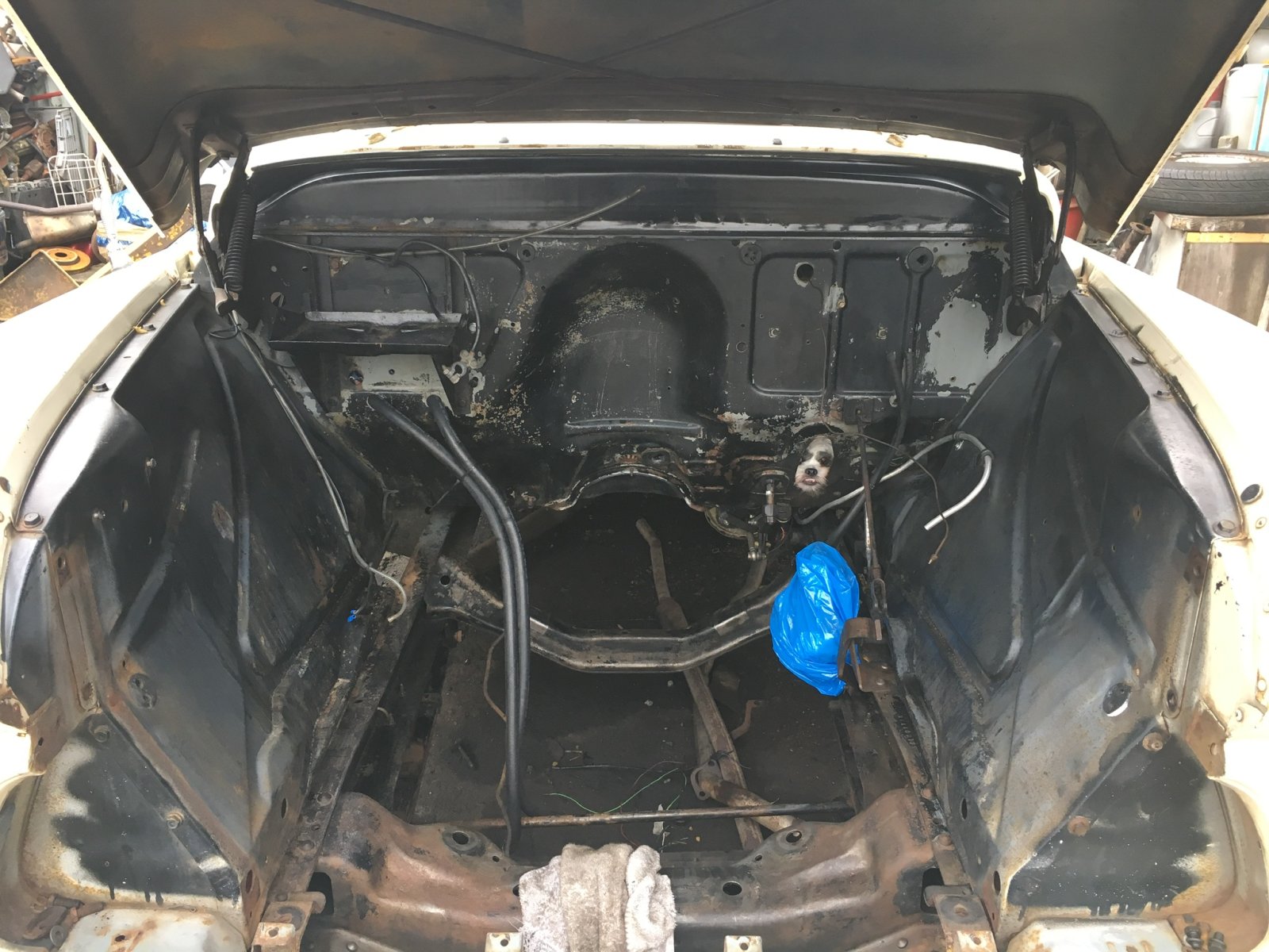

    And some pictures of the underside of the truck, where the steering linkage is, might be more helpful than pictures that don't show us anything on the steering or suspension systems.

    I didn't look at the picture very well. That model has independent front suspension, yes? If so, everything is adjustable via shims and elongated bolt holes, making things very easy to adjust. Check the rubber bushings on the control arms for deterioration and check for proper wheel bearing adjustment. That's pretty critical on some vehicles. If you have ball joints check them by placing a jack under the control arm and try to shake the wheels up and down and sideways. There should be no play. Sorry for the misinformation in my previous post. It is correct, however for earlier models with a straight front axle. I've also found that new steering boxes are often not in very good adjustment. You might check that. You want no more than an inch of free play at the steering wheel with the wheel centered on the high spot on the worm.

    If I took pictures of the steering setup you would just see stock 3100 components, with the exception of the CPP box.
