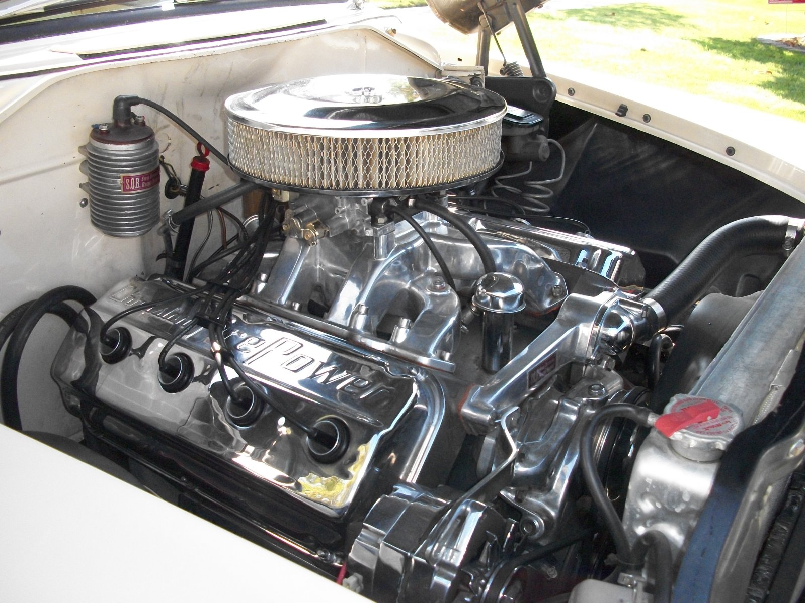

    Well that's just beautiful!!. From what I can see you have the aftermarket style water pump set-up. Could you tell me how far the pump and pulley sticks out from the block?

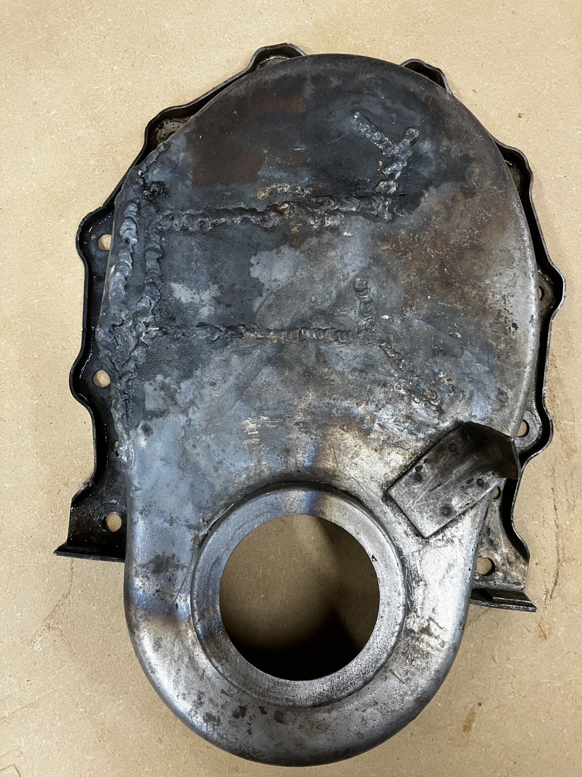

    I used the Chevy pump on my '54 331 (same as the 354) and modified the stock tin timing cover to fit. Built pretty stock except had to use Hot Heads pulleys 'cause mine didn't come with them and to fit the Chevy pump. I suggest using a remote oil filter connected to the engine with hoses. The old factory cartridge filter and can are old tech and hard to fit into a ch***is.

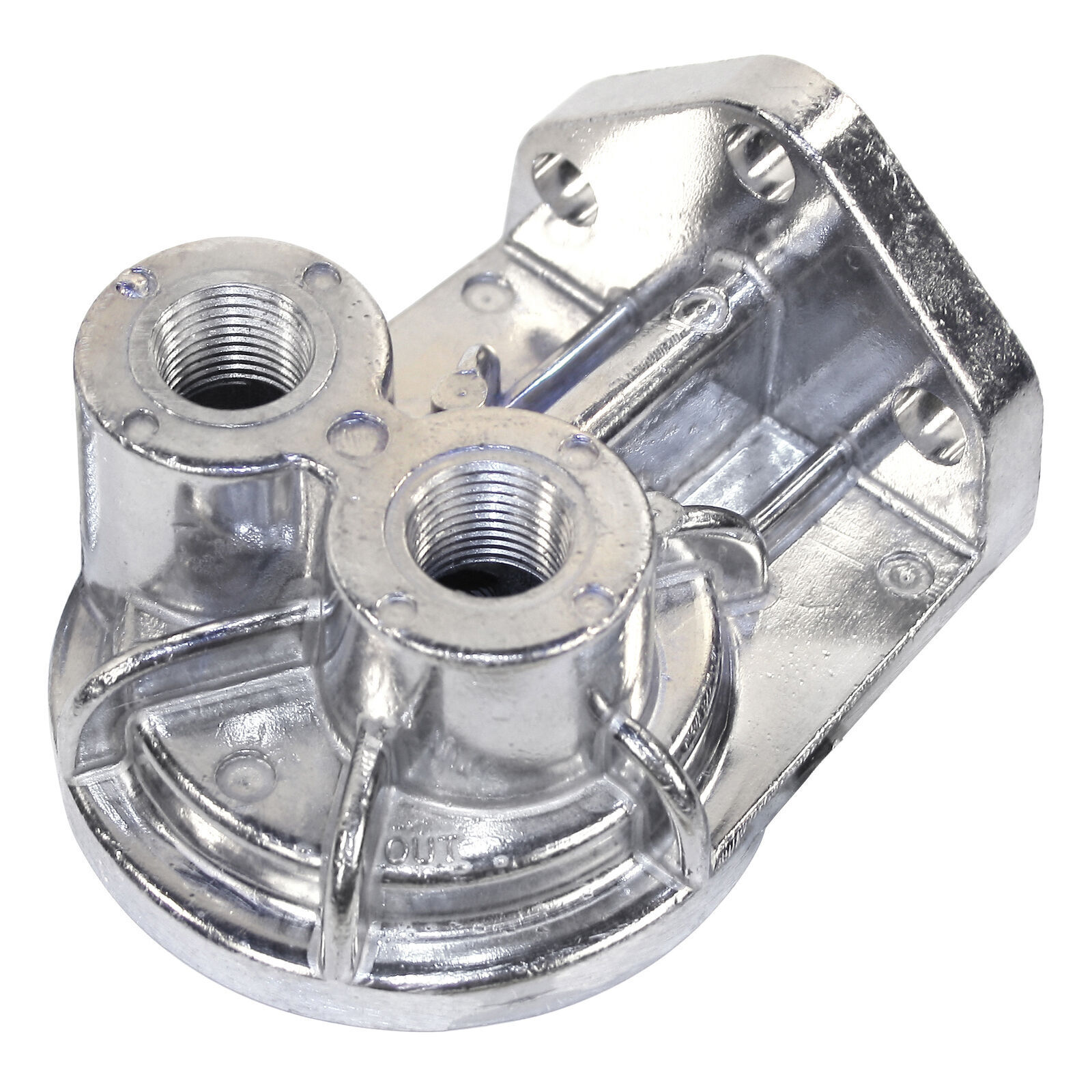

    Hot Heads has oil filter adaptors that don't involve hoses....
    Desoto291Hemi and Just Gary like this.

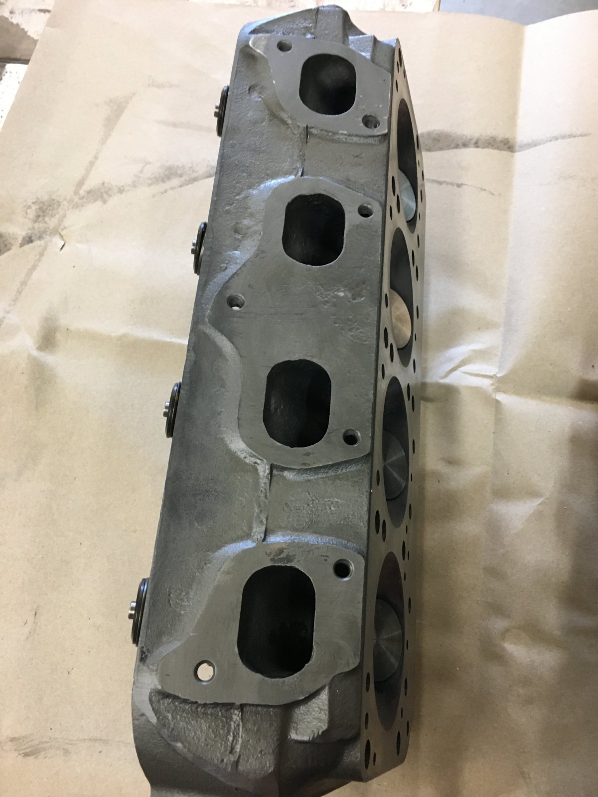

    Nice lookin' engine, but I'm afraid the statement "a '54 331 (same as the 354)" is not correct. I have a '54 331 out of a '54 New Yorker in my dirt modified and can tell you that a '54 originally had a "wet" manifold and no coolant "crossover". It may seem like "nit-picking" but I like to keep things straight.

    I don't use Hot Heads adaptors. I use adaptor plates and remote spin on fitting. That way I can put the filter in a much more convenient location.

    Strange. I know 331s up thru early '54 had no X-overs but all p***enger 354s and later 331s have them. Maybe you have a truck 354? They don't have X-overs but only have 2bbl manifolds and water manifold heat risers. In fact I put truck heads on my '52 long bell 331 for the big valves, big ports. Bored the 331 1/8" over and made it a 354. Trucks came with large diameter sodium fille exhaust valves too but that is fixed with new guides. Regardless there were variations as the changed model years but after mid '54 everything but trucks were X-over.
    Early 331 heads.
    No-X-over 354 truck heads
