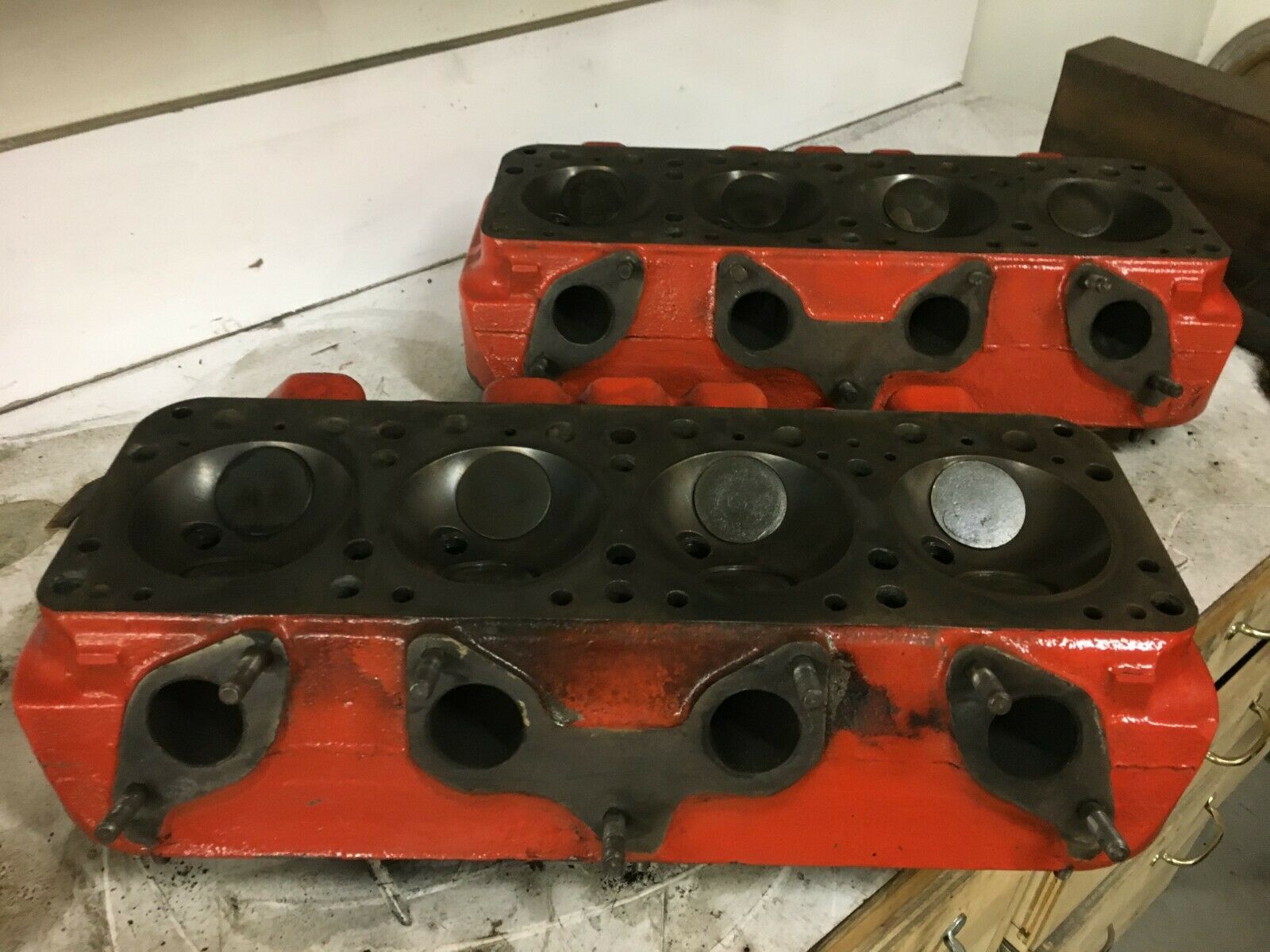

    truck heads are solid, car heads are solid through '54, 4 leg W/P on '55-56, crossover on 392s

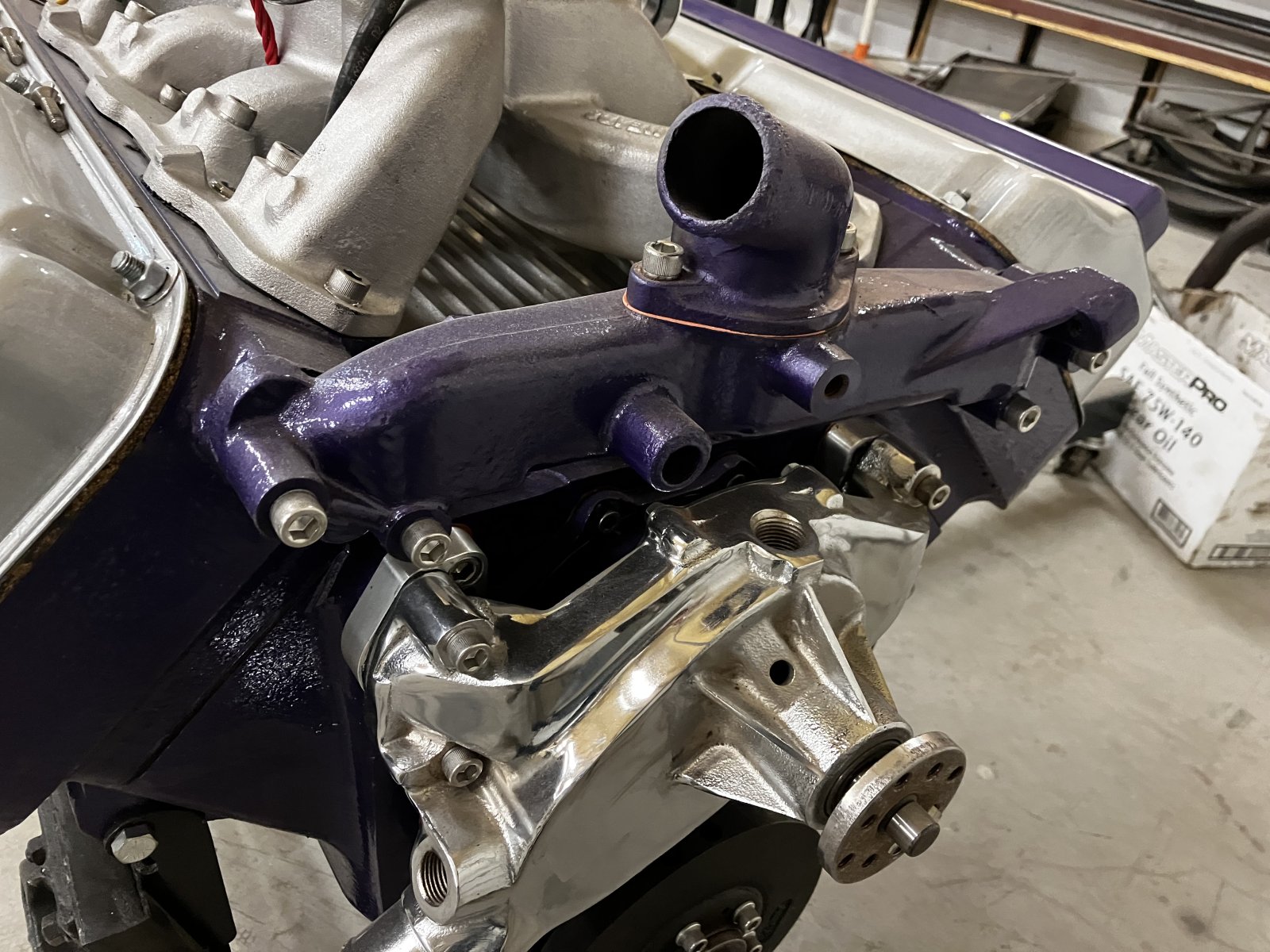

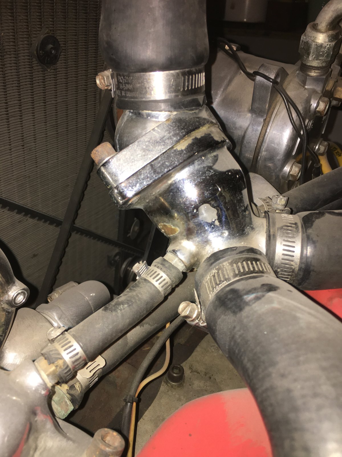

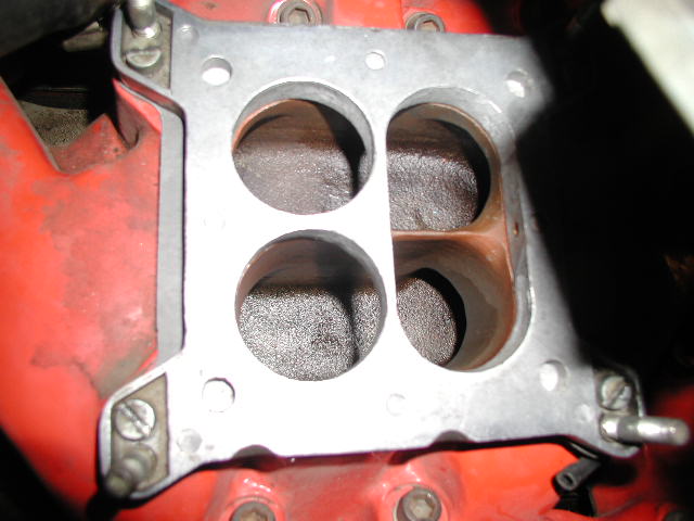

    Here's my late 54 331 Hemi with a wet manifold in my 51 Merc .Recently put an MSD distributor and edelbrock carb on it,not shown in this pic. Big difference on my stock motor. [​IMG]

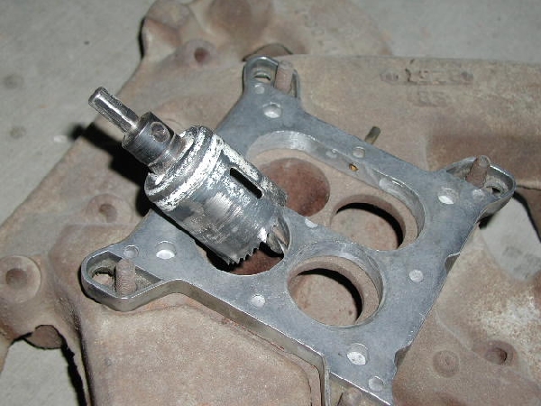

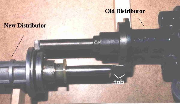

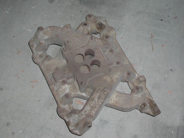

  9. willys36
    Joined: May 6, 2006
    Posts: 3,461
    willys36

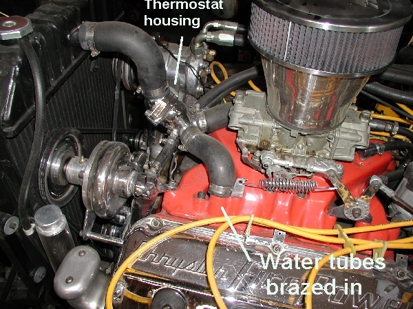

    Thanx for the info. That's a variation I never heard about. Except for truck heads, never heard of a wet 354. Incidentally that wet 4bbl manifold is worth the national debt!! I made my own for my 331 by brazing a couple pipe stubs in bored holes in a standard 354 manifold and welding up a thermostat housing.
    Also I adapted a 340 electronic distributor by welding a 1/4" long tab on the tip. Drops right in and have factory electronic ignition. I'm too cheap to buy the vendor stuff!

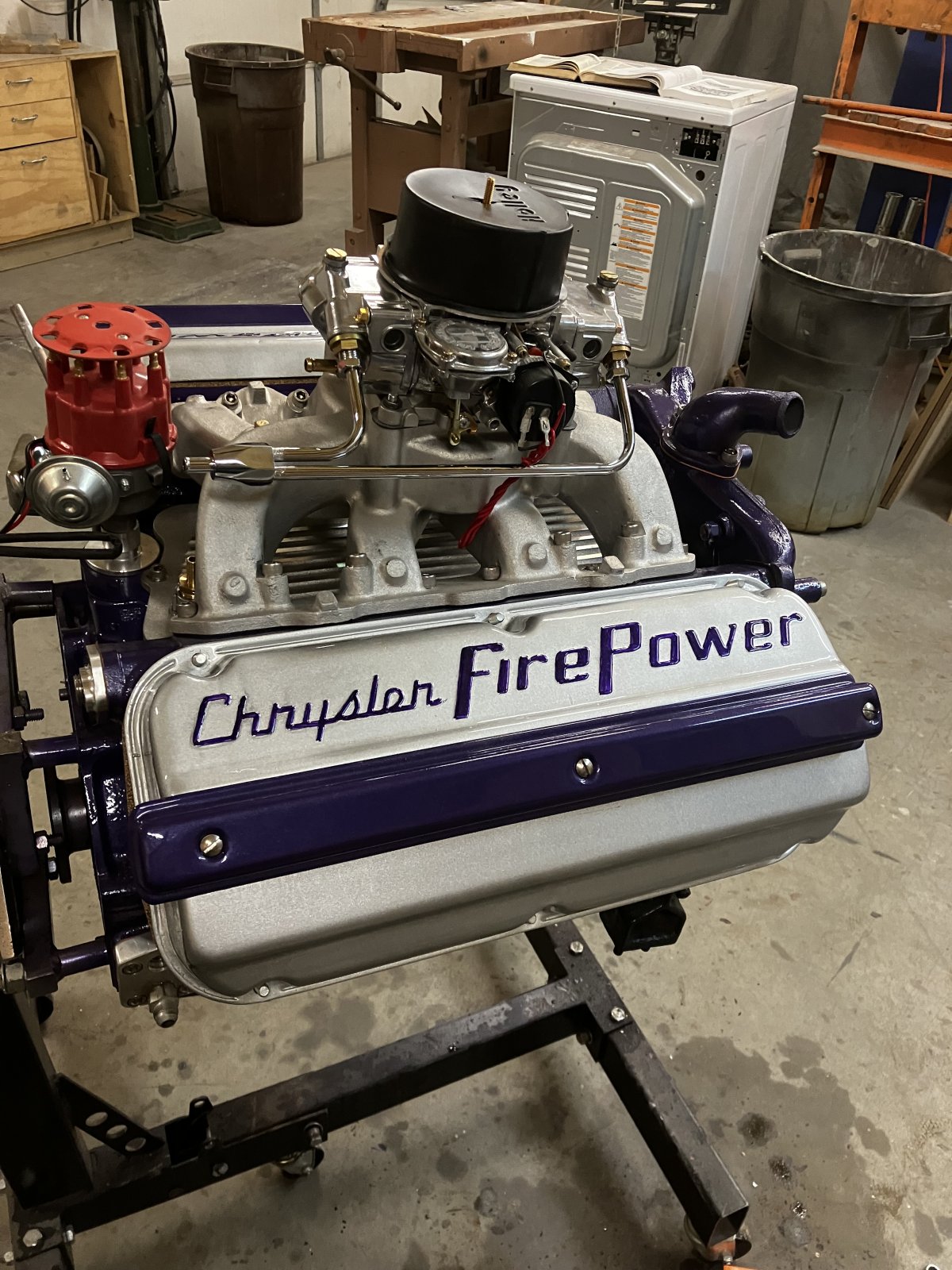

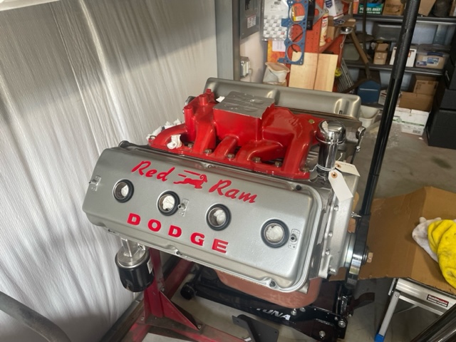

    I now have two GenI hemis. I’m finding them to be a good engine for early hot rods. One the lifter issue, I too have lifter clatter upon first fire up. Desoto 330.I’ve found that on some of the late model lifters their oil band doesn’t quite open up to the stock oil galley which delays the lifter fully pumping up. That’s just a theory of mine. I have a set of original OE lifters I plan on using.
    The motor pictured is a Dodge 241. It has higher compression due to new pistons Gary got me. I also had the valve train converted to adjustable. I don’t have interference issues in that the adjustment screws are short and I use a thick valve cover gasket.
