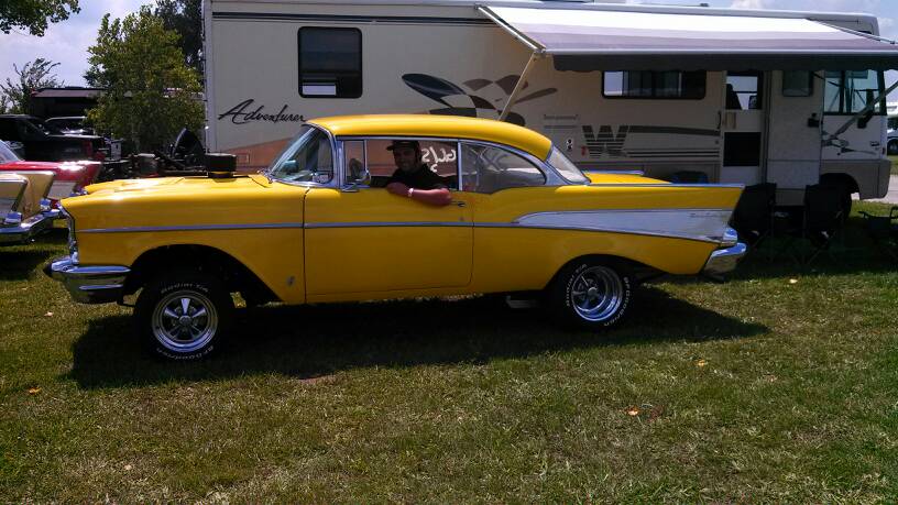

    Some pics from over the weekend![​IMG]

    SOOOO bad *** Joel! I can't wait to smoke your 55 over in person...

    Interesting side note i learned at the track two nights ago, my car is heavy as hell, 3585! Anyone have a fibergl*** front end for sale??.....
