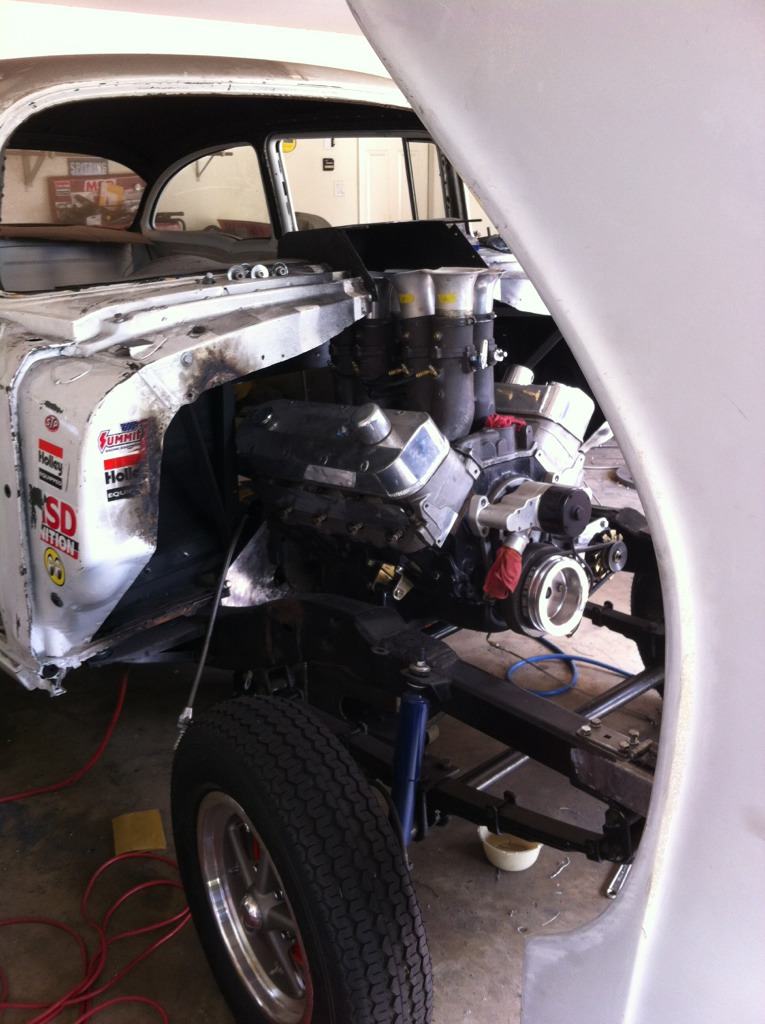

    Somehow when I installed the engine I managed to have it 1/2" higher on the drivers side. The injector stacks are so tall that small amount created a pretty ugly problem up top because it just did not line up in the scoop and it has been driving me quite batty.....seriously getting under my skin in a big way. Well, I finally had enough and today I fixed all that and am I ever happy that I did! I will sleep with a big ass smile on my face tonight.
    I realize all my pics look the same but it's what I have for now.
    P.s. if I were paying somebody $40/hour I would already have spent $10,000 in labor alone!
  9. Man that looks boss!!
    Ain't it a bitch when silly little things like that throw things out...glad you got it sorted though.
    I'm really digging this build, keep chipping away at it, your doing great
    Jay

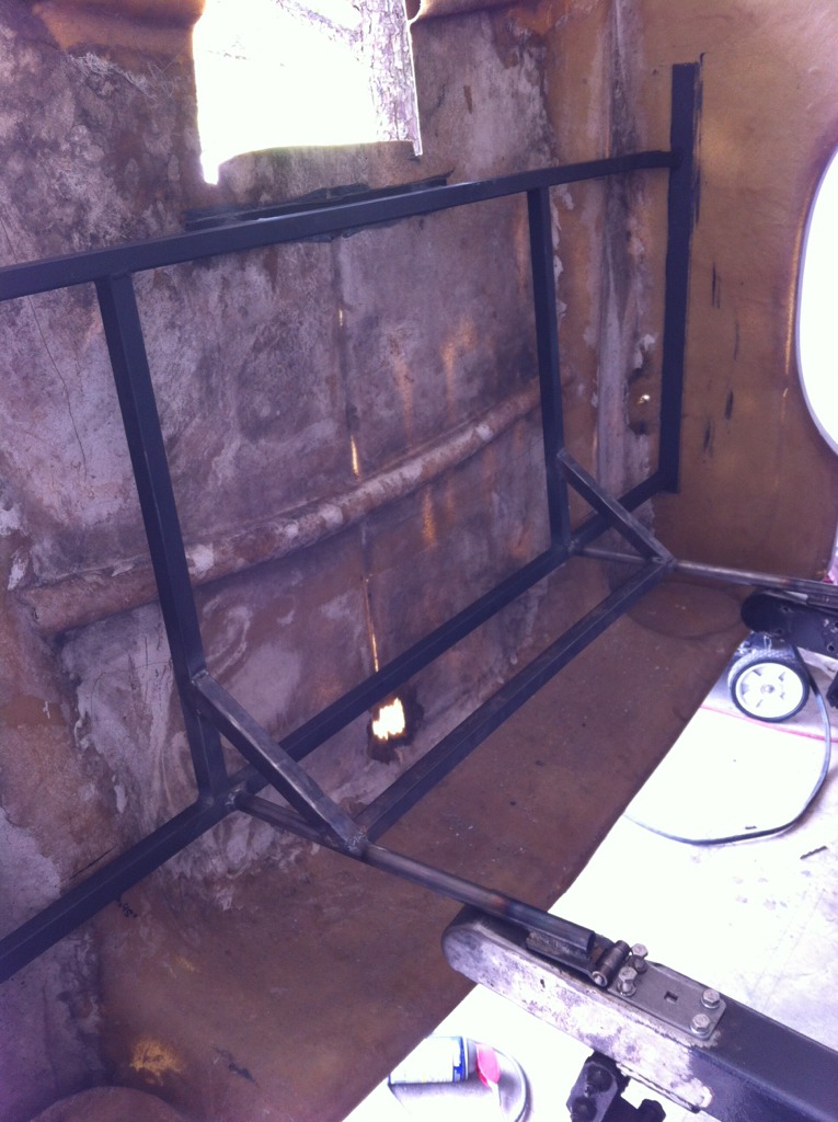

    Got the inner structure for the front clip mostly done today.
    Much more to it than it looks like. Have to brace it a smidge and build my swing bars but this is the meat of it.
  23. Bean Dip
    Joined: Dec 25, 2011
    Posts: 881
    Bean Dip
    Finally got my tilt over in place. The inner structure is 16 gauge 1" square tubing held in with 3m panel bond. Guess I should give credit where it's due...my son did all the work. Only charged me $40/hour.
    Total weight of front clip now is 54 lbs
