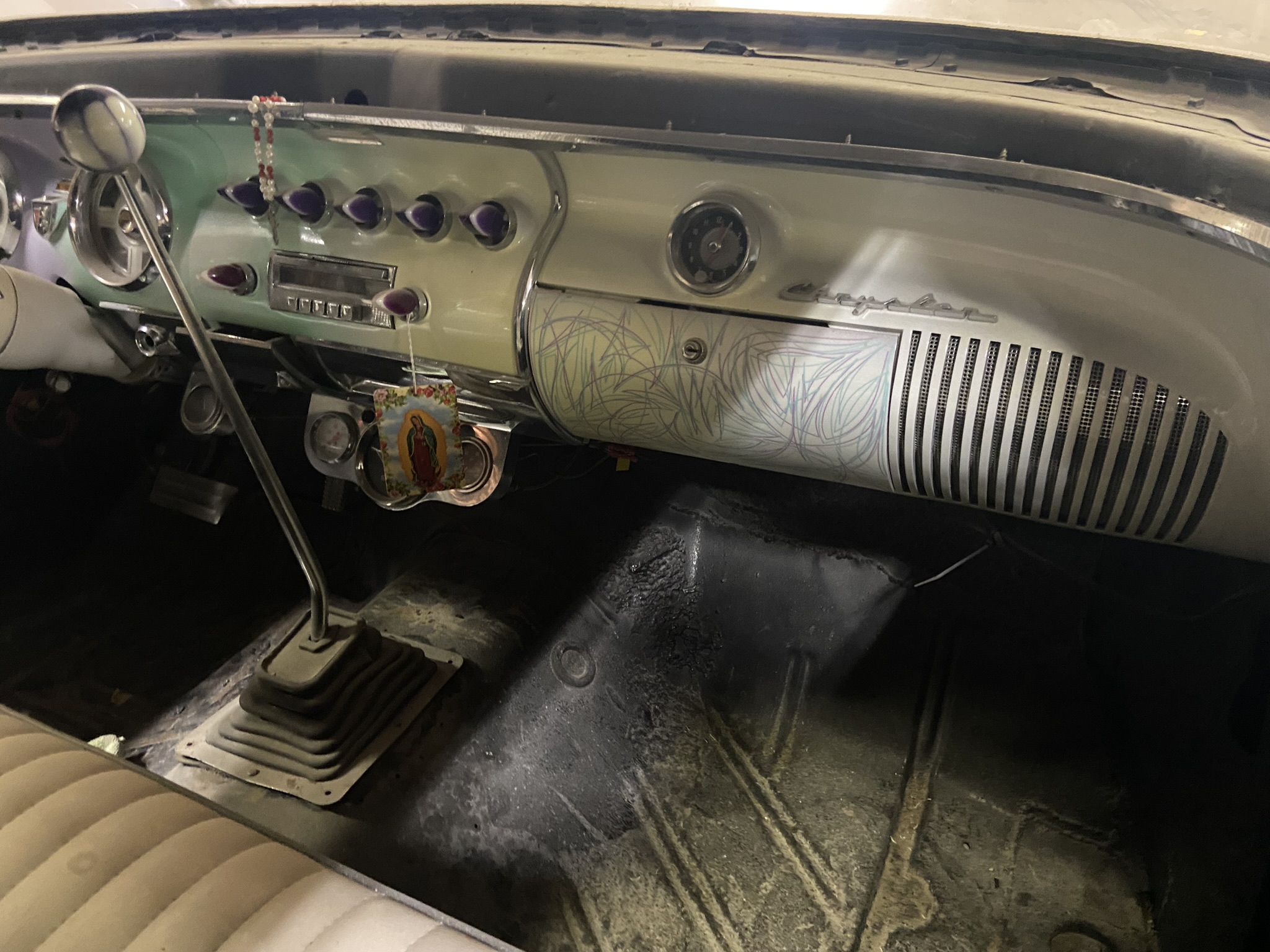

    I picked up some Kilmat and closed cell foam to roll out on the floor. I plan to change all the fluids this week and then roll this out on the floors after that.
    My car time is very limited right now as I'm wrapping up our new house I've spent the past 18 months building. We are moved in so it's small stuff, but time consuming.

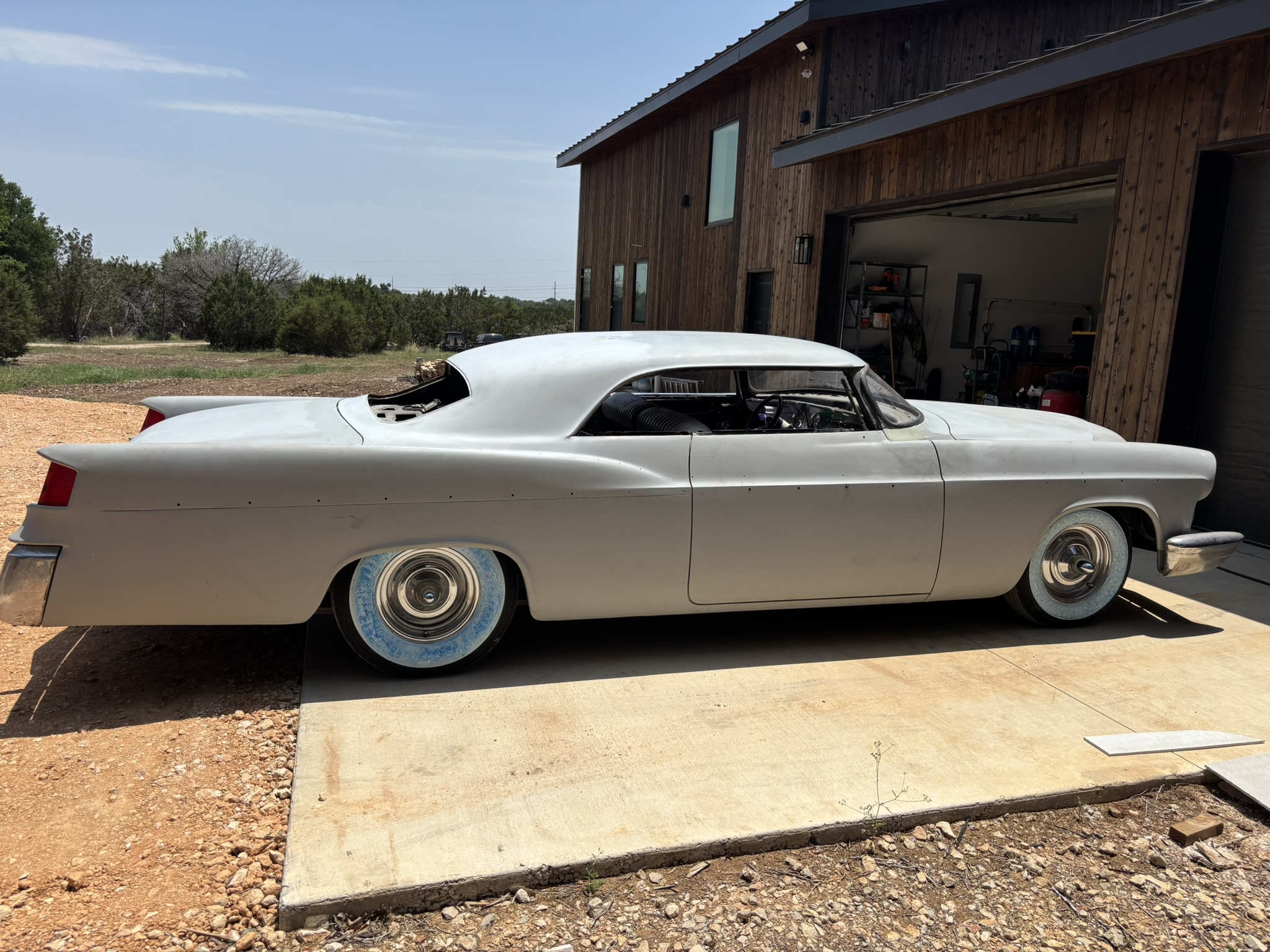

    Bummer Update – Sudden Overheating & Possible Bearing Issue
    Was cruising along Hwy 290 the other night when the car started sputtering around 2,800 RPM. I’ve had this happen before with a '62 Chevy truck after getting a bad tank of gas, so I gave it a little more throttle—but still sputtering.
    Checked the gauges. Oil pressure looked fine... then I saw the temp: 240°F! I dropped it into neutral, kicked on the electric fan, and coasted off the highway. Within 20 seconds, the temp dropped back down to 180°F. Engine still sounded normal, so I limped it the last two miles home and pulled it into the garage.
    Popped the hood—no boiling over. Checked the oil and noticed a slight brown tint with some fine sediment. Nothing burnt-smelling, just off. Next day, I changed the oil and checked the coolant—looked fine, good color and level.
    Fired it up and got a brief squeak for a few seconds, then it smoothed out. Let it warm up—ran great. Took it for a test drive, watching the temp gauge like a hawk. Took my eye off it for a couple miles and bam—back up to 240°F in no time. Fan was already on. Pulled over again, temp dropped fast, and drove it back home with no new noises.
    Today, I fired it up and the squeak noise was there, shut if off and started calling machine shops.
    At this point, I’m yanking the engine and tearing it down to see what’s going on. My gut says main bearing, but we’ll see. Got connected with Billy "Roach" Cockrell. Talked to him for over an hour and feel like I'm in good hands.
    Not what I was planning to work on, but that's the way it goes.

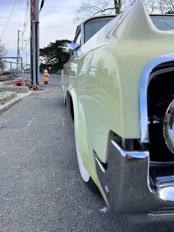

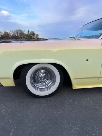

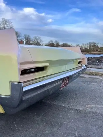

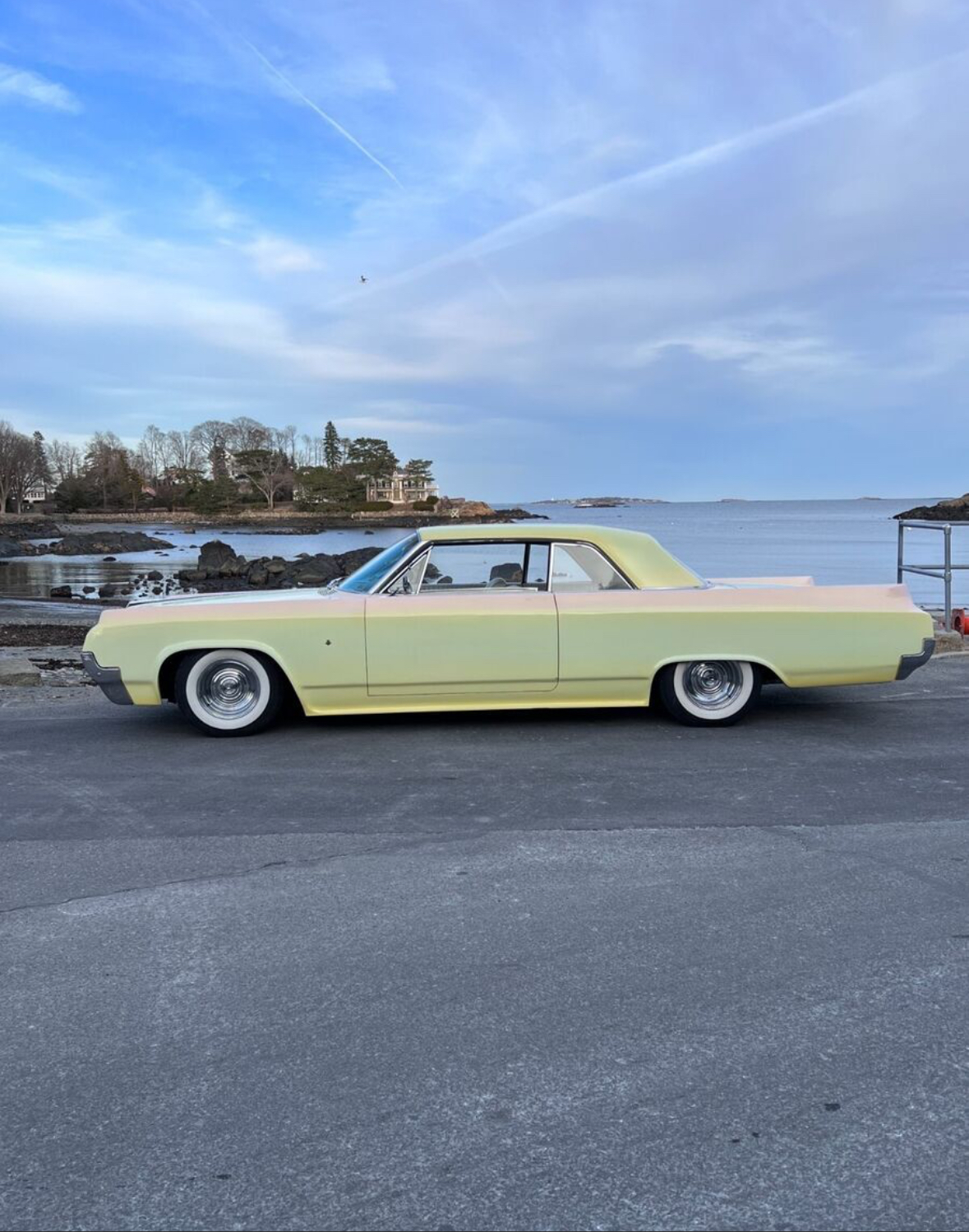

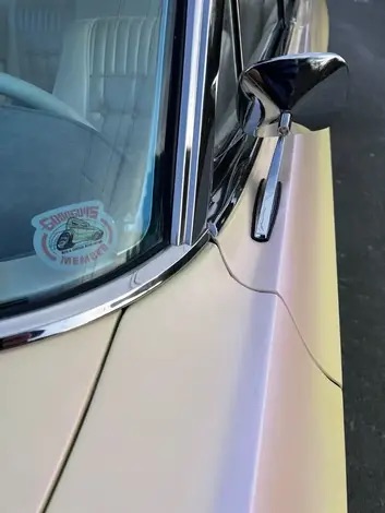

    I like these two blues together. Maybe add black in the spear between the chrome on the side. My wife thinks I should paint it black and white.
    I also like a fade similar to John and Franks old Oldsmobile
  30. mlagusis
    Joined: Oct 11, 2009
    Posts: 1,252
    mlagusis
    The dash was painted with a multi color fade 20 years ago. The original plan was for the car to be pearl white, then fade the space between the side chrome similar to the dash.
