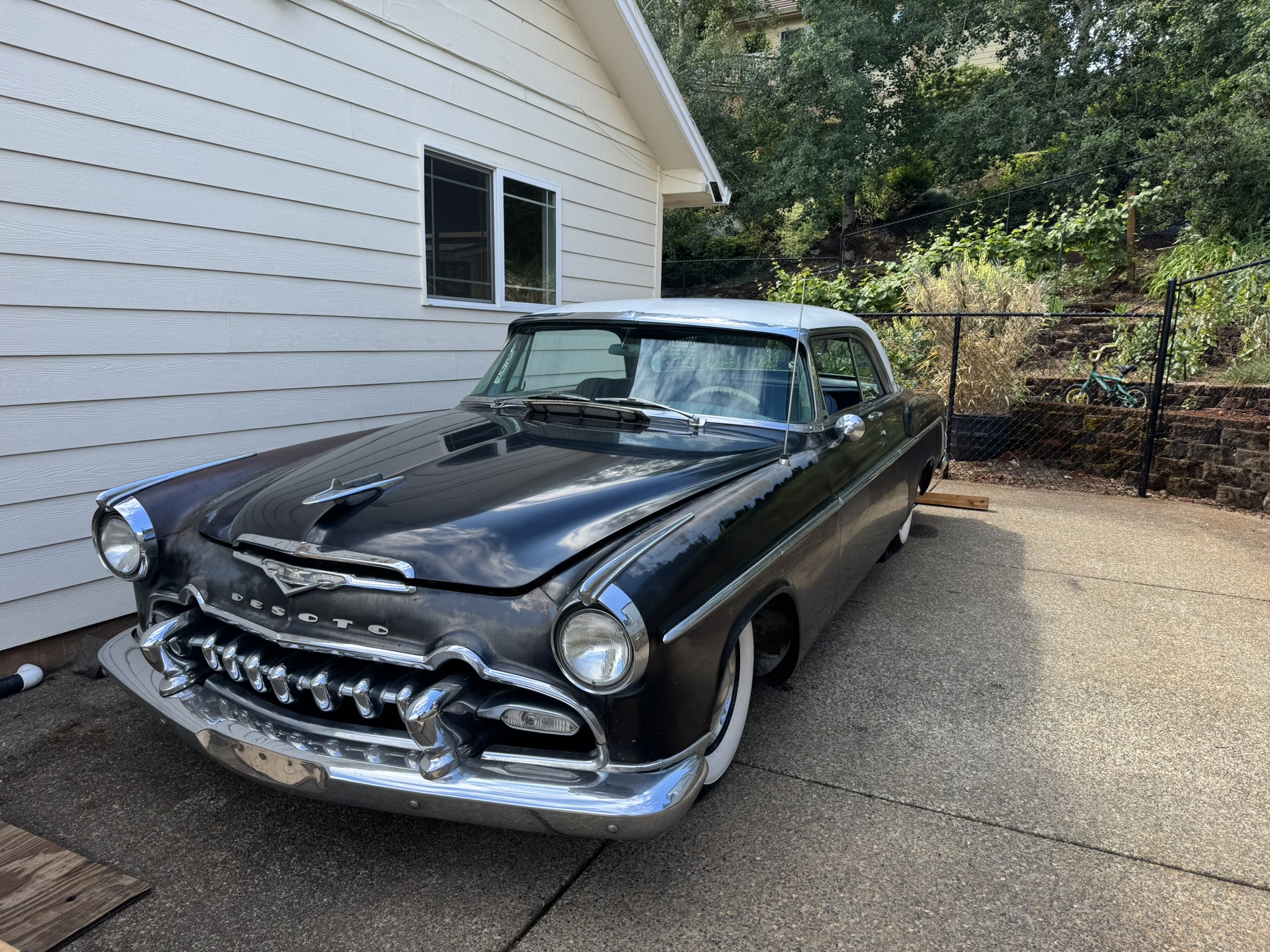

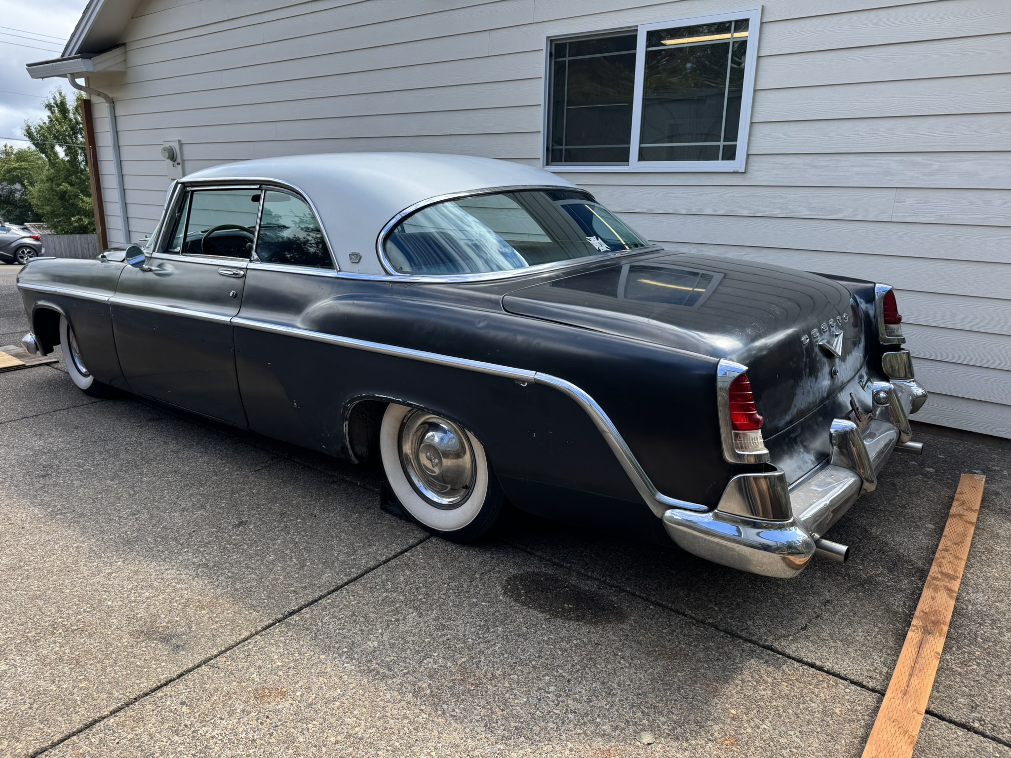

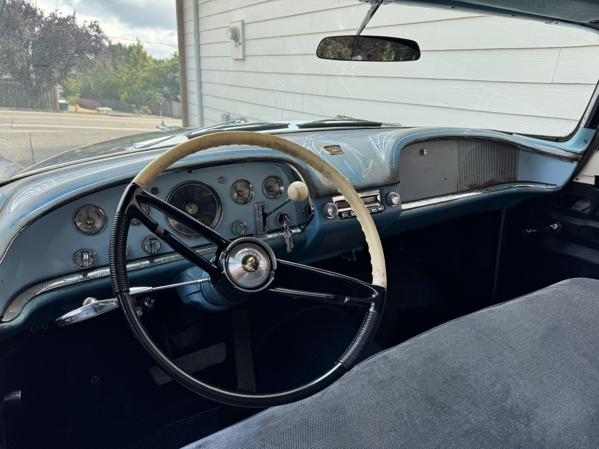

    Slightly off topic, but still related, my mom just picked up this Desoto over the weekend. It seems like a nice survivor. Runs and drives.

  18. guthriesmith
    Joined: Aug 17, 2006
    Posts: 11,940
    guthriesmith
    Something about “Mom just picked up this Desoto” is just too cool! :cool:
    Stogy, Uncle Ronn, Squablow and 7 others like this.
  19. mlagusis
    Joined: Oct 11, 2009
    Posts: 1,259
    mlagusis
    Yeah, my mom is a rare one. She enjoys old cars and helps my dad working in the garage. Growing up, we were always driving out to some random place to pick up some old car.
    My dad has a 34 Dodge truck that's finished and a 34 Studebaker project. The Desoto is here car. She plans to keep it as is and fix what ever breaks when it breaks.
    Stogy, Thor1, Lone Star Mopar and 6 others like this.

    Love it! All the custom touches are spot-on. Can’t wait to see this one in person. I’ve got a ‘57, also in Texas. :)
    Your mom’s Fireflite is outstanding too. Always loved the shifter on the dash on the ‘55 Mopars.

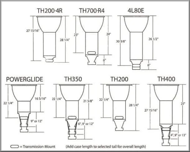

    While to engine is out, I plan to paint under the hood and freshen up the engine compartment. I am debating swapping out the transmission from a TH350 to a 700R4.
    Does anyone know if the trans swap will change the transmission mount locations and if I need to shorten or lengthen the driveshaft?
    Also, does anyone have suggestions on where to grab a new/rebuilt 700R4 from? I am looking around and it seems like $2,800 is the likely cost for this swap

    Joined: Dec 21, 2009
    Posts: 5,090
    rockable
    You will have to move the mounting point and if i remember correctly, you have to shorten the driveshaft just a tad.
    Stogy and mlagusis like this.

    mlagusis
    I wonder if the distance from the trans mount to the end of the transmission is the same between TH350 to 700R4. Or another way to say this, if I move the motor mounts forward and keep the transmission mounts in the same spot, if that would work. The motor has space to move forward a bit and since we put a Trans Am clip, the stock motor mounts on the frame were not used. I need to dig in and search for transmission dimensions and see what is the best option here
    Stogy and rockable like this.
  27. Gotgas
    Joined: Jul 22, 2004
    Posts: 7,252
    Gotgas
    from DFW USA
    "External dimensions of a 700R4 are the same as that of a THM350 with a 9-inch tail housing as found in the GMC long wheelbase truck/vans."
    If you have a typical short tail housing on your TH350, then you'd need to move the engine forward 3" to keep the end of the transmission in the same location. That is a LOT, and off the top of my head I can think of a lot of systems that might need to be modified (exhaust, wiring, cooling, steering, fuel, throttle, etc.).
    Reconfiguring the crossmember and shortening the driveshaft might be easier, but it's up to you.
    Stogy, HEMI32, Thor1 and 3 others like this.

    thanks for the info. A modified trans mount and driveshaft seem like the optimal path.
    Still debating the trans swap. It does have a rebuilt metric TH350 that works great and doesn’t leak. The 9” rear has 3.73 gears. I have not driven the car on the hi way yet. My brother took it to Santa Maria in 2012 and said it did fine cruising at 65mph
