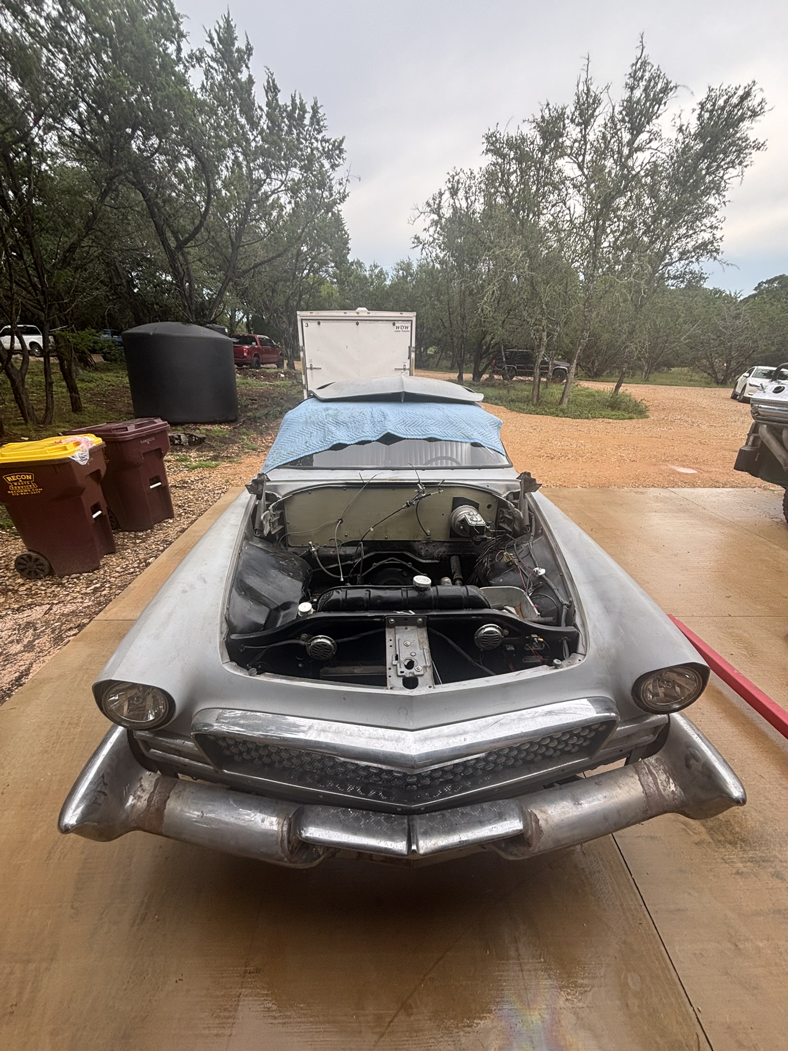

    Made a little progress today. Should have the motor pulled tomorrow and dropped off to Billy on Monday. Trying my best to make that happen. I’m heading to India Monday afternoon for work and will be gone for a couple of weeks.
    I was able to get everything disconnected today minus the transmission and wiring to the starter.

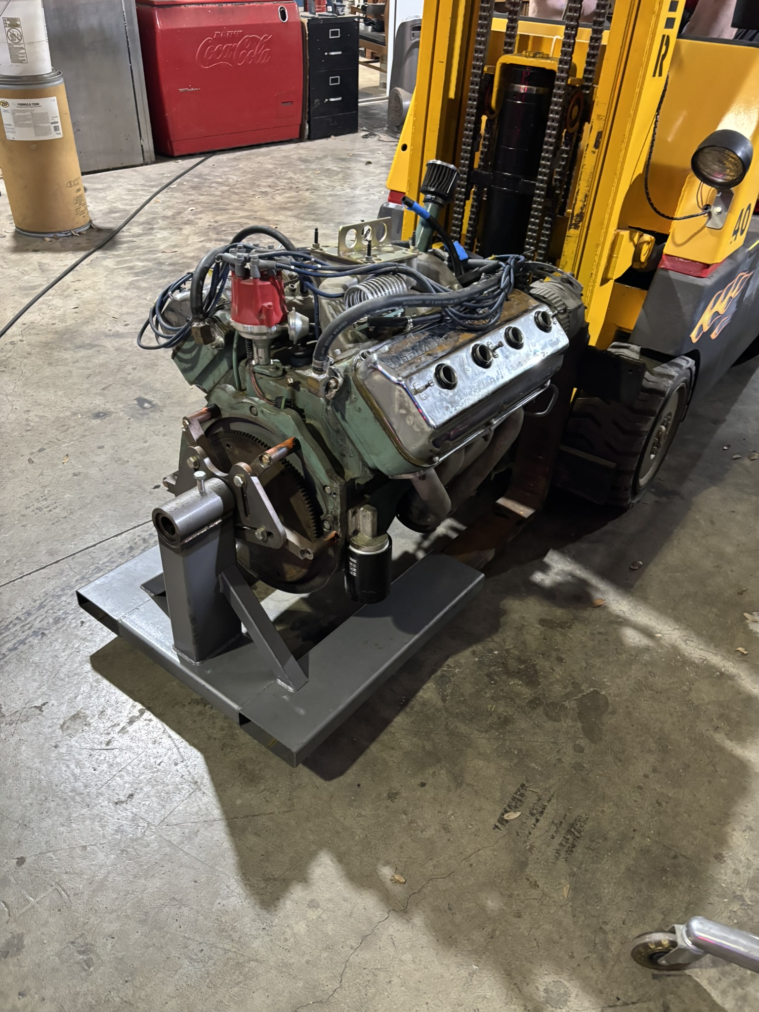

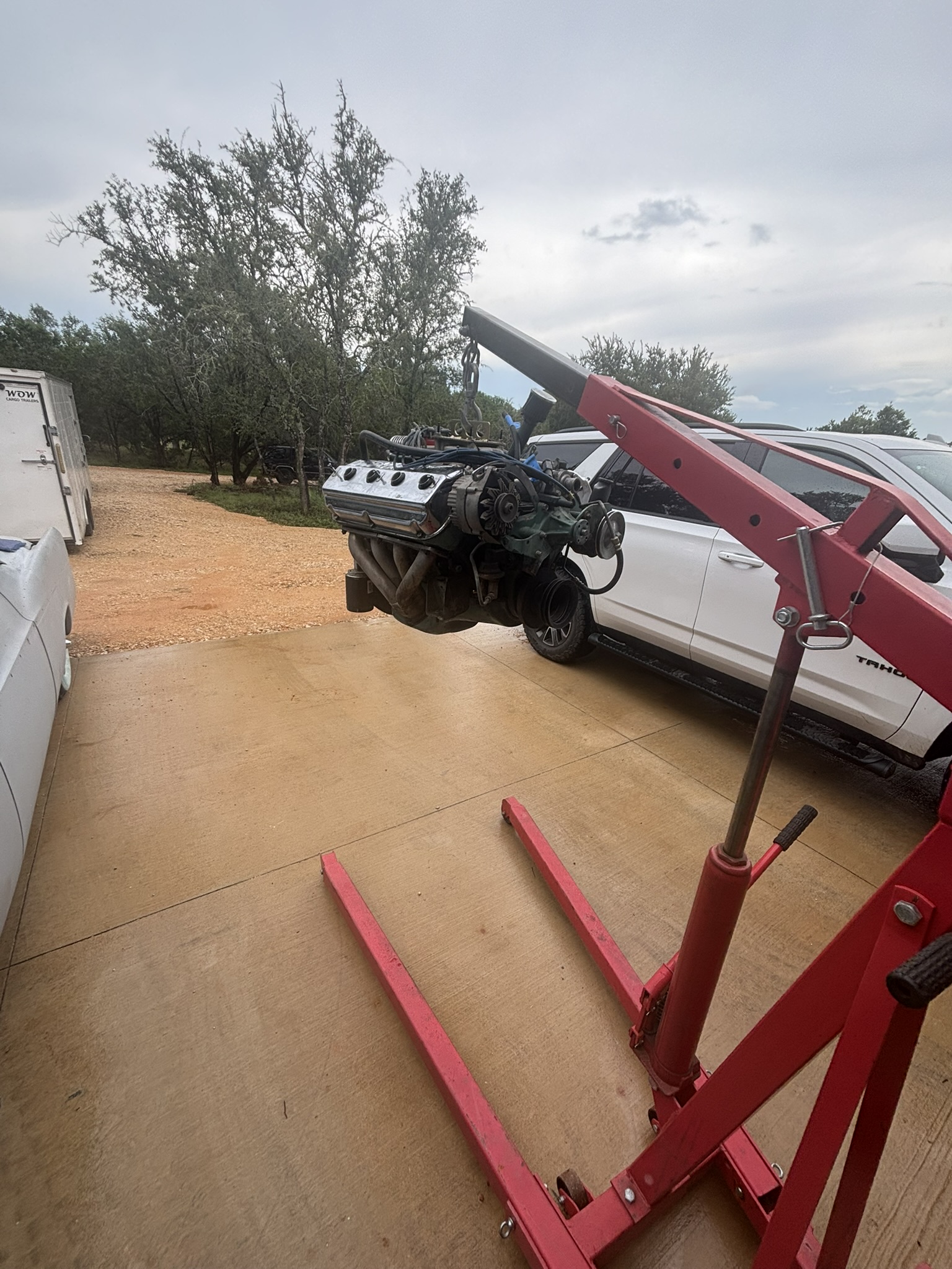

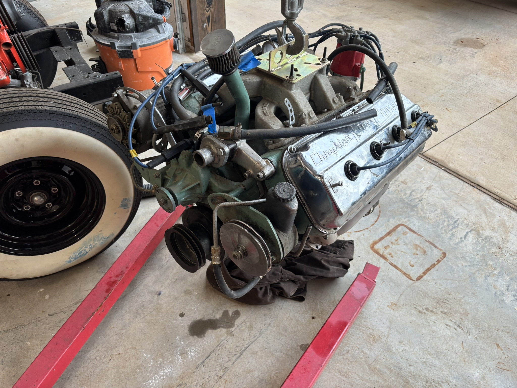

    Got the engine out and over to Billy's shop last night.
    I get back in town in a couple of weeks. Going to clean up the engine compartment and fix a few things like the plate behind the master cylinder and notch the cross member to get more clearance for the headers. Also, just an overall refresh with paint and paint under the hood while it's off.

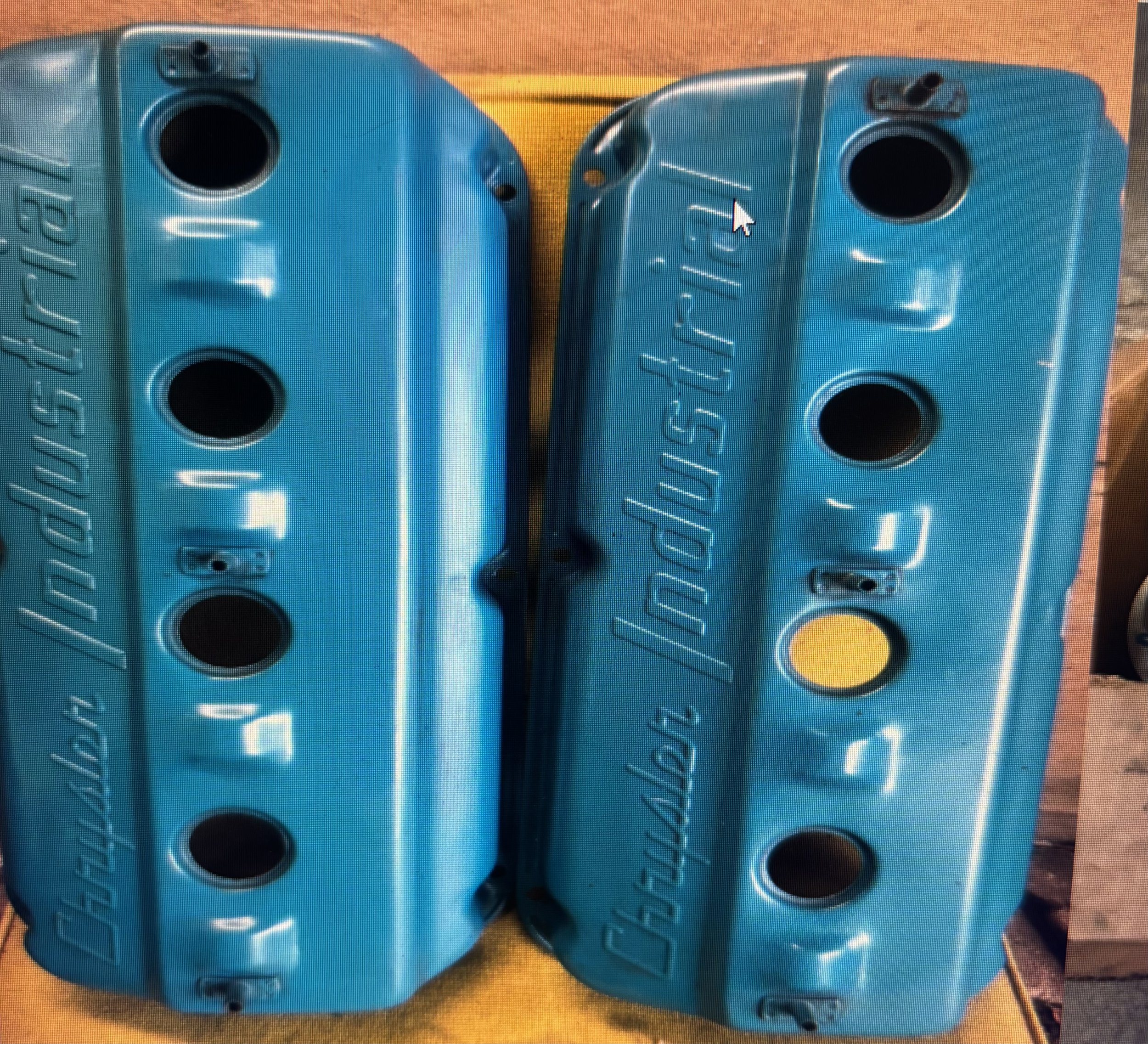

    Planning to paint the engine black, keep the intake bare aluminum and polish the rocker covers. What do you guys think? The blue:green they used in Chrysler Marine hemi’s is cool too

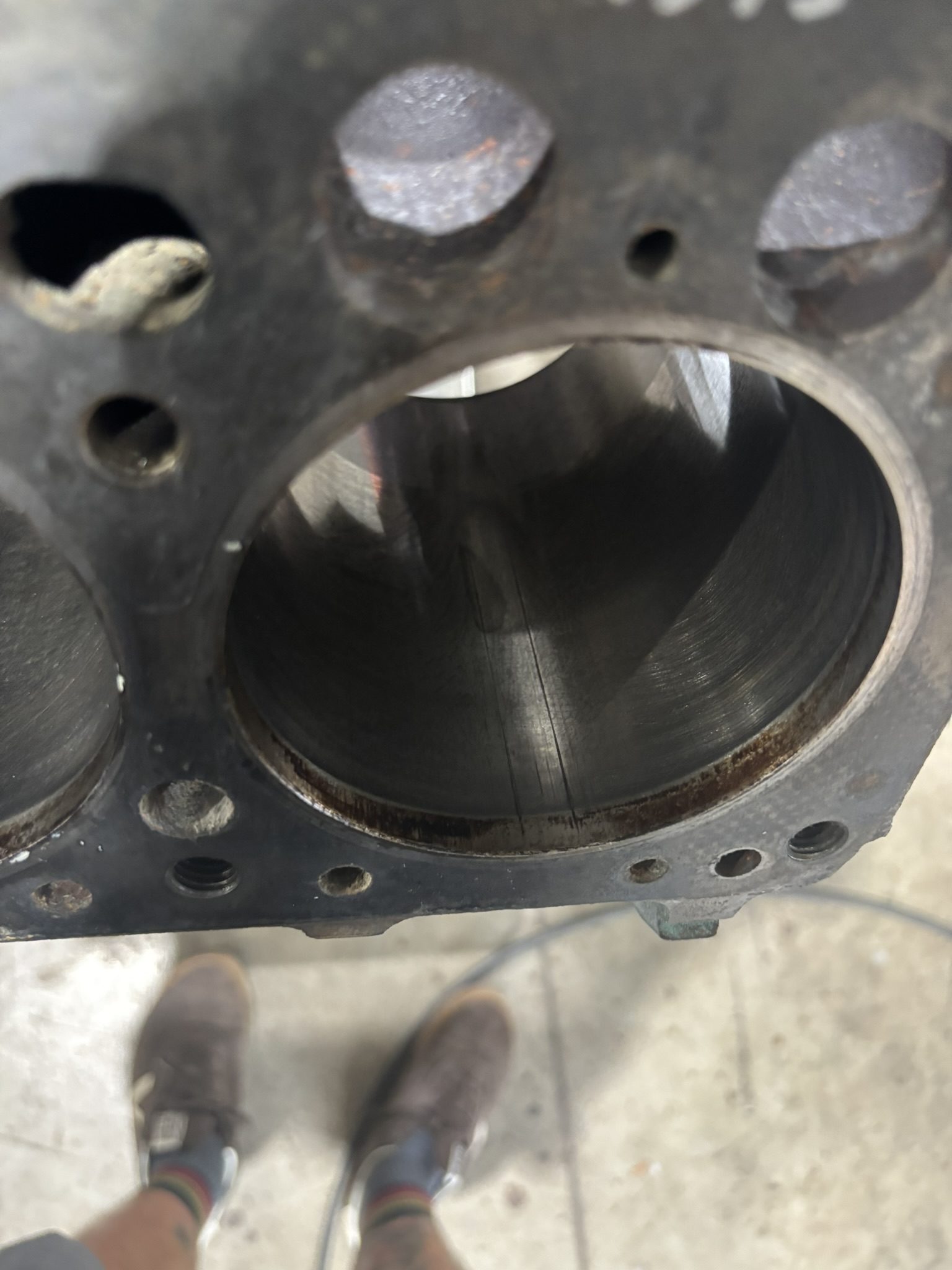

    I just got the message below from Billy
    “Lifter faces look good - implies cam OK also. Pretty big scar in #2 cylinder - possibly broken ring during ***embly. Looks too big to be trash
    I think this thing is bored +.030 now. Might be able to bore that one hole & put in 1 piston. Other option might be sleeve
    I’ll get it completely apart and look over the options. May take another day or two. I think it may be possible to get just one piston if necessary”
    Not the best news but not the worst…kind of lines up with what I thought I was hearing—something rubbing in one of the cylinders.
  10. George
    Joined: Jan 1, 2005
    Posts: 7,973
    George
    Have it sonic checked, .125 over can often be done. I like my walls to be as thick as possible, sleeving the one cyl. is a good option, machinist can tell you if the others need boring to .060 or if good enough to just go with oversize rings. Boring one cyl is not recommended....

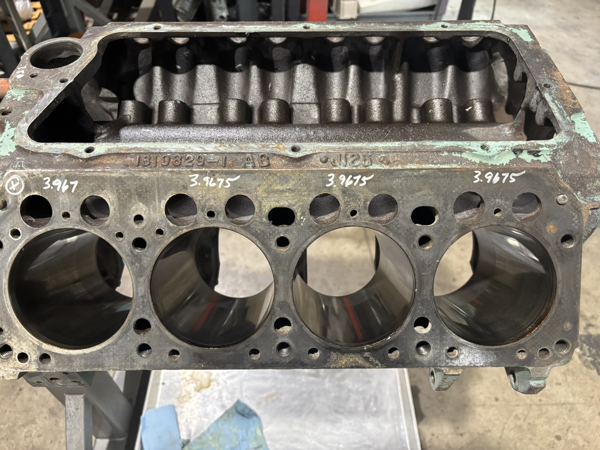

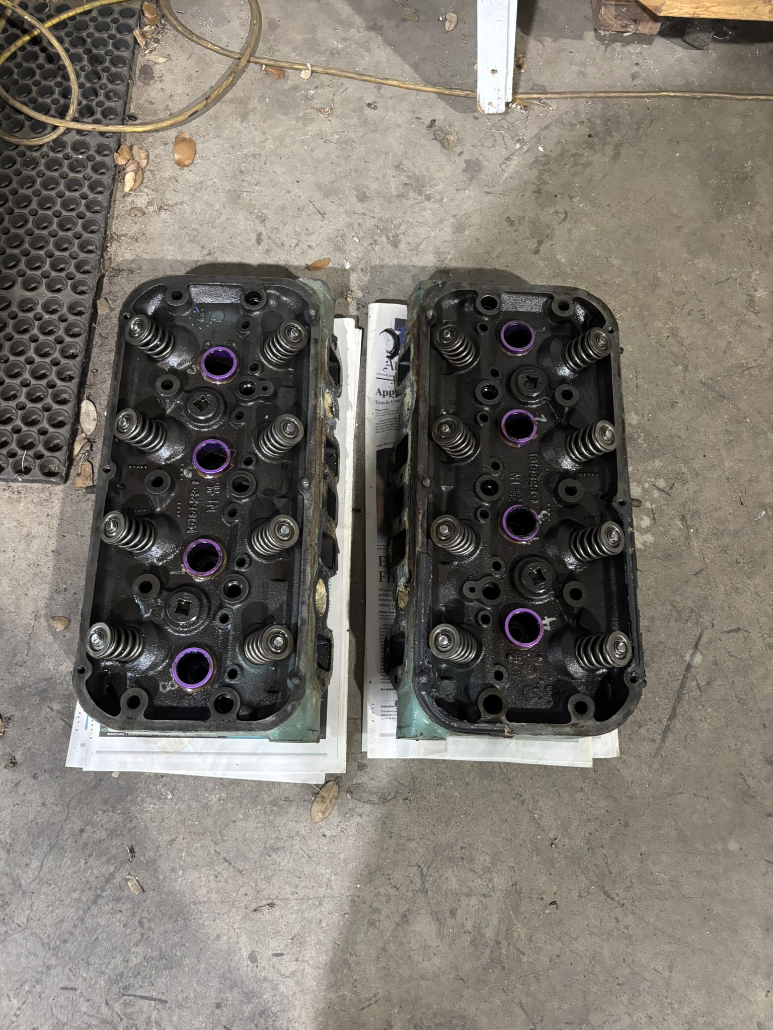

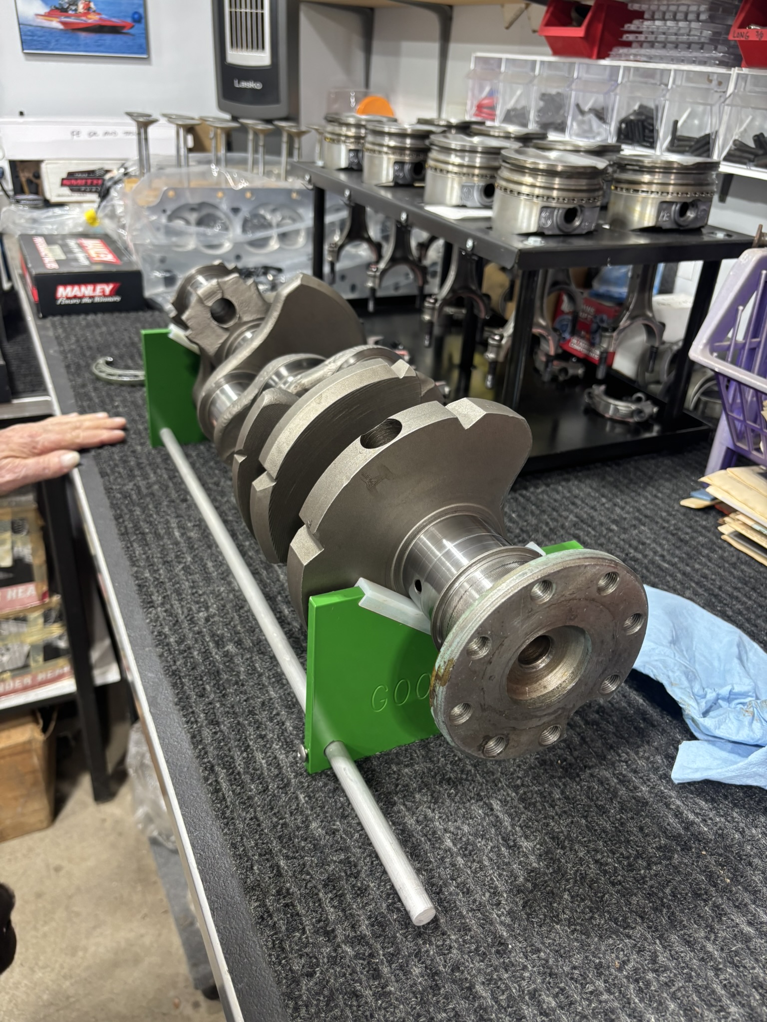

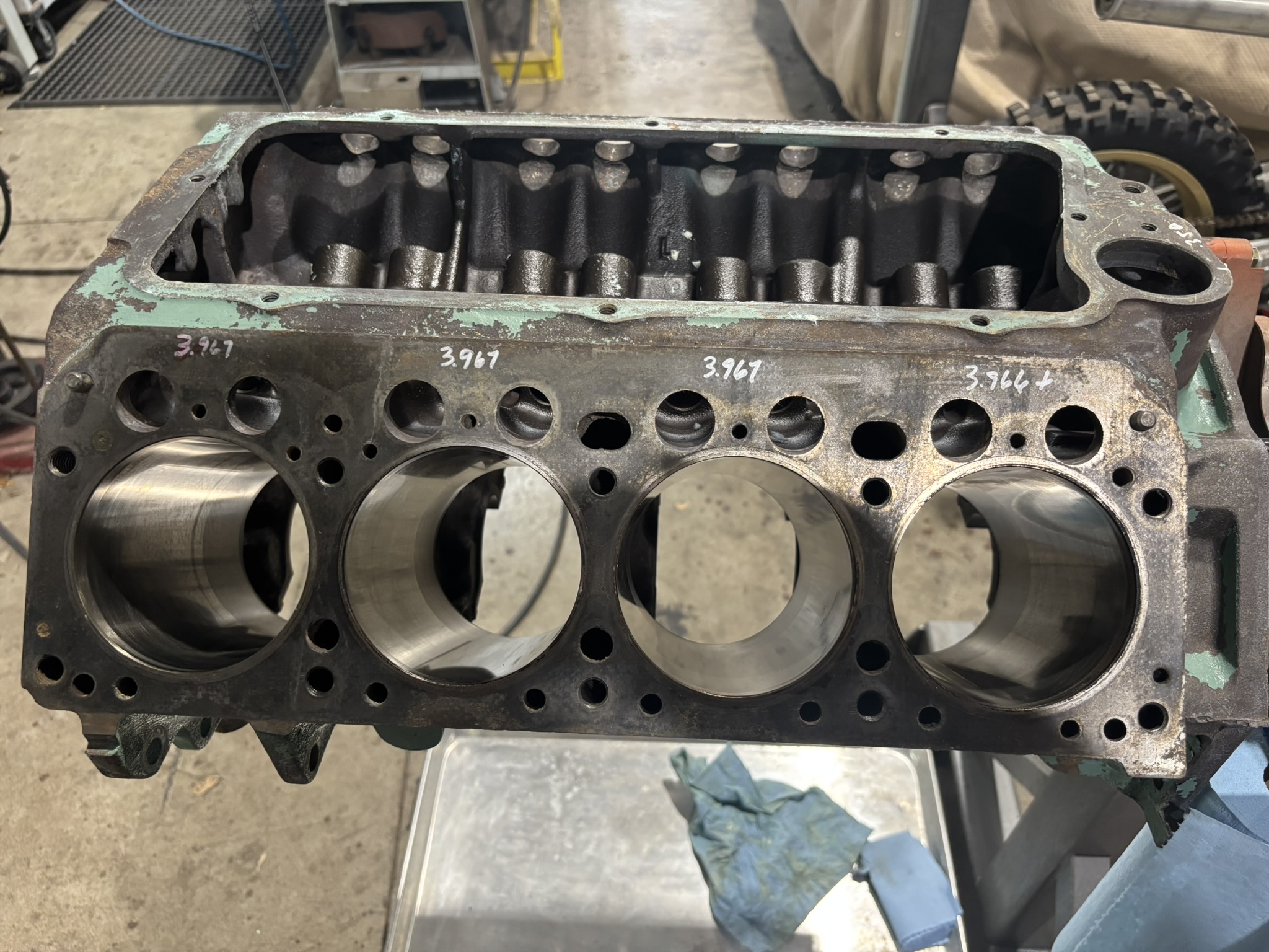

    Ok, got an update for you guys. The engine has been torn apart, measured and ***essed. The game plan was established and we are off and running. Should have everything back together and in the car in about three months.
    This gives me time to clean up the engine compartment and wrap up some other things that need attention while the engine is out of the way.
    The findings:
    • There was some trash in #2 cylinder that scored up the wall pretty bad. This is likely the squeaking noise I heard.
    • The cooling p***ages had a ton of **** inside which is likely the cooling issue.
    • The previous builder used grade 5 main bolts with lock washers
    • The crank had a few dings from ***embly that caused excess wear to the bearings
    • cam and lifters looked great and will reuse them--remember the engine only had around 1,000 miles
    So here's the game plan:
    • Hot tank and deck the block, sleeve cylinder #2 and bore to .040 over. The other cylinders will be honed another .010 over to be .040
    • 10:1 forged Ross pistons, new rings, pins...etc.
    • Resized connecting rods, new bolts, polish rods and replace the bearings
    • New main studs, align hone and new main bearings
    • Polish crank and balance rotating ***embly
    • Rocker arm ***emblies sent off to Rocker Arms Unlimited for a rebuild
    • Heads getting checked out by head shop and waiting for recommendations
    • Cam and lifters looked good, running them as is but putting new bearings since we are hot tanking the block
    • bead blast all the aluminum, clear with flattener so it's not glossy, everything else gloss black
    It's hard to see in this photo, but you can see the score at the bottom side of the photo

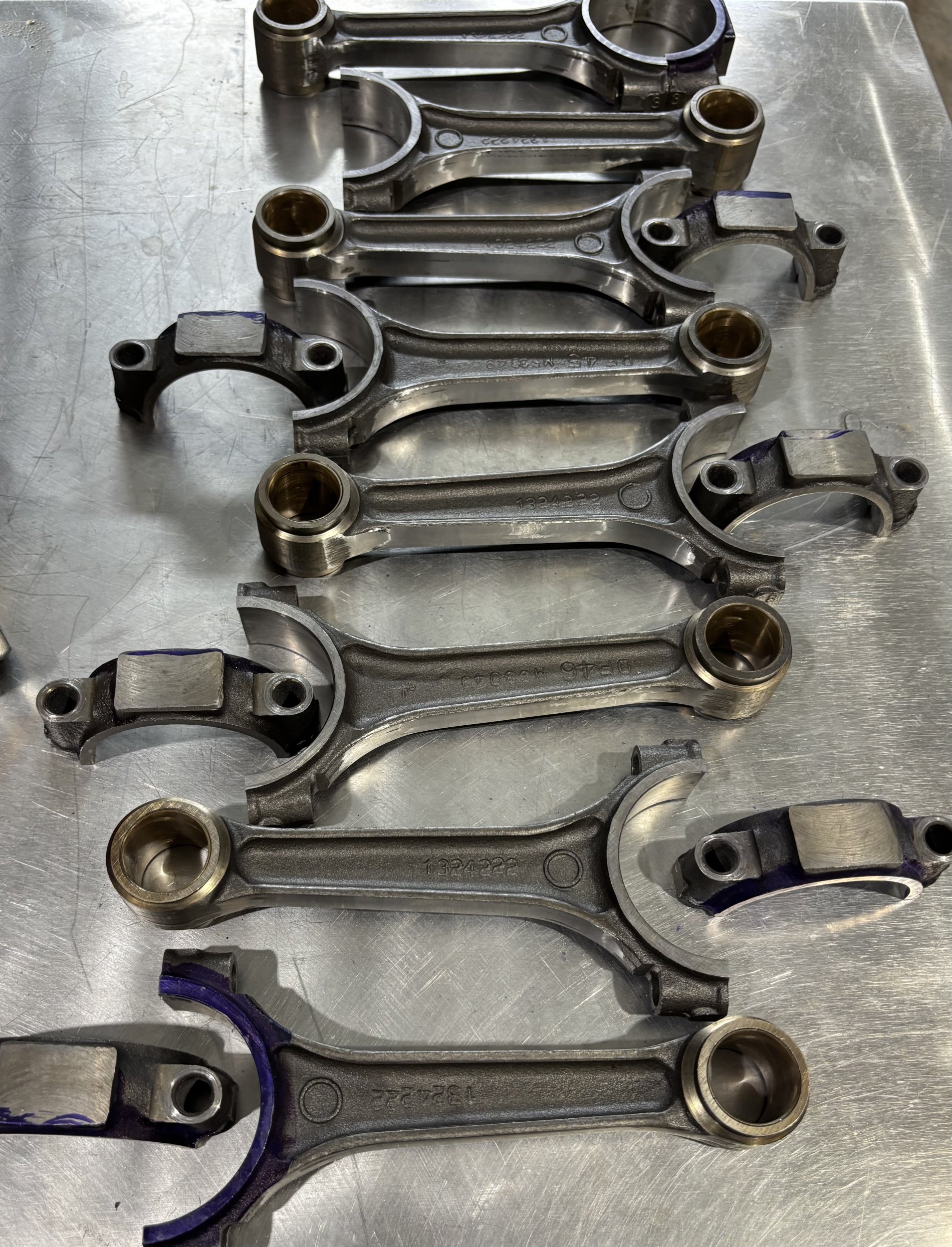

    IMG_6773.jpeg Stopped by Billy’s shop and dropped off some parts that came in from Hot Heads. He has the crank ready to go and almost done with the rods. Waiting for rod bolts to wrap those up.
    the pistons are ordered and we have e our place in line for the 8 week wait. Once the pistons are in hand, the machine shop is going to finish their work.
    Spent today cleaning and organizing the garage. I still had a big mess from pulling the engine a while back.
