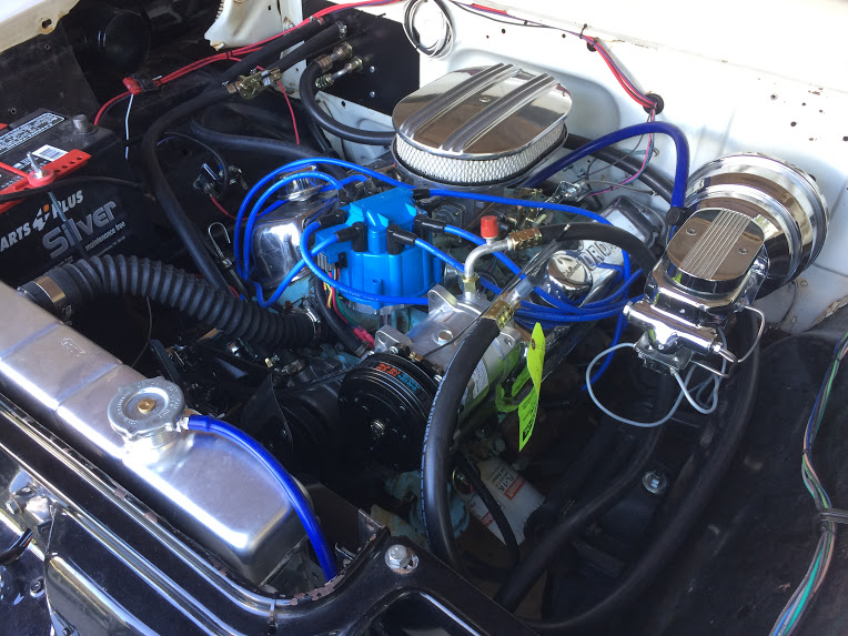

    So added a HEI dizzy for simplicity's sake (and further cleaned up the firewall). I know the issues and problems, and pros and cons; for example I know I need to get a spare control module and throw it in the glove box. I dislike the size, but there is something about retrofitting an GM product onto a Ford :) and you can't beat the function and simplicity. Need to clean up the wires...

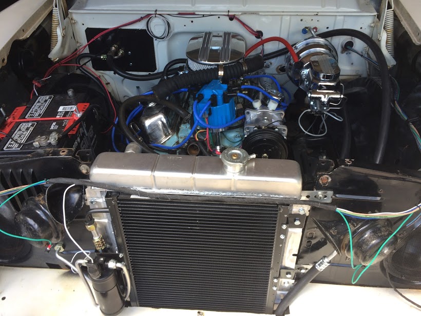

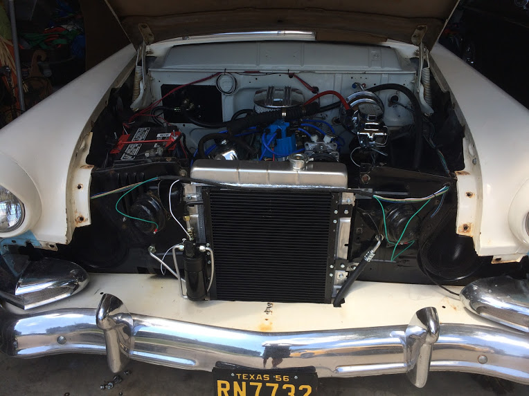

    So in preparation for AC, I need to add a better radiator. I thought I had it all figured out. I got an aftermarket radiator, had the outlet swapped to the p***enger side (to eliminate the crossover lower radiator hose). It will be a brilliant clean installation...
    So, I go to install it and the mounting brackets are on backwards (facing back instead of forward). And the radiator is too wide to fit any other way. Even if I flip the brackets the right way the radiator is too wide to fit closer forward. I could cut up all the front sheet metal to make it fit, but that seems way too drastic, I'd rather get a smaller radiator and fab up brackets.
    So ***uming all that, the problem is twofold: First, it puts the radiator too close to the engine and fan in my current configuration. Second, it creates a weird gap in the surround/latch. This might not be too bad once I add the AC condenser and dryer, but seems odd to me now.
    Upon reviewing ALL the 1956 aftermarket radiators I can find, they all are that way (backwards mounting brackets and too wide). So a couple of questions for the group:
    1. Do I just s**** all this nonsense and re-core the existing? My worry here is the AC in hot TX summers. I realize I could have a new one made up from scratch or something, but first I'd like to see if I can't sort what I have out.
    2. Do I need the U shaped radiator support? It seems I could remove that, and mount the radiator a little farther forward, that might be the optimum solution. I could also either grind down the existing support, or weld up a new one if the view is that it's a necessary item. Of course, nothing fixes that gap all the way. Really not sure how I feel about that.
    3. Anyone have a better idea? :) What are others running? If I can get something that works right, I guess I'm open...

  14. Dos Cincos
    Joined: May 13, 2011
    Posts: 965
    Dos Cincos
    It's been a little while since doing mine but I seem to recall the yolk is turned around and aluminum blocks are used as spacers to push the radiator all the way forward. I found some pictures from the install that might help.

    Dos Cincos, thank you! This is exactly what I was looking for!

    Correct. It looks like most of the aftermarket radiators look correct, but the "ears" on the mounting brackets face the wrong way, and most seem too wide to easily fit in the radiator support and no way will fit in the front apron without some serious chopping. In measuring my new aftermarket radiator, it is 23" wide, vs the 19" of the original, and as I said the brackets are backwards. Kinda stupefied that all the aftermarkets are wrong like this. I'm thinking they scaled down, or mislabeled a F100 radiator then all copied each other?

    I should have mentioned that my car was originally an I6 car so it had a different front apron than the V8 cars.

    Just went out and checked, looks like it should still work a treat. I'll need to move the horns back a bit to clear the mounting brackets, but my biggest issue was going to be the huge gap, your trick really minimizes that.
