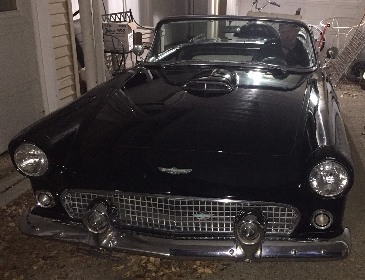

History 1956 Ford Thunderbird find, eventually buy, and get most of way home!!

    I really really liked the wide whites in the first picture. Neat car.
    Hamtown Al and loudbang like this.

    Congratulations, that is one sweet T-Bird, BTW, I wish it were mine!:) HRP

    Man, that is a very nice Bird! Jealous, jealous, jealous.
    Hope your son-in-law lets you borrow it now and then.:D
