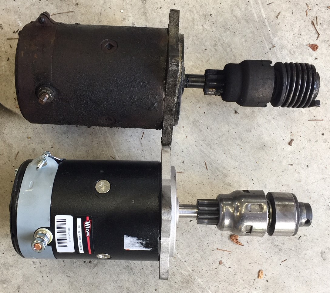

    I got the starter and managed to get the old one off.
    The old starter looked okay but the springy thingy was NOT seated in the notch but I don't know whether it matters or not... a Y block guy Y am not!:D
    Installed the new starter after some wrestling.:eek::eek::D:D
  11. jaracer
    Joined: Oct 4, 2008
    Posts: 3,054
    jaracer
    Looks like you might have broken the washer that locates the spring. In high school I had a number of cars with Y blocks. I used to have a large coffee can full of bendix parts. It wasn't uncommon for the washer or spring to break. Of course all the cars I had came pre-worn out.

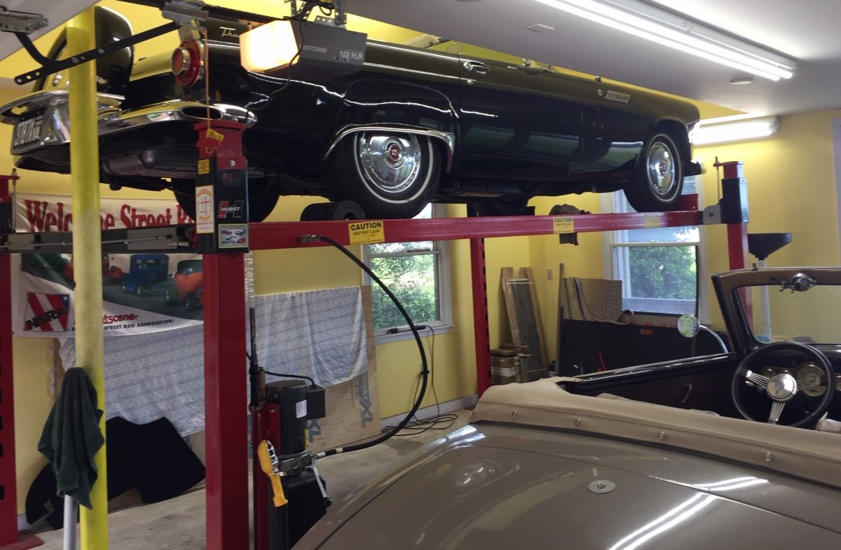

    I got it back home on the lift and cut it off. It started right back up! That's good I thought. Not so lucky on the next try.:eek::(:mad:

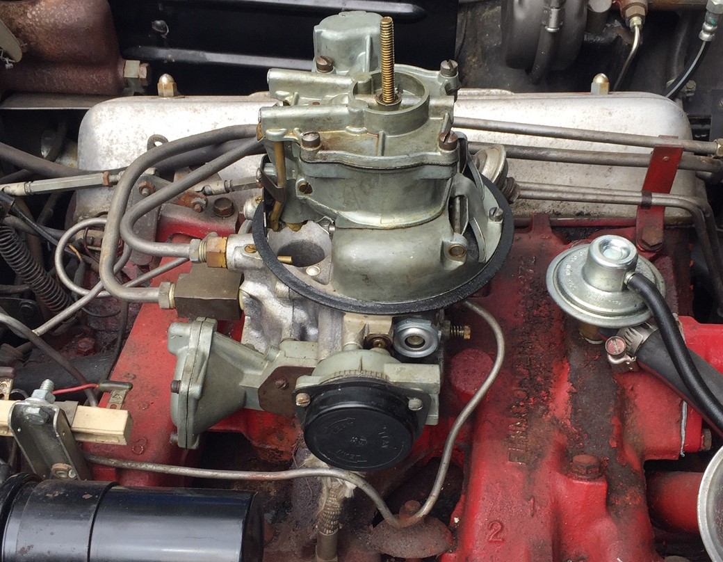

    Bert went early this morning to retrieve his Thunderbird and, on cue, it started just fine. Later I took him back to get his truck. He then went to work on cleaning and polishing the car and using Mother's to spruce up the chrome as much as possible.
    I returned home and started reading one of many of my Dad's Motors Repair Manuals. I'm reading and thinking all the while about our problem and what could be causing it.
    Then, bingo! I remembered that every time I sprayed ether into the carb, I had to open the choke... duh!! That dang teapot design carburetor threw my thinking calibration off!!:eek::D
    I called Bert and told him to put something in top of carb to hold those flaps open and try to start it.;)
    Moments later I get a call that I'm on to something! The car started!:):) I told him to bring it over and we'd try to fix it. Sure enough, if you propped the choke flaps open, the car started easily.:) Now what to do? We started by thinking of how to hold choke open when a light came on in my old head to try adjusting the automatic choke!!;)
    Sure enough, I took it apart and dialed in the setting such that choke was off after warming up and it starts fine!:)
    As luck would have it, Bert used a pair of needle nose pliers I had recently loaned him to keep the choke open the first time he tried it. What's particularly ironic is that those pliers were my Dad's!! He p***ed 27 years ago and he's still helping me.;):) And Bert!!
    After it started, I removed the pliers and you can see that the choke flaps are open some. This was before I corrected the automatic choke setting to be more agreeable to working correctly with a warm engine.;):)
