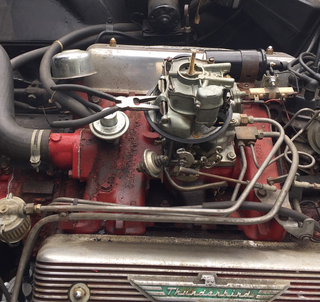

    Sure enough, I took it apart and dialed in the setting such that choke was off after warming up and it starts fine!:)
    Thanks for all the help and encouragement and remember to check the dang automatic choke on your carb!!
    Boy I'm glad we figured this one out.:)
    Thanks again,
    Happy Al[/QUOTE]
    Is the choke tube getting hot? In order for the choke to work properly you really need the exhaust flapper valve working and the tube in the intake functional. You have a little filter on the left hand side of the intake that draws air in the tube and it gets heated with exhaust as it is drawn into the choke housing via a small vacuum port inside the choke housing. When the engine is warmed up, the tube going to the choke should be very hot. If it doesn't get hot you will never get the choke to work correctly.
    If the flapper works, and the tube isn't plugged or burned in two inside the intake, the correct way to set the choke is with the engine cold. On a cold engine you turn the choke adjustment until the choke plates just barely close. That is a base starting point. From there one or two marks lean or rich is about all you should need to dial it in. With a good heat stove (the tube in the manifold) the choke should be fully open with the engine at operating temperature.
    If the flapper isn't working and/or the tube is broken or plugged, an alternative is an electric choke cover. Wire it to an ignition circuit and set the choke as I described above. The electric covers work well. That's what I have on my 57.

    YUP that choke tube is the first thing I spotted . Find a NOS or a Repro. one. It looks like somebody tried to make one. JHMO

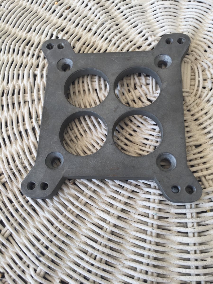

    Ordered a new distributor that has mechanical tach drive and electronic ignition.
    Had a pal really come through to help by finding an old, pretty much thought of as unobtainable, adaptor to mate a new Edelbrock to the stock 56 intake manifold!! Hope to have all the pieces(I know about!:D) next week.

    I'm not positive but I think this is the adapter you need. --1351935b --The one you show has straight bores- this one has tapered bores. Speedway has them.[​IMG]

    I didn’t know that...I have 3 .. 1 straight and 2 tapered. 2 came on a dual quad manifold I bought. I think Speedway sells them to fit large base 4 barrels on the flathead 4barrel manifold they sell. So does Clifford Performance for their inline 4 barrel Manifolds..

    ^^^Fantastic!! Obviously I didn't know about Speedway making them... hopefully somebody would have found it for me or I'd have stumbled onto it by myself.
    Thanks, greatly for finding them and sharing the news that they are readily available.
    Teapot owners rejoice! Keep them if you love them but at least there is a relatively inexpensive way to go to alternative carburetion. Another option I found was a brand new intake made just for Thunderbirds that cost $485 as I recall. This is good news for all Y Block owners as to options in building and maintaining their vehicles.
