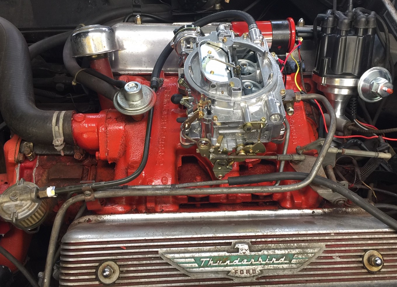

    Bert came over to help and now the carburetor with the adaptor is on and the vacuum lines have been tweaked a bit to connect to the new carburetor.
    We spruced up the manifold, etc. a bit more, too. Next will be the distributor!:eek:
    Opportunities!:D
  2. jimmy six
    Joined: Mar 21, 2006
    Posts: 17,104
    jimmy six
    You can purchase a carb fitting so you can bend a steel fuel line from your filter to the carb bringing it from the rear or across the front. I still use coat hangers for templates.

  4. jimmy six
    Posts: 17,104
    jimmy six
    Looks great. Steel lines make an engine compartment look stock even it they are not. Rubber hoses with a plastic filter just don’t look right or good to me. 65840A6A-7215-4C54-A753-FEF42D568188.jpeg

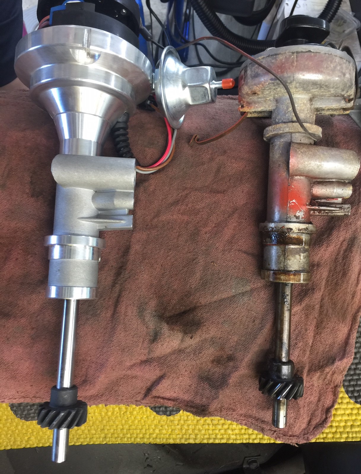

    The following are some reference pictures I took in preparation for pulling the stock distributor.
    The above is from the p***enger side. Rotor pointing pretty close to straight to firewall.
    The above is from driver's side; showing tach drive outlet housing below clip for cap.
    Above is same as previous but from p***enger side.
    These should be adequate reference pictures. Now need to pull the old distributor:eek: and begin checking for length, etc.;)

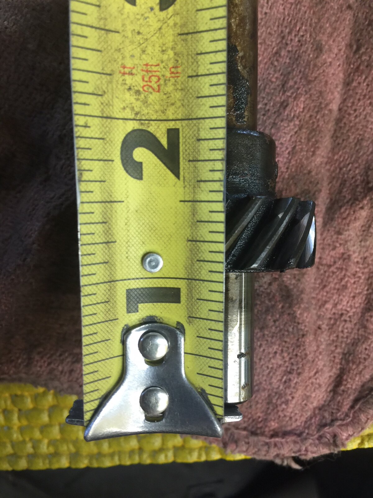

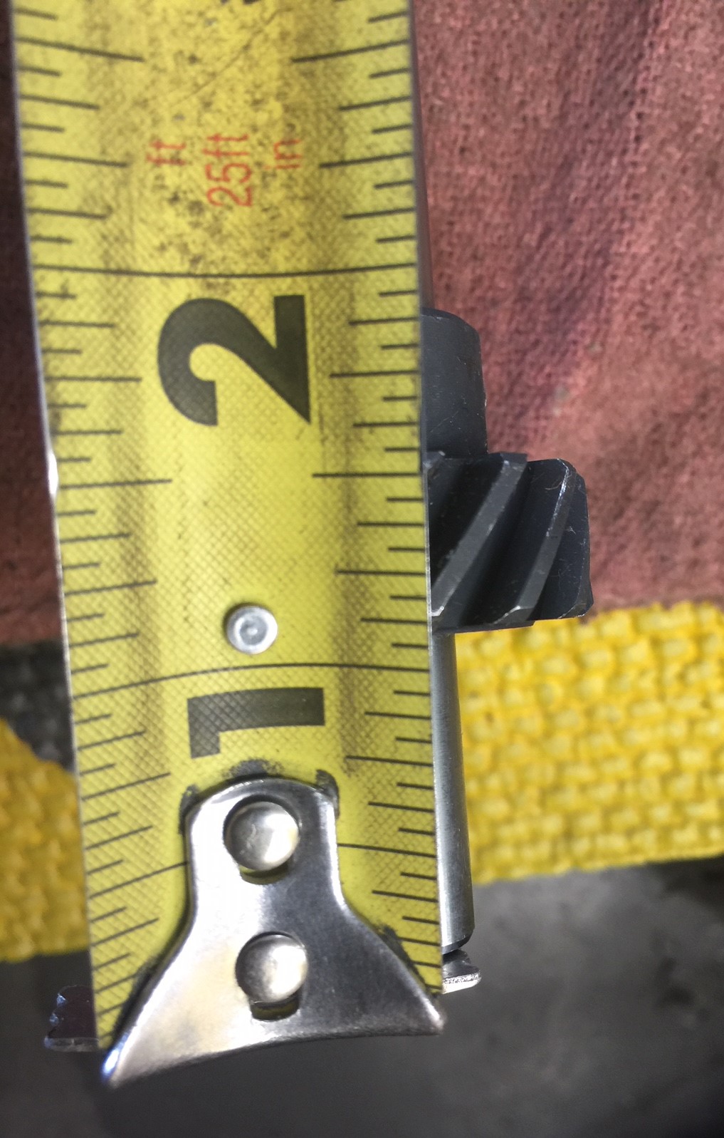

    Hamtown Al
    I did a poor job of lining them up but they measured the same length and I checked that the location of the bottom gear was the same.;)
    No pictures (yet!) but the new distributor is in!:) I even think I got the rotor in the right spot!:D

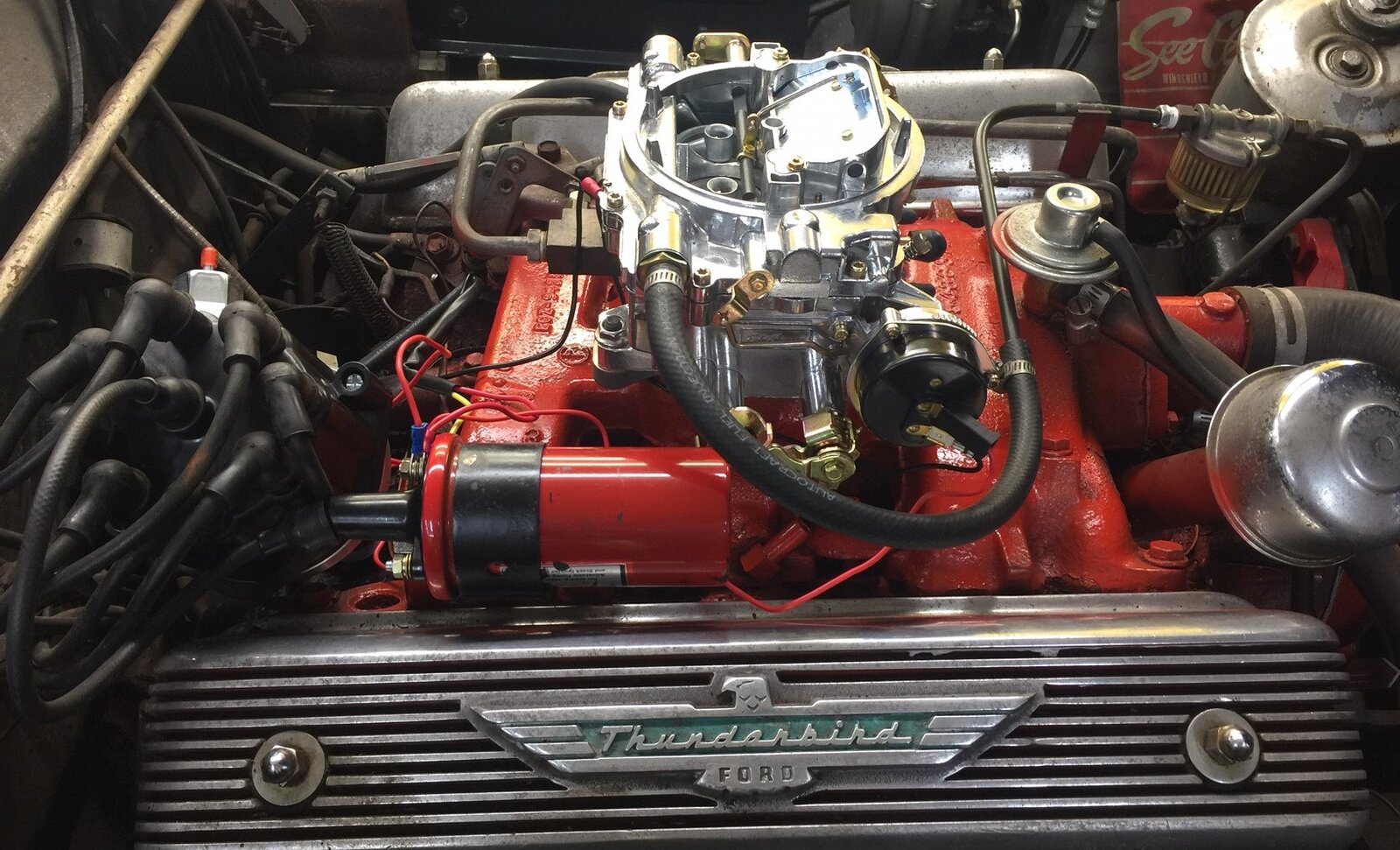

    I left the electric choke wire way too long and hooked it to positive side of coil.
    I also changed new hard gas line over to a hose before hooking to carb. The vacuum lines to the fuel pump still need some new hoses and tweaking but the overall initial hookup is nearly complete.
    The whole setup will need some tweaking I'm sure. I notice in the pictures I need to double check that coil wire and probably check to ensure that all plug wires are fully inserted into the cap.;)
    We also need to gap the plugs to .045.
    Details... more opportunities!:D

  12. loudbang
    Posts: 40,346
    IF it was mine I would be more inclined to route the fuel line this way to avoid the choke parts and away from the coil. And it helps hide and cleanup the installation of that shiny new carb.
    In the lower photo I would re-route the section of small hose to run UNDER that steel line it p***es on top of now. :)
    Not much work involved now that you are already there making changes.

    I don't understand why the fuel pump seems to have two vacuum lines coming off the top.:confused:
    One I presume is to add vacuum to the fuel pump for whatever reason as it runs from back of carburetor to the fuel pump. The other runs from the fuel pump to the hose that needs to be rerouted... I don't know where it goes after it enters the firewall.:eek:

    Millions of VW bugs had the choke wired to the coil hot wire from the factory.
    Were the tubes on the fuel pump extra vacuum for the wipers?

    The upper vacuum tubes are an ***ist for the wipers as @BamaMav stated. Thru the firewall to the wiper motor.

    The vacuum booster on the fuel pump is to keep the wipers from stopping when you step on the gas and manifold vacuum dropped. It kind of worked.
