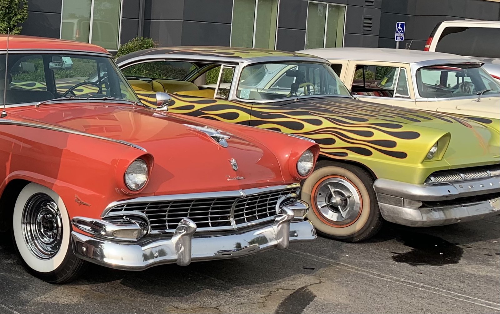

  9. I’d take the merc front over the ford.
    Looks great as a mild custom

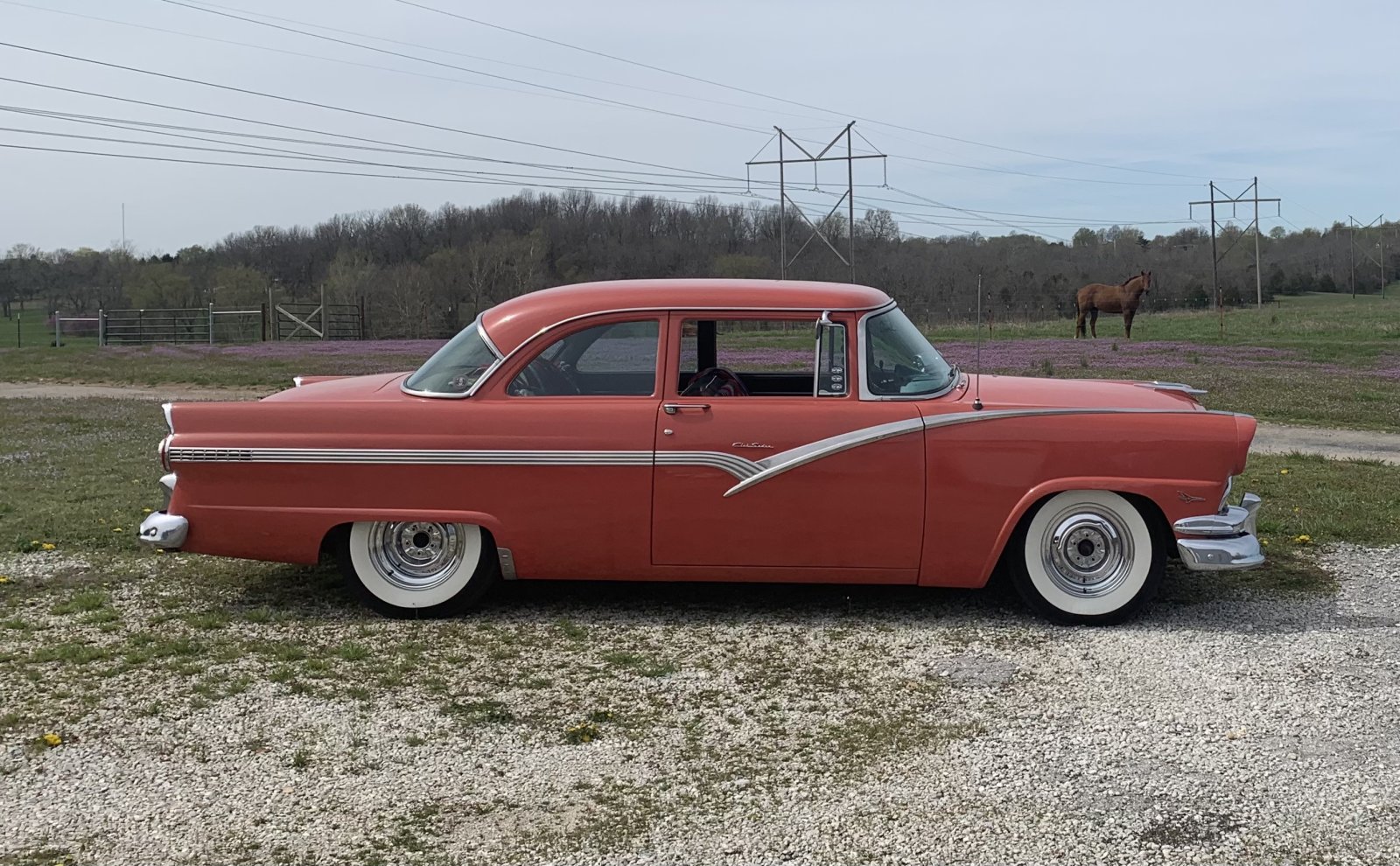

    @guthriesmith , do you have a side photo of your 1956, that we could see alongside the red and white Merc wagon photo above?
    The it should be easy to see the distance from the front of the door opening to the rear of the front wheel opening, to see if both cars are the same.
    I would guess they are different, as stated above.

    Here you go Phil.
