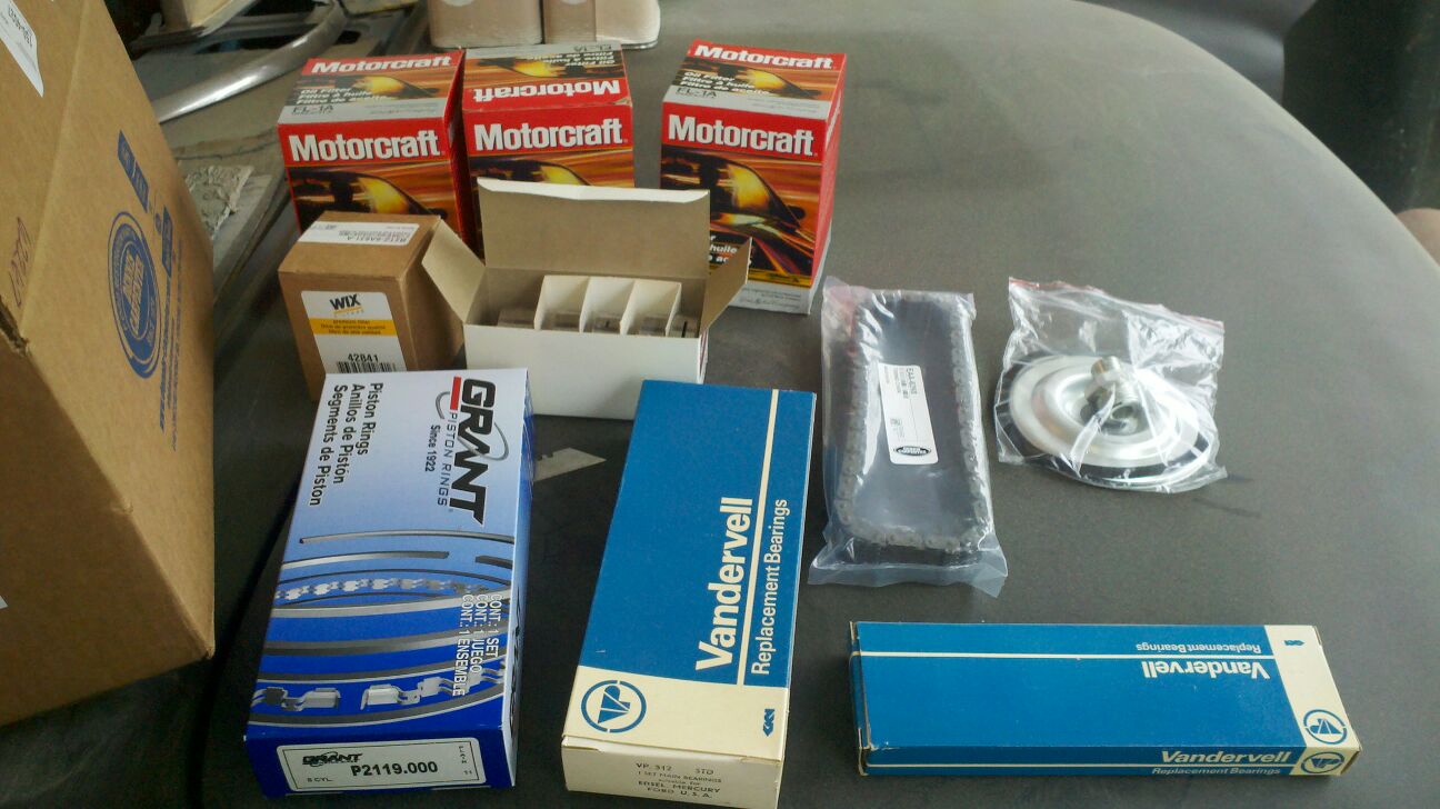

    I also got the rest of what I needed to put my engine back together...or so I thought. I got sent the wrong main bearing and rod bearings. The main bearing they sent me were for a 312 Y-block and the rod bearings were 010. over...I needed standard. Hopefully the replacements will be in by next week.

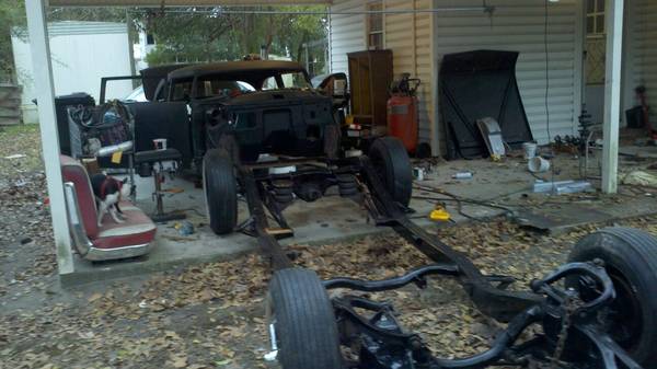

    Great car. Not crazy about the chop? Maybe the "B" pillars need a forward slant with less removed from the "A" pillars? Just my $.02 Have fun

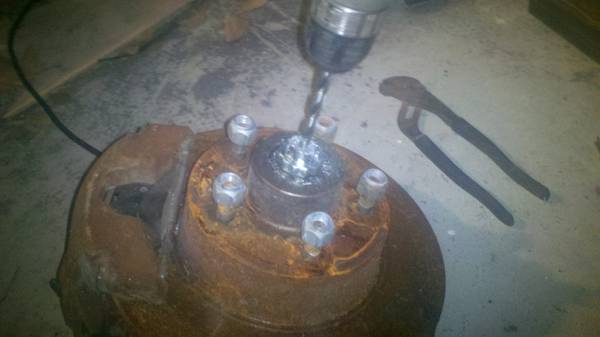

    Last night I drilled and Tapped the spindles.

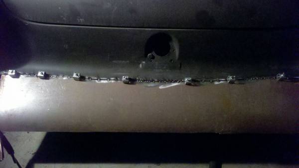

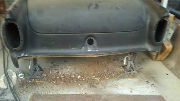

    Yesterday I finished painting the frame. Then I started on making a roll pan for the rear. I had to cut off part of the lower valance panel. I then tacked the roll pan into place. It is sticking out at a funky angle right now..i did it this way so I can roll it down and get a nice transition in the upper part of the panel. I also took a few mins and started forming some 1/4 rod into the shape of the tail light housing. I hope to have both the roll pan and tail lights finished this weekend.

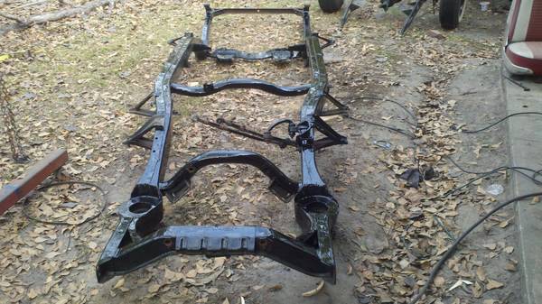

    I finished painting the frame and re***embled the suspension. I also reangled my pinion angle and finished adding my floating hubcaps to the car.

    No big updates right now. Im still waiting on my engine bearings to come in. I moved the frame into position to get it back under the body here soon. I also got my new body mount pads in.

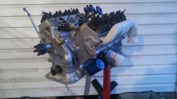

    Almost got the engine back together. Still have a few small things to do. I changed the engine color to match the paint job that will be on the car. If everything goes good the Motor and trans will be dropped in the car this weekend.

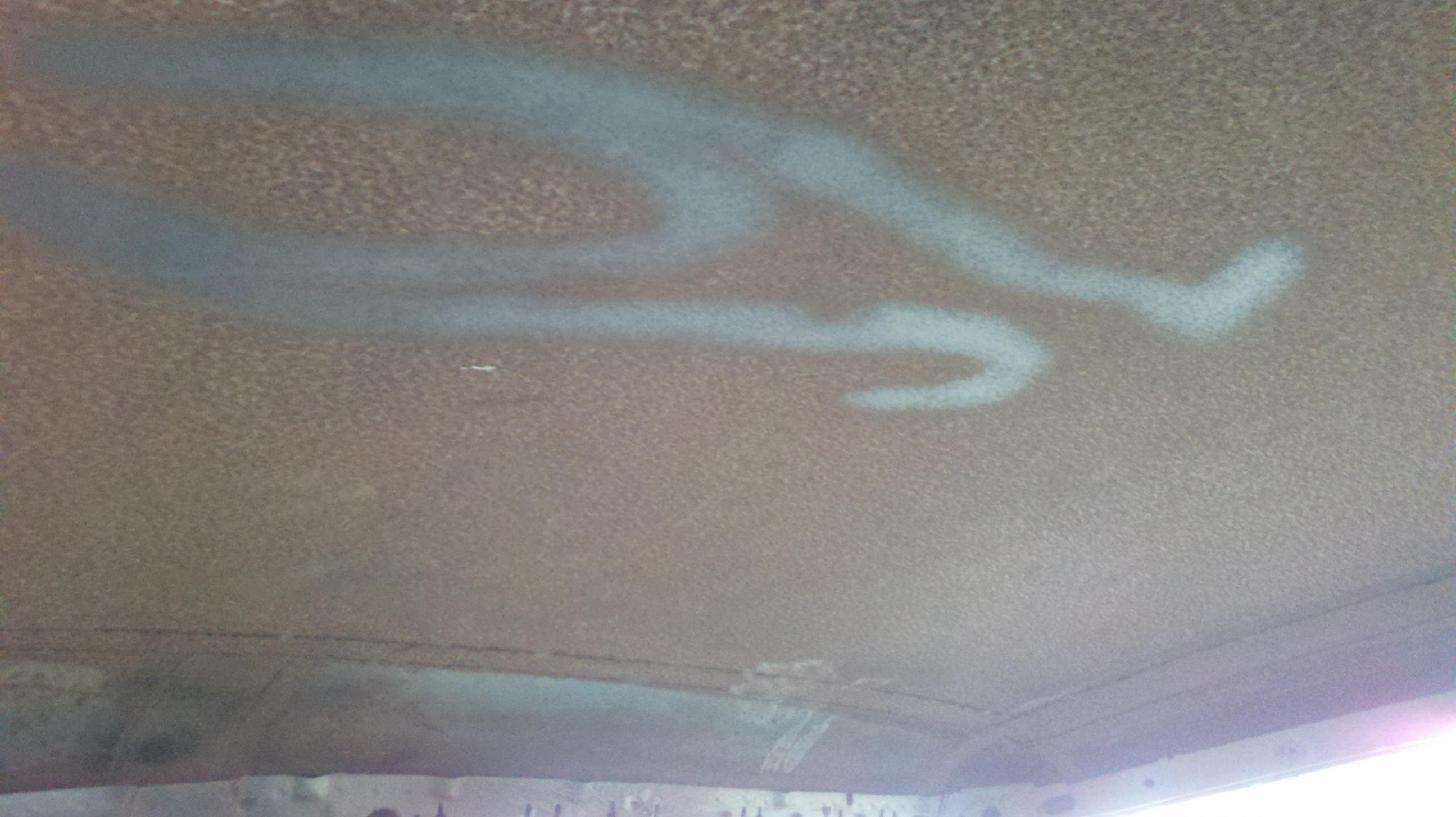

    I also started sanding the inside of the roof and the floor boards down. I will have a coat of paint on them this weekend.
