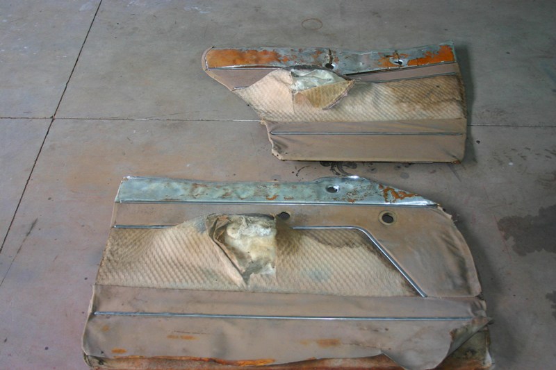

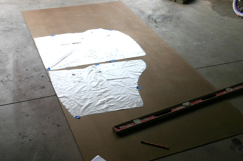

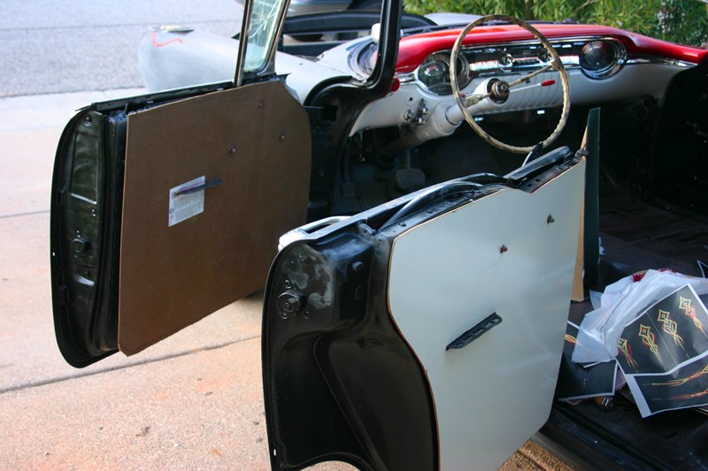

  10. working on cutting out new door panels...i was able to go to home depot and buy a board that was in the shower tub section for 13 bucks and position everything right so i could get all the doors and the back package tray too..i cut everything with my angle grinder with the cutoff disk on it..it smoked a bit but at least i didnt have to use the jig saw..also i have been playing around on my computer designing stuff for some pinstripping on the fenders later on down the road

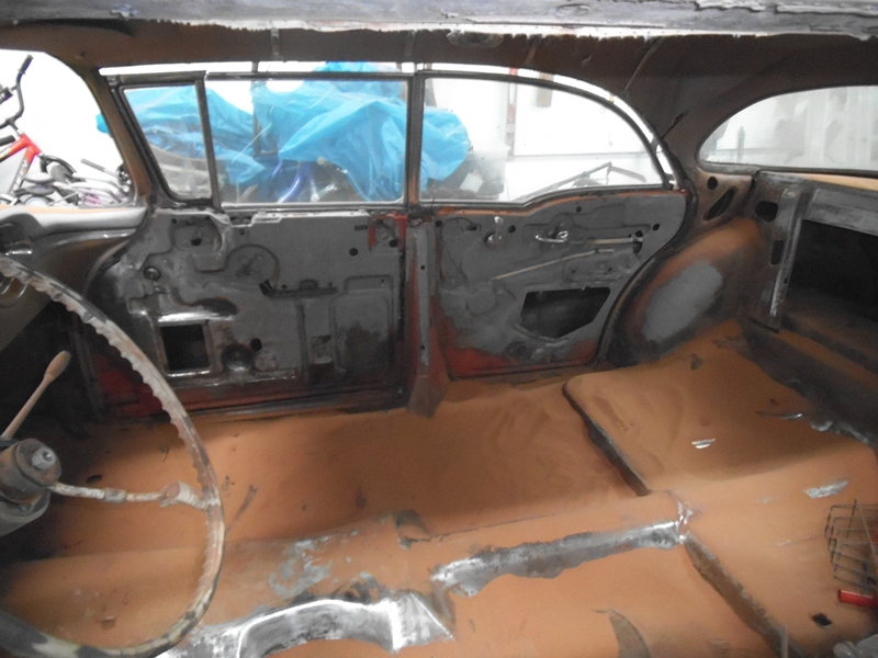

  13. And @ jakespeed63 all i did was just air disk sand it...and YES our cars are pretty nice but still there is rust but useally located in isolated areas...although the farthest west ones...ie california..i was looking at before this one musta been toooo close to the coast...rustarama...my floorboards were intact except for one tiny area i decided to cut out cuz it was getting thin

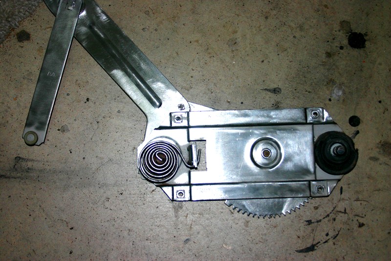

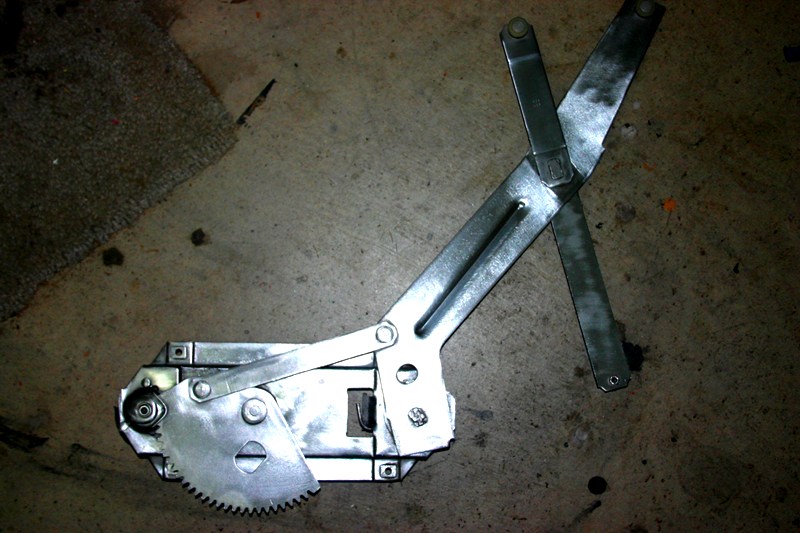

  21. here the front window crank before and after...the windows better glide up and down now with all the crap gone...as far as what i did to them i first sand blasted them with my cheap 19 dollar spot blaster then i went to town with a brillo like attachment on my drill also a steel brush attachment wheel just cuz i like everything shiney...oh also use PB blaster spray...i got it at home depot for 5 bucks..the hidden rust in the crevices..it just streamed out red rust...ps soda blasting would of been better being the sand took awhile to come out...:eek:

  22. shadams...im really trying to think outta the box on this...when i go to home depot im always thinking what here can i find cheap that can have a application on my 56...after all i dont have a ton of money and im going to focus the bulk on the real important stuff...:)

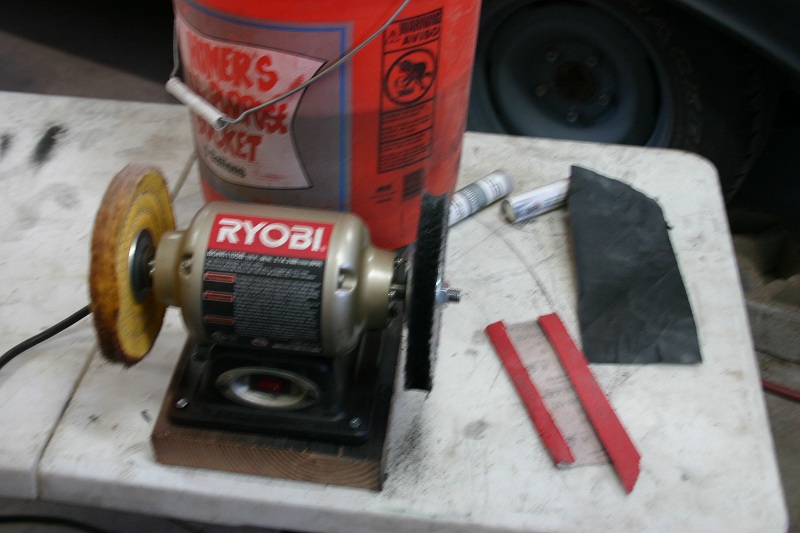

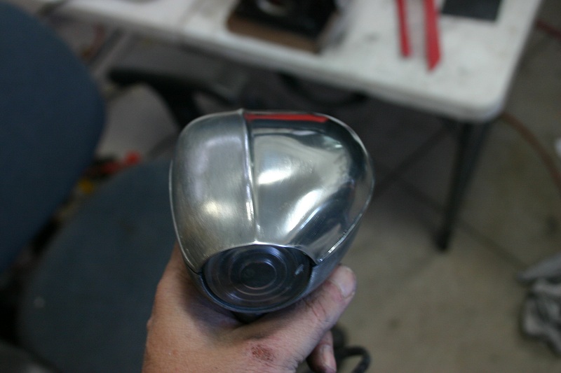

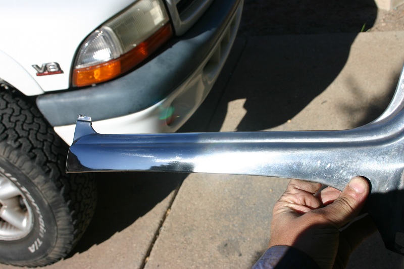

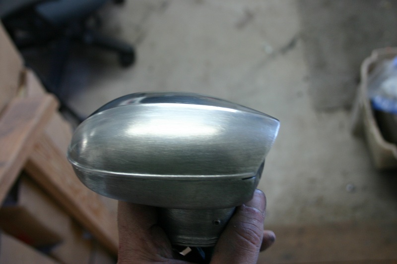

  24. i got a new toy over the holidays...i got a grinder from home depot on special for $29 dollars then outfited it with harbor freight disks for a grand total of 40 dollars...im telling you im having fun...its amazing what this does to stainless and other metals...check it out..just playing right now but im gonna tackle all my trim with this puppy..hell my wife saw what it could do and she handed me three rings of hers she wanted buffed...seriously...

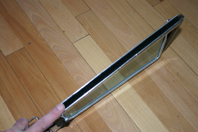

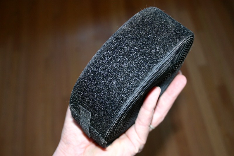

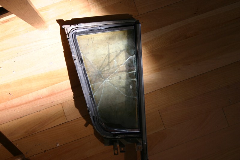

  26. my glass came...now im putting it in...slooowly being im taking one door at a time and cleaning every bolt and screw ...heres my vent window before and after..also my vent channels were lined at one time with felt or something...rather than buy whole new tracks i bought contact cement and a roll of the loop side of velcro at 50cents a foot and relined it with that..was going to use felt from home depot..but i think this would last longer...also i got silver vinyl finally for my door panels and also found out universal door pulls arent universal...they dont fit...the hole is waaay to big..:mad:

    Thank you for posting your tips and tricks! I'm going to get one of those spot blasters at Harbor Freight. I could at least strip the small interior trim pieces like you did, maybe use it on the interior floor.
    Good idea using velcro. I also saw some others using shoe strings to replace the fabric around the door handle and lock linkages inside the door.

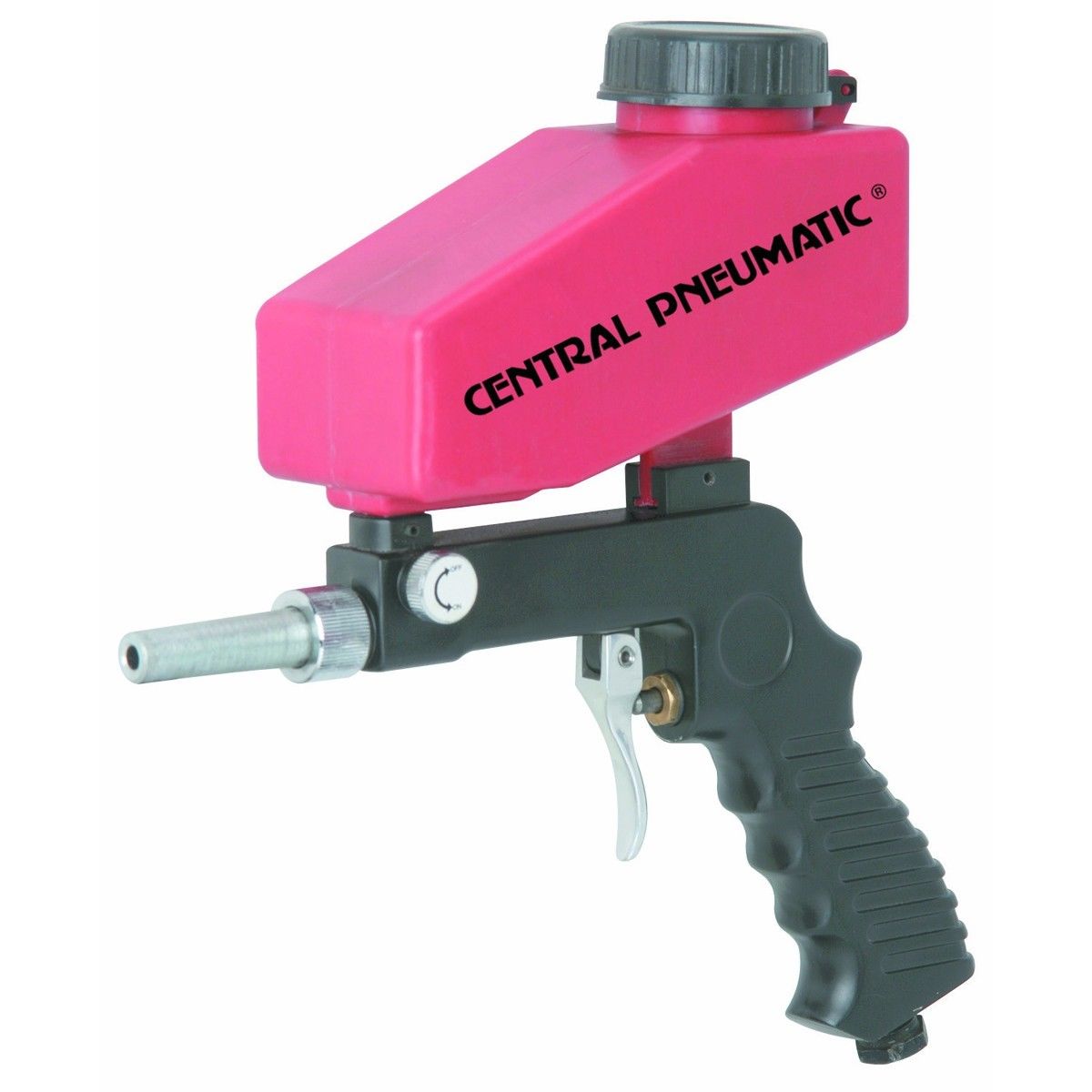

  28. benjammin...you can get a sandblaster gun on ebay for 17 bucks delivered...just make sure you get the one with the hose and not the top feed one...i tested both..the other your constently feeding material into it by hand...and when you do get it look on line and it shows the modification ya make to it to stop the surge problem..2 steps a hole drilled in the feed pipe and grinding down the inner nossle to let more flow..i run mine on a 30 gallon compressor tank...dont be expecting it to be super fast..but it sure gets in the tight areas...the bigger areas are best cleaned with a electric angle grinder with with a wire wheel

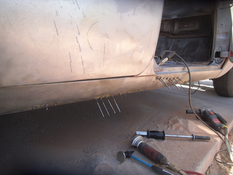

  29. since we are on tips..heres 1 more...weld nails on to pull stubborn dents..i did on my rocker panel...oh and heres what i did with that cheap sand blaster i did my inside doors..heres a pic in the process many moons ago...

    I did some research yesterday and came to the same conclusion as you and i ordered a hose fed gun off amazon along with a moisture separator for like $30 total shipped.
