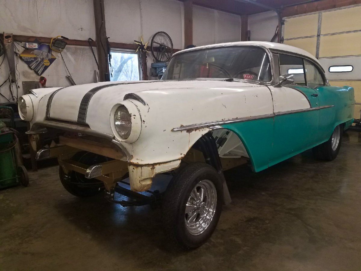

    We cut the flange and it goes on and off without a slip joint.
    1947knuck, catdad49 and loudbang like this.
  10. wvenfield
    Joined: Nov 23, 2006
    Posts: 5,671
    wvenfield
    Considering I've never done this before, I'm pretty happy. Finish these up and the last big thing is the pedals. IMG_20180326_231231.jpg

  12. Nice effort, my friend.
    However though, you're gonna have a mess on your hands on a dirty, dusty pit road with those collectors pointing straight down. You might want to consider making some 90 deg. , or maybe 80 deg, I guess, bends, and splice them in right below where the tubes end.
    Your pit neighbors will thank you, too.;)
    31hotrodguy likes this.
  13. DDDenny
    Posts: 22,570
    Roger that.
    I had a similar set of custom headers built for my sbc tube framed OT car.
    You become unpopular real quick and you also find out that the dust will enter EVERY little opening into the interior.

  15. wvenfield
    Posts: 5,671
    wvenfield
    Thank you. They aren't finished yet. Since it will be run on the street also we will also have to run pipes back for mufflers.
    31hotrodguy and loudbang like this.

  18. bchctybob
    Joined: Sep 18, 2011
    Posts: 6,093
    bchctybob
    Nice job on the headers, especially for the first time! Boy, you shoulda seen my first set - uggg - ly. And I picked the worst car, a friends 409 powered '55 Chevy.
    I always start with the hard side, then try to make the other side match as close as is practical.
    The car sure is coming along nicely.
    1947knuck likes this.
  19. wvenfield
    Posts: 5,671
    wvenfield
    Yeah, they don't match but having to go under the steering column it never was going to.
    31hotrodguy, 1947knuck and loudbang like this.
