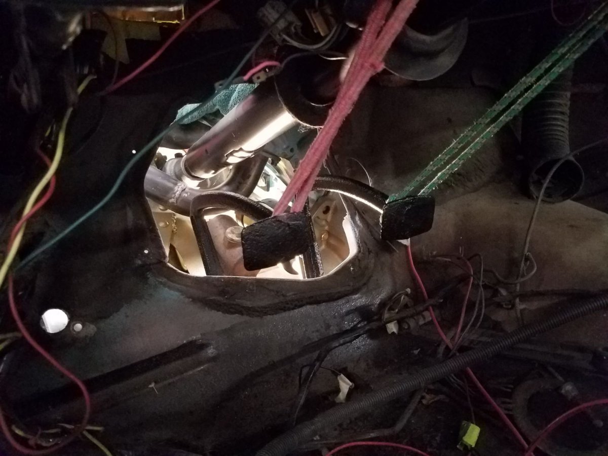

    Initial mock up for the under floor brake master cylinder linkage.

    Nice. Have you considered adding an extra lever arm for each rod?
    saltflats likes this.
  19. wvenfield
    Joined: Nov 23, 2006
    Posts: 5,671
    wvenfield
    I'm hoping this works as this is taking far longer than I figured the way it is. :D
    31hotrodguy and 1947knuck like this.
  20. Johnny Gee
    Joined: Dec 3, 2009
    Posts: 14,420
    Johnny Gee
    from Downey, Ca
    I'm not saying to redo the geometry. Just give the pivot bolt a chance of surviving the force placed upon it so it won't bend or worse yet fail. I'll use these shock brackets as an example to show how there wouldn't be any more side force.
  21. bchctybob
    Joined: Sep 18, 2011
    Posts: 6,093
    bchctybob
    I didn't quite get what Johnny Gee was saying at first but he's suggesting that you make the levers double-shear with a Heim in between. Those single sided rod ends may not be up to the task for clutch or brake pedal loads.
    Like this...........
