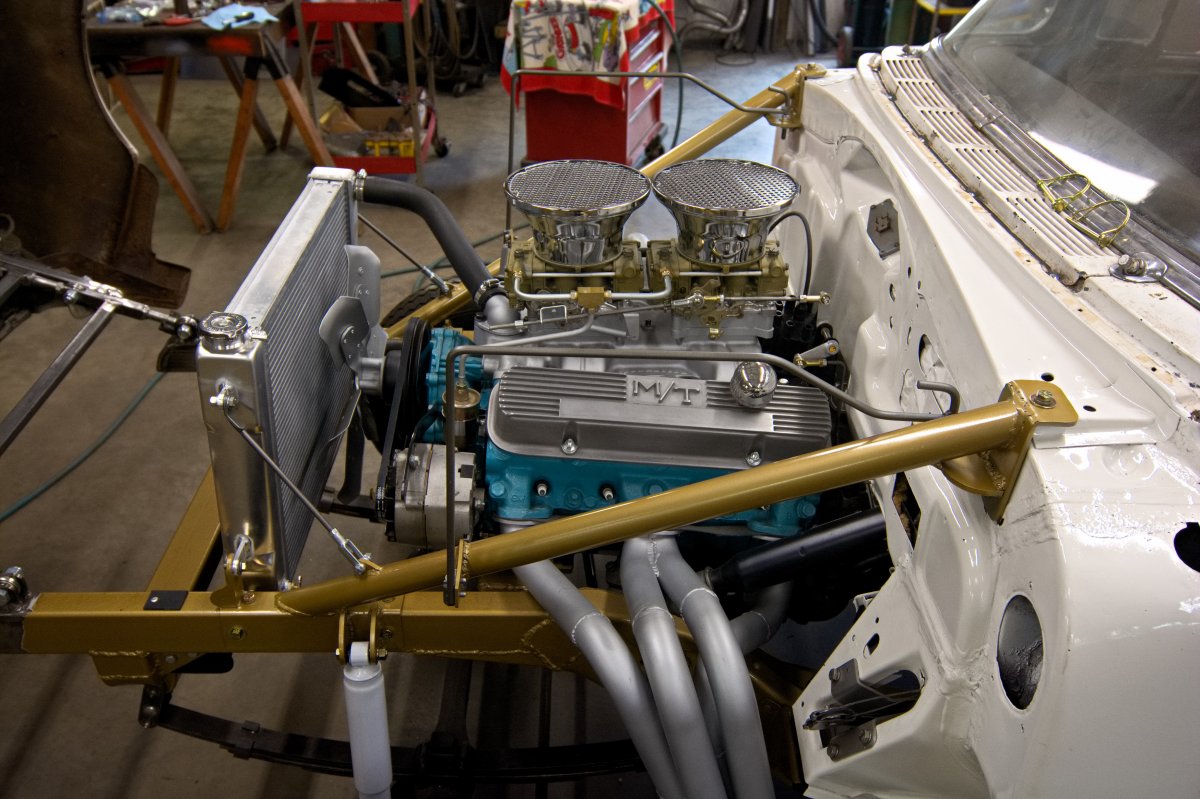

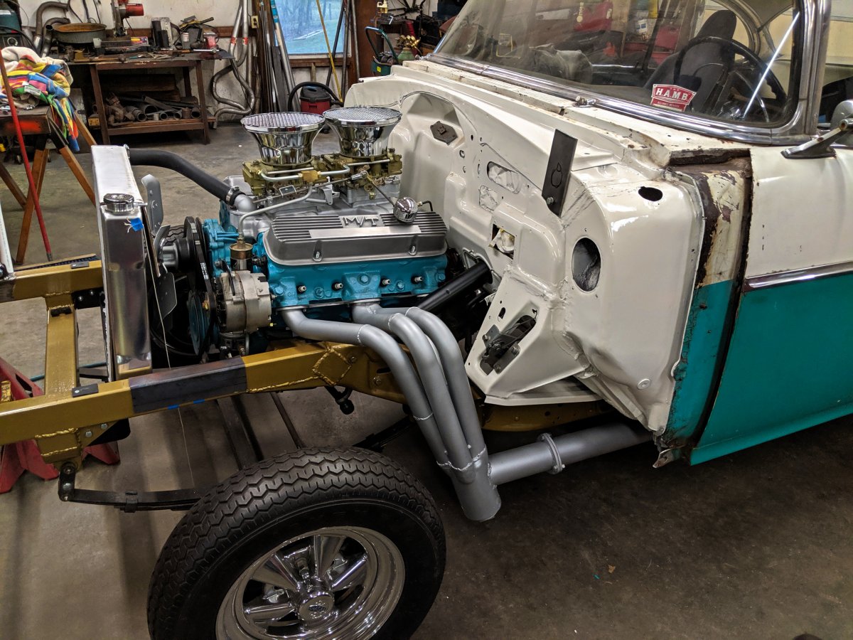

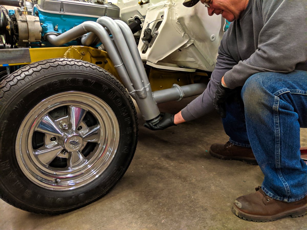

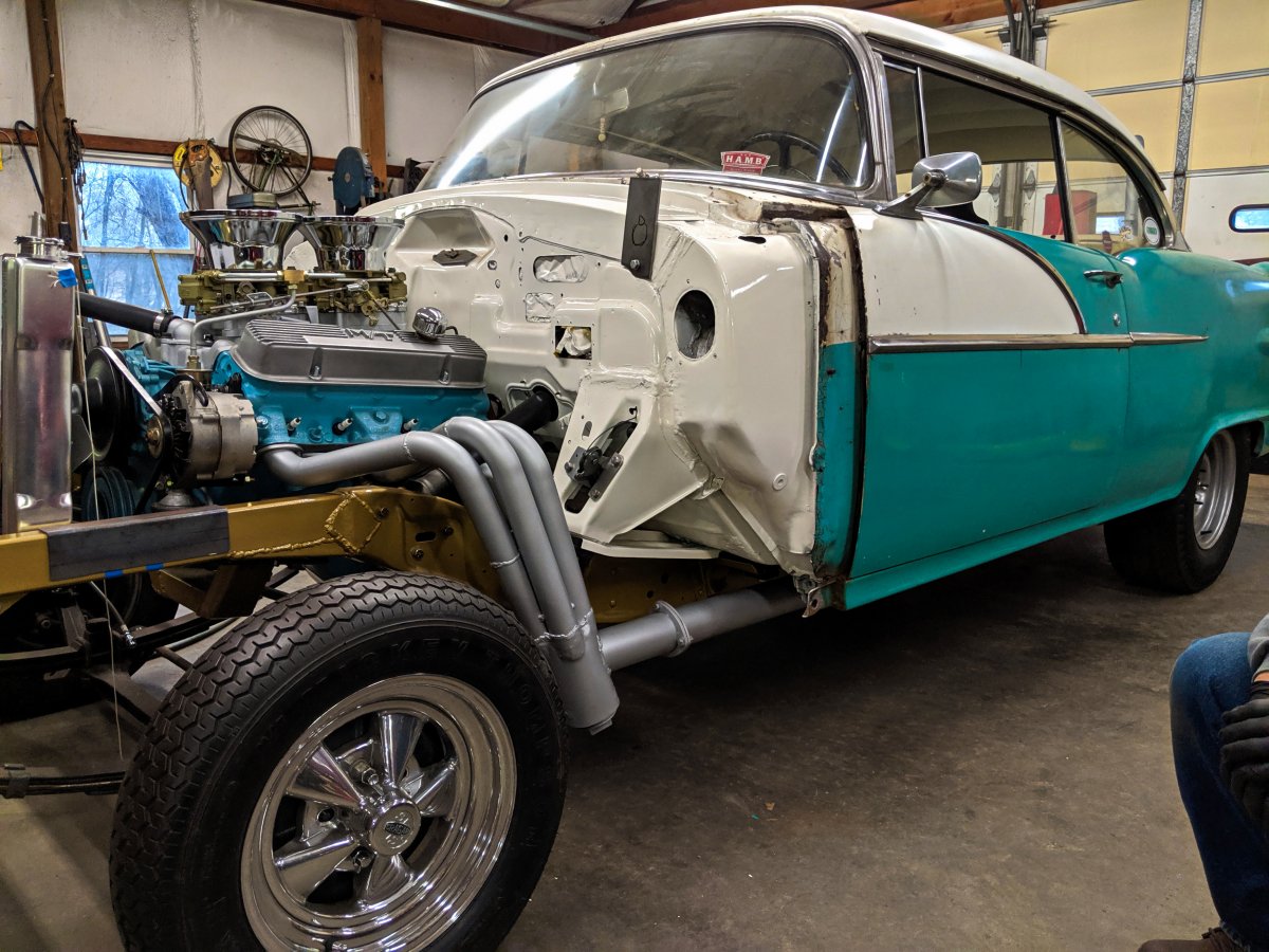

    Finally got the plugs welded in and headers and pipes painted. IMG_20200205_164252.jpg IMG_20200205_164313.jpg IMG_20200205_164330.jpg IMG_20200205_164352.jpg IMG_20200205_164406.jpg

    Excellent craftsmanship! Watching the progress of your vision over the years brings inspiration to us all. I personally am glad you kept the quarter panels

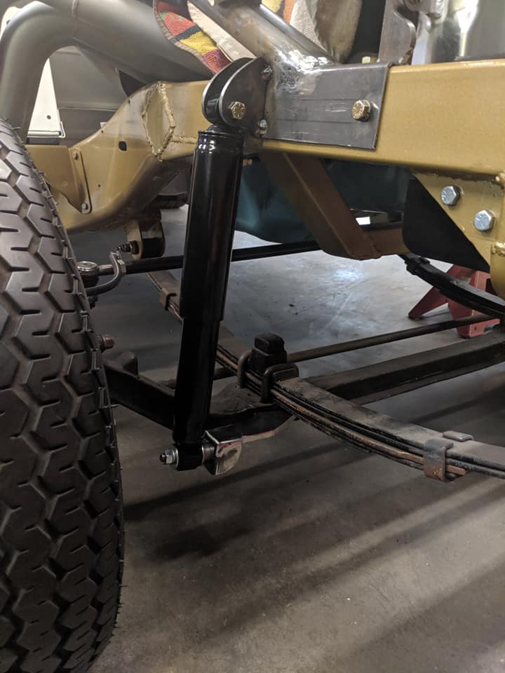

    Got the lower shock brackets made. Mostly posting to keep a record of progress if this thing ever gets done. LOL

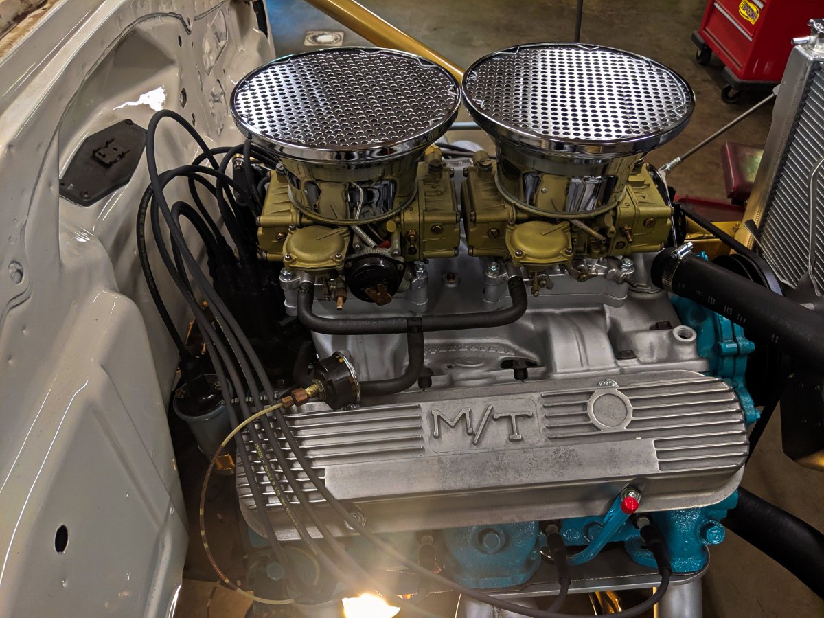

  22. wvenfield
    Joined: Nov 23, 2006
    Posts: 5,671
    wvenfield

  24. loudbang
    Posts: 40,347
    Damn that is a great looking engine.

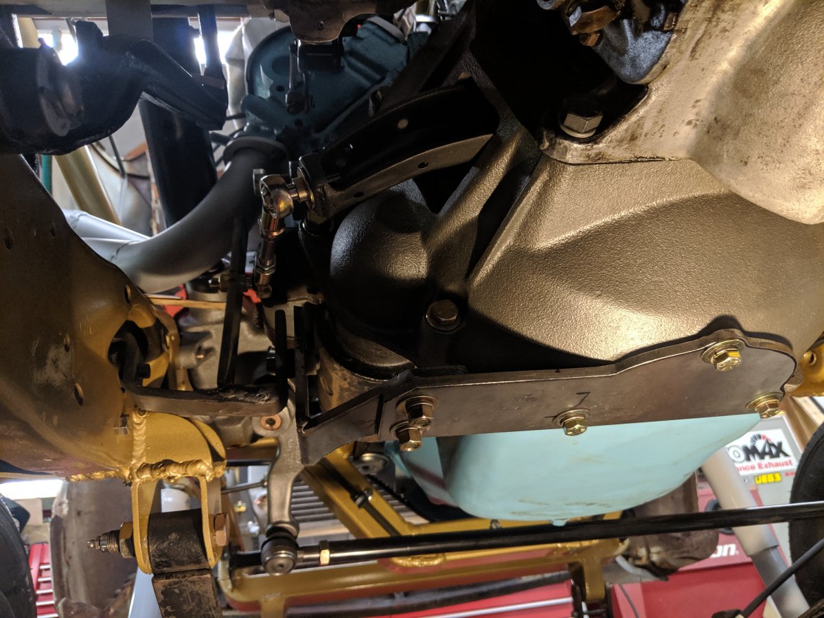

    We have a clutch. 1/2 factory (thanks again oldwolf) and half custom brackets. We need to add a gusset trim a bit and get it adjusted a little better but it works.

    That cantilevered mid mount is very interesting.
    A lot of outside the box thinking in this build!

    Maybe not that interesting but I thought it interesting. I'm taking the radio out to see about putting gauges there........someone hollowed out the factory radio and stuck the new radio in it.

    Sometimes "outside the box" doesn't work. Our bracket was flexing and not releasing the clutch. New design. Maybe not a big deal for many but this is the first time I've ever done something like this so I'm surprised every time something works. LOL
