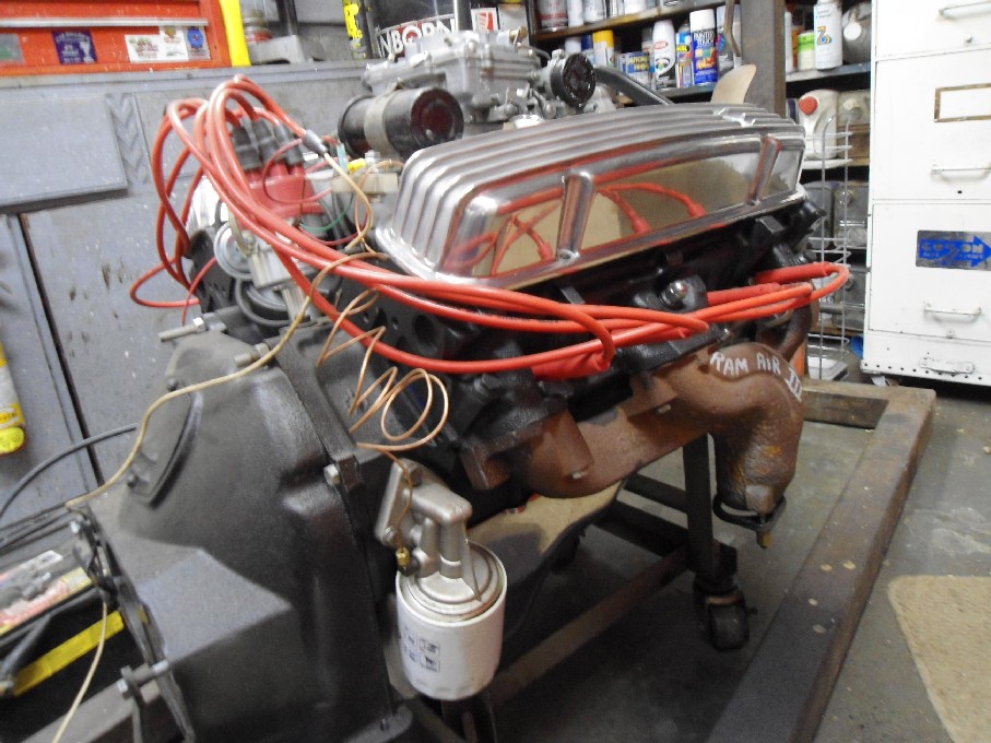

    Instead of messing with changing the cover and having to make rear side mounts maybe try to mount like mine with the later style hurst mounts that bolt to the side of the block and come forward and weld a support for biscuit mounts. Or find some of the 55 chevy hurst frame mounts they should be close enough to try to make work.
    I removed my engine crossmember but this style mount is very strong, There are seperate straps that bolt from the backside of the mount to the head. here's mine
    As far as the clutch goes, manual trans pedals are hard to come by, i'd consider adding a seperate aftermarket extra pedal and a hydraulic throwout bearing set up .
    With the engine mounted higher and off to the passenger side you have a few more options for exhaust. I've ran 3 tube headers this way(no master cylinder in the way, on firewall) or rear exit log manifolds. someone posted on here the early 64-65 gto ram air manifolds also.

    Thanks, i'm running in the 11's with this set up and no problems to date. I made a simple rear bracket that bolts to the x frame for the rear trans mount. Glad to see your taking the car up a notch. My car shows are at the dragstrip....
  9. Here's a photo of those ram-air manifolds installed backwards...and a 59 bell housing. 370onstand.jpg

    Interesting.....yes, I realize the stock manifolds aren't going to work. I'll have 100 questions I'm sure. Honestly I've never swapped where it was anything but unbolt, bolt back in. LOL

    Those certainly look far less restrictive than the stock ones.
