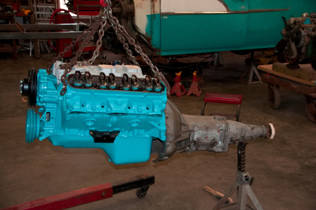

    I'm talking to myself but any suggestions are always appreciated. Put together for fitment. (no clutch etc installed).
    Sitting in appx place. Will sit a little higher which is good for header clearance. P***enger side is no problem as far as motor mount. I'll be using a stock mount and make a bracket. On drivers side..........not quite enough room so I'm thinking using a Hurst type thing except I only need a few inches forward. Steel flat bar attacked to factory mount run a little forward to a bracket on this side.
    The wire mess and firewall will be cleaned up after fabrication. I'm thinking I'm just going to have to buy a generic set of fenderwell headers, a Pontiac flange and cut to fit. I should have enough room with the engine raised to clear the steering box. Around the column might be a little interesting.

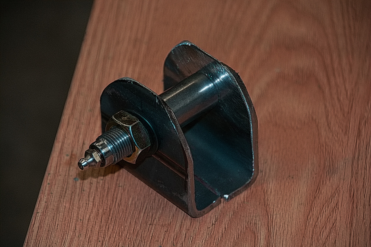

    So, here are the motor mounts. Tomorrow hopefully we will get a crossmember mocked up for them to mount to. Skipped trying to use the factory type rear mounts and just bought a Muncie mount and we are going to make a small crossmember to mount it to also.
    It should go 4 inches or so higher for more header clearance around the steering box.

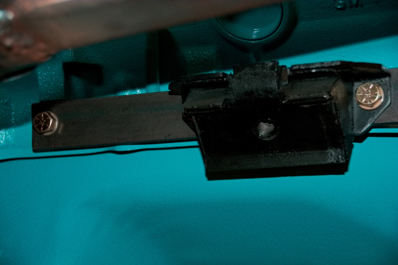

    Rear mount made up. This will mount right in front of the X of the frame right behind the holes for the exhaust. Transmission will mount to it for a rear mount.

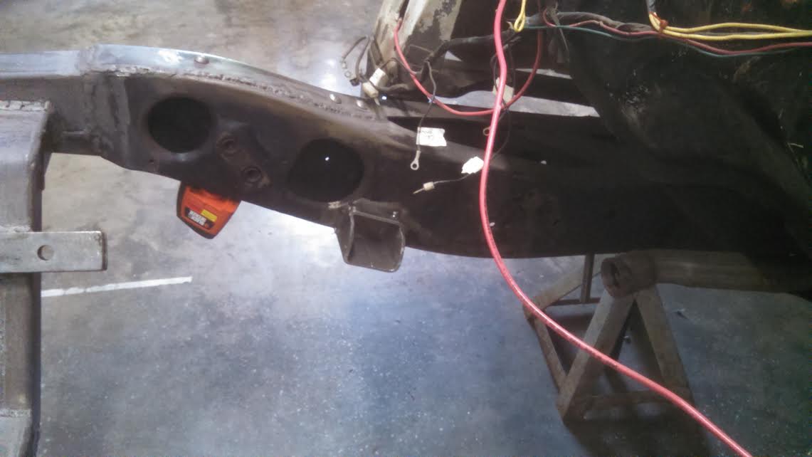

    I haven't updated lately. Front crossmember fabbed up.

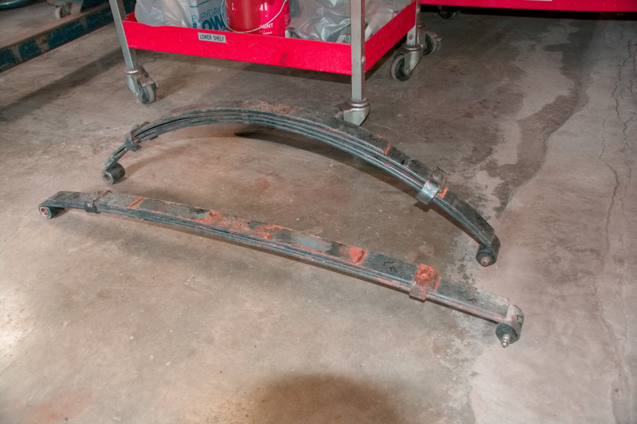

    Any recommendations, I'm listening. I don't really know for sure what I'm doing. Working on the front suspension I figured it better to have the lift in the springs as opposed to perches and shackles so decided to have a go at re-arching the springs.

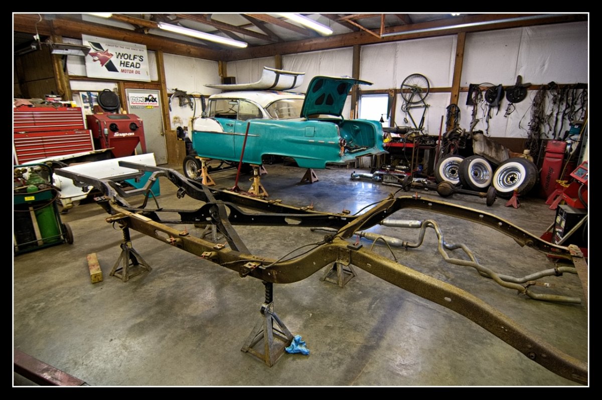

    I was stalled over the summer but finally got back to this. The wheels are just place holders.

    We re arched the springs in a press. Took them apart, marked them every few inches and pressed them. In the end while it worked I had to add a spring to get them to not flatten back out too far.

    Springs turned out good, I had a set of f1 springs I did but they were still a little long even after arcing them. Best advice to those who try to do it is to lay the spring down before and after and trace it out on a sheet of cardboard for referance to keep the springs the same angle.
    But I ended up using the Speedway springs.
