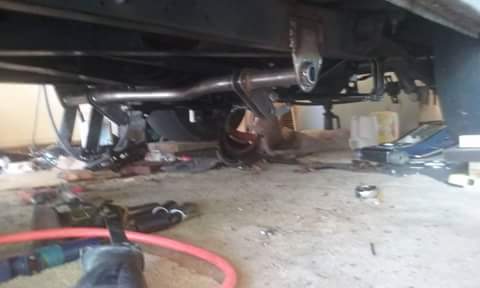

    I'm lazy. I could go look but as I said............are you running ladder bars? I've been wondering about that with the X frame. Just wondering how you did it if so.
    1947knuck and loudbang like this.
  2. 55chieftain
    Joined: May 29, 2007
    Posts: 2,197
    55chieftain
    20170716_125514.jpg The ladder bars are parallel with the ground . I had to make a drop bracket on the outside of the frame to mount the crossmember for the ladder bars, a few inches below bottom of frame. You would have to have a really lowered car for the bars to be anywhere near the x frame. Also would need housing floaters on the rear end if going ladder bars.if you make my pic larger can see how far down they are

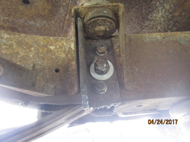

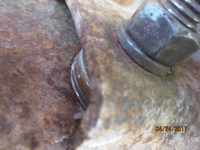

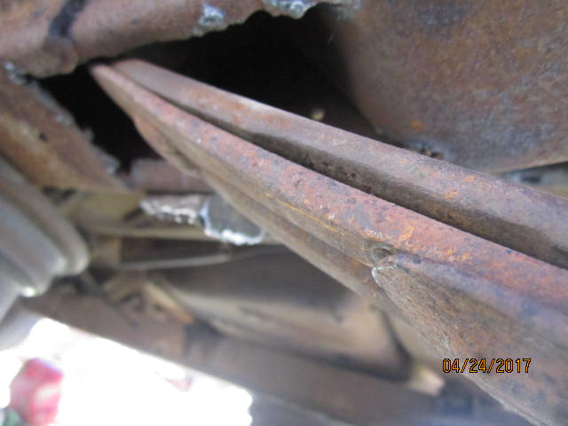

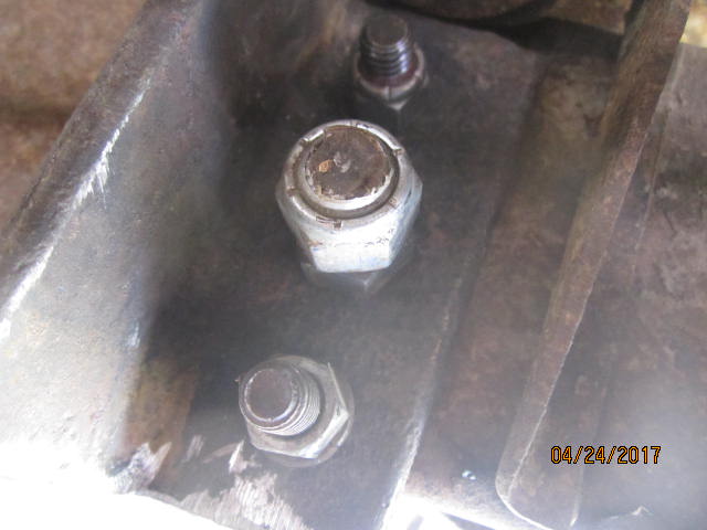

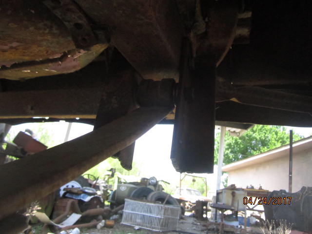

  3. I relocated the springs in line with the frame on my 55 chevy wagon. all it took was a torch. long bolts washers and rear shackles made from angle iron. I didn't need any kit. I did what they did to the Project X 57 chevy. N spring pockets 001.JPG spring pockets 002.JPG spring pockets 003.JPG spring pockets 004.JPG spring pockets 005.JPG ow the tri fives have a boxed frame that's pretty stout.
