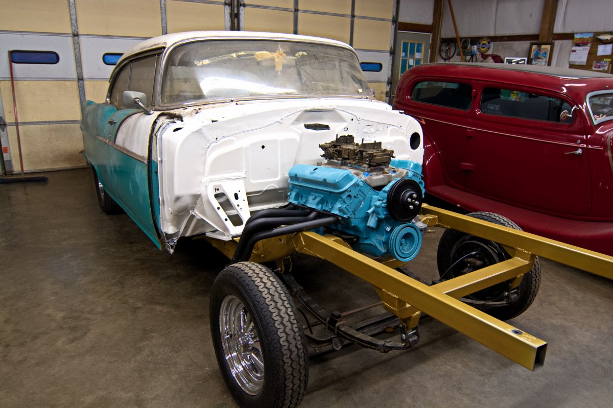

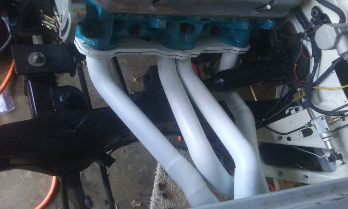

  1. Okay, sure. In that case, use a single center (three tube ) header ,and massage it to go around the front of the box, and down..Never know the difference. Center two are joined inside the head anyway, so no benefit from 4 tubes.

    Get those Chevy headers, then j bends in your tube diameter. Cut tubes and move them where they need to go. This is the left side header from my 55 stude with a big block Buick. No. 3 and 5 had to go around the steering box, went outside the frame, then back underneath to meet the collector. Used slip joints to get it off and on.

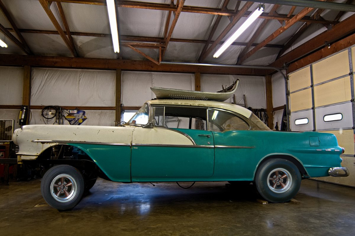

    I'm thinking long term........Everything snowballs. The firewall looked so good that I said. "let's paint the rest of the white as it's pretty shabby". Plans are for now to maybe cut the wheel wells. Long term buy a set of 55 Nomad wheel well panels.

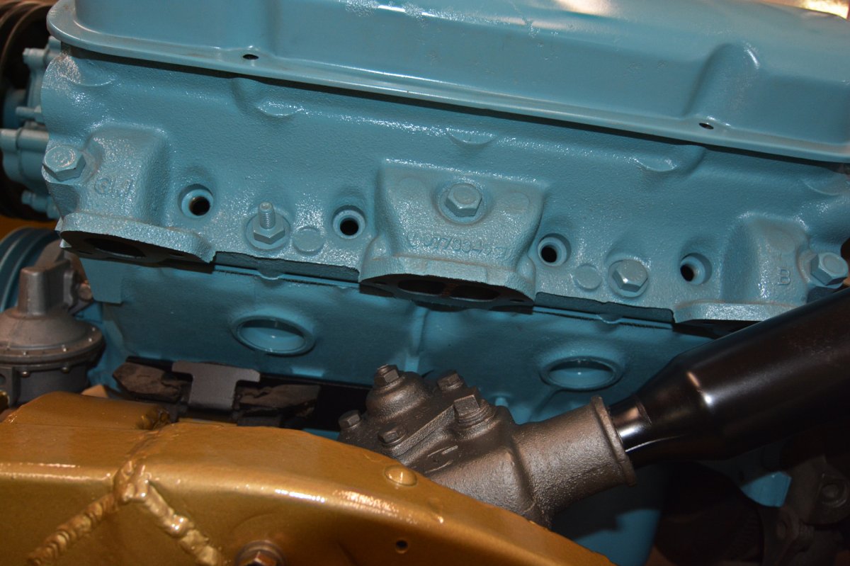

    Do you have anymore close up pictures of the motor mounts and headers?

    I will get better pics of the motor mounts. There are some of them being made earlier in the thread. Those headers are just sitting in place at the moment. I will post pics as we adapt them to fit.

  12. Mike Colemire
    Joined: May 18, 2013
    Posts: 1,431
    Mike Colemire
    This is going to be a sweet ride. That gold frame looks good.

    wvenfield here is what your car could look like with '55 Nomad fenderwells. Not to scale but hopefully close. It would make it a whole lot easier if you had to pull the wheels between rounds. Changed the shoes too. 2 56 Poncho wvenfield Nomad  F-well n new shoes.jpg

    Thank you! Thank you! Thank you!

    I would go with the Nomad, Safari skins. Just looks better.

    That's what I am thinking.

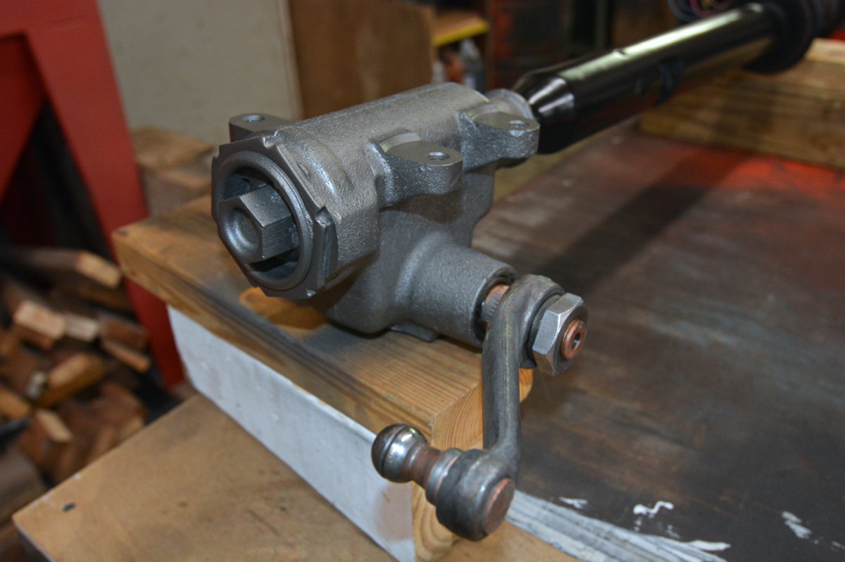

    How are you hooking up your steering to the pitman arm with the ball stud still on it? I cut the backside off where it's peened and pressed it out. 5/8" bolt fits nice and used the speedway draglink on mine.

    Not sure how either, unless you can get the speedway drag link with a heim joint on the pitman arm end and tie rod for the other .
    1947knuck and loudbang like this.

    Pulling the ball right now.
    P.S. the Nomad ran 7.23 in the 1/8.
  30. wvenfield
    Joined: Nov 23, 2006
    Posts: 5,646
    wvenfield
    Ordering a drag link.........will work fine and better yet, easy. Should have plenty of room for center pipes. I have a hex plug to replace the one that is there. Will have to do the under the column slip pipe on the back but.........I have a guy that said he would waterjet me a pair of flanges.........I'm thinking I will let him cut some body bushings also.
