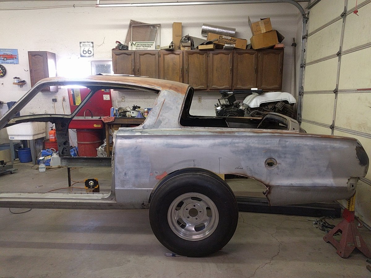

    One thing I regret about the 55 Chevy I had, was not using that 64 Pontiac rearend I had, and cutting the quarters to make the tires fit. Oh well.
    I'm doing my new car right....but I used snips to cut the quarters.

    If the quarters were rotted or it was a Chevy they would have already been cut.

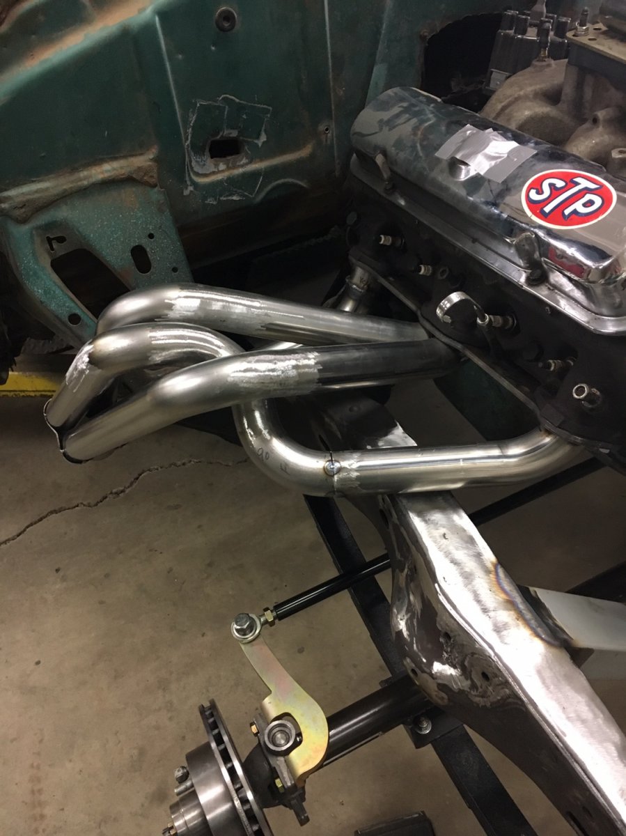

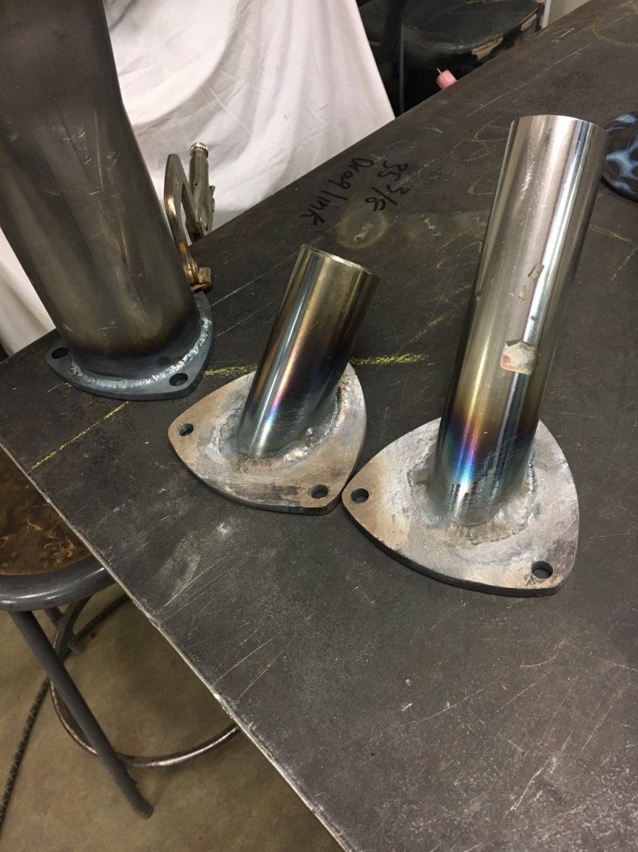

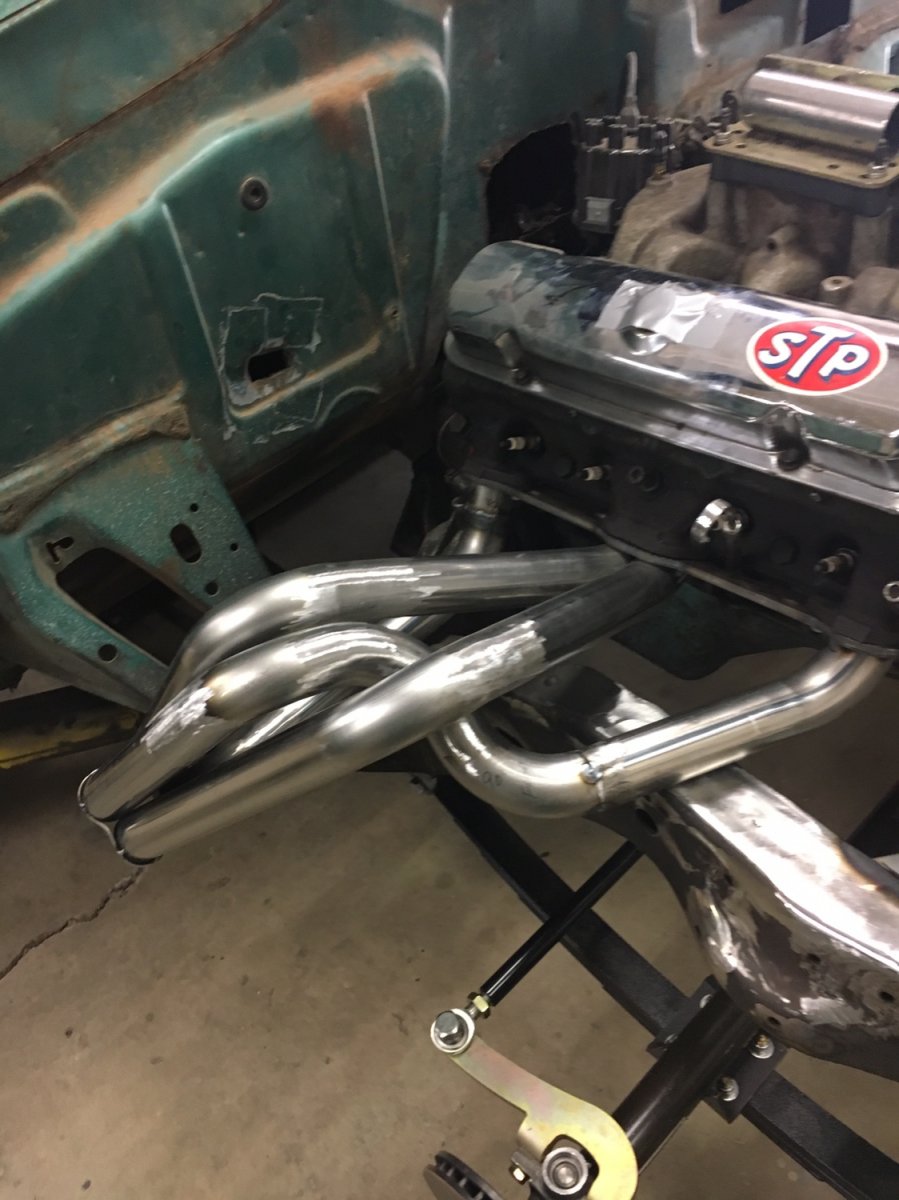

    Been having trouble getting on the H.A.M.B. Over the weekend we finished up the p***enger side header and made some caps with stubs so we can run a full exhaust a very small portion of the time. 99.99% of the time this car will be driven will open headers. But trips like dragweek, I'm going to want full exhaust. Welded up the one header last night. Stuff for my draglink showed up today and I ordered the cage after I got home from work.

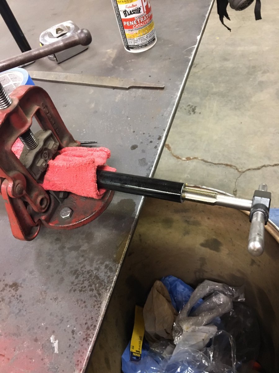

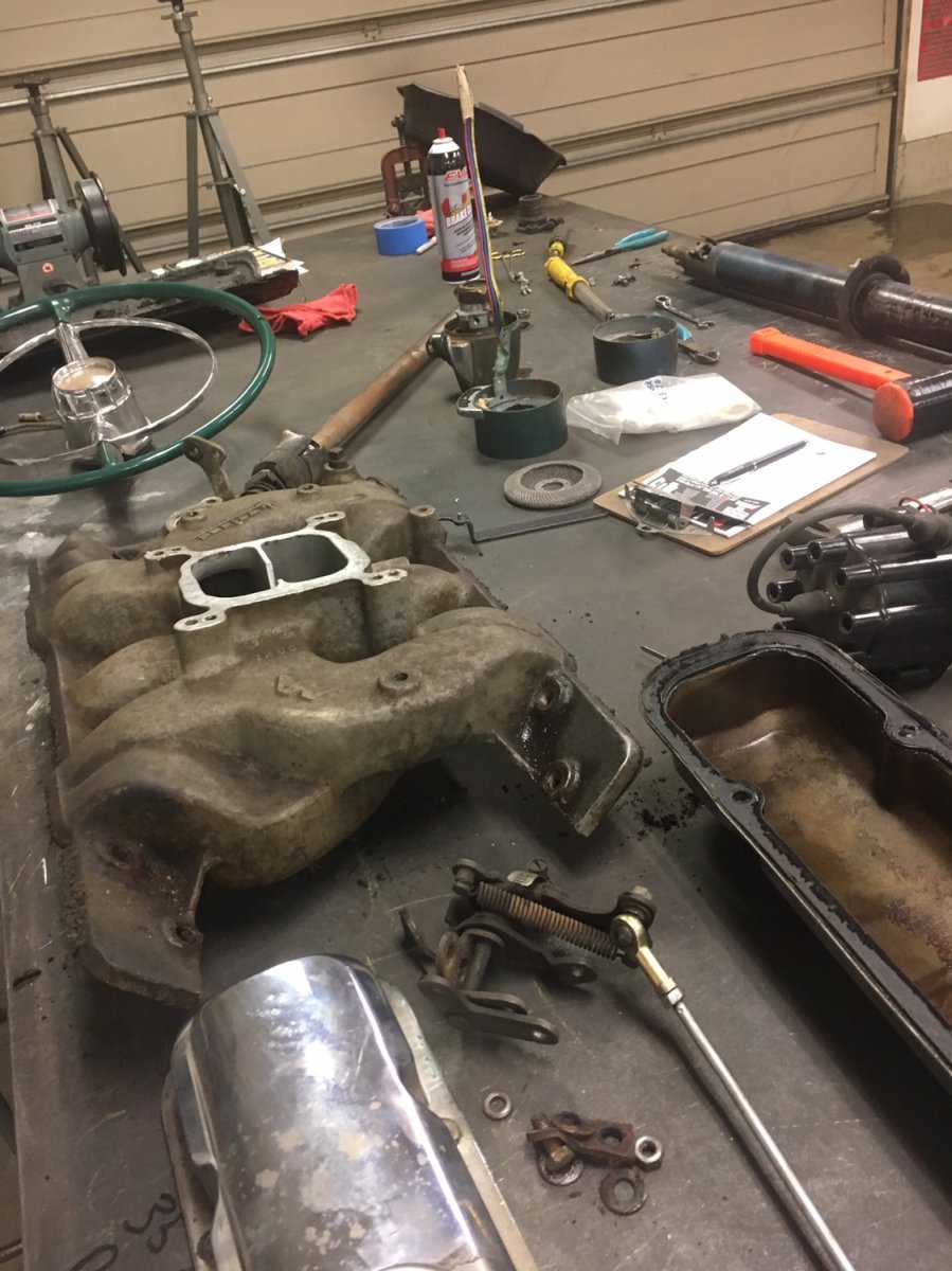

    Draglink parts showed up today. Cut it to length and retapped the threads. Checked all our clearances for travel. Now we can pull the motor and trans back out and send them off to have them gone through. Weld up the driver side header, finish cleaning up the frame and start working on the interior panels. Ordered the cage today and will pick that up in a few weeks.

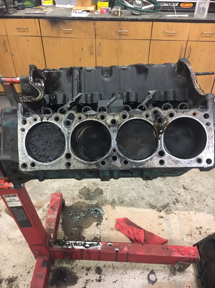

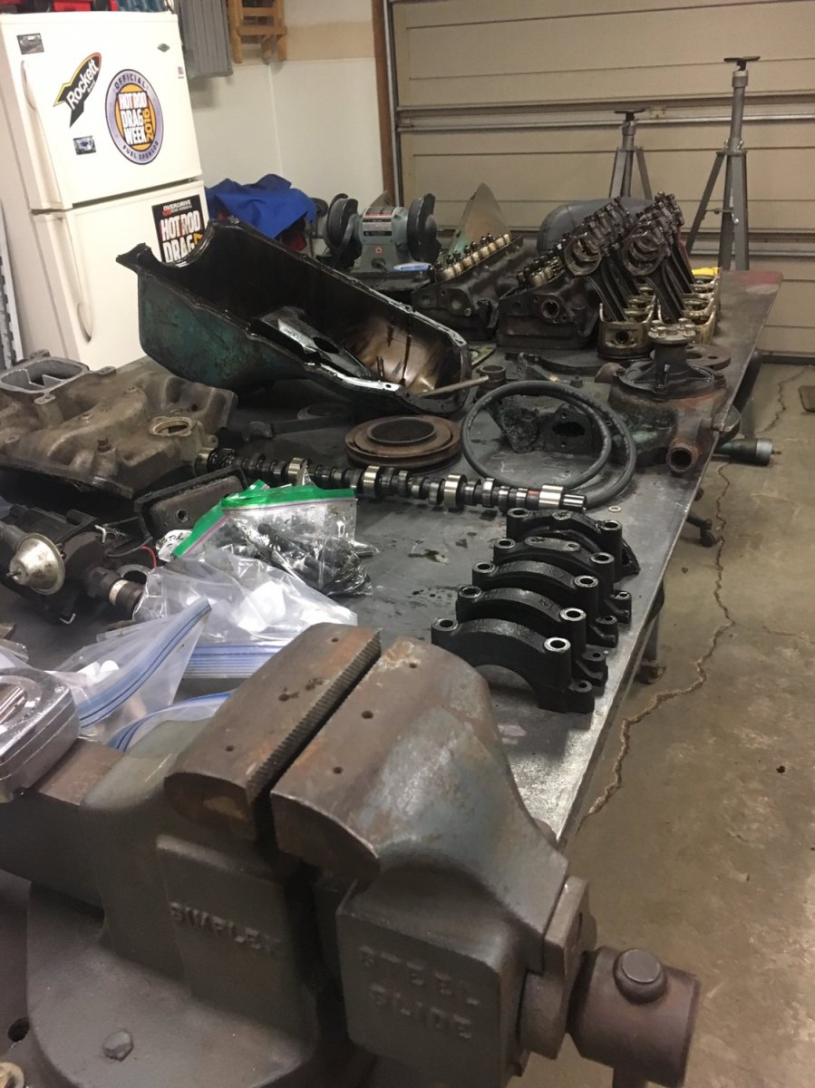

    Had a good progressive day today. Got the steering column and wheel out, pulled the drivers header. Got the motor and trans out. Started tearing the motor apart and got it ready to be sent off for machine work.

  13. I like that you are using the early engine with the reverse cooling. the 59 389's had what where nicknamed rubber rods. the Rods are stretchy. You might want to check that out.

  15. squirrel
    Joined: Sep 23, 2004
    Posts: 60,039
    squirrel
    Head gasket was sketchy between the middle cylinders, eh? lots of heat there
  16. D-man313
    Joined: Mar 17, 2011
    Posts: 1,172
    D-man313
    Could be, every Pontiac I see the heads discolor pretty bad there in the middle. Don't know why.
  17. squirrel
    Posts: 60,039
    squirrel
    Because the shared exhaust port is right there! they get hot
    62hotcat, Gammz and D-man313 like this.
  18. Suggest an extra 5 lbs. of torque on center two head bolts.
    loudbang and tomschev2 like this.
  19. Poncho60
    Joined: Jan 23, 2011
    Posts: 281
    Poncho60
    from N Illinois
    That's the exhaust crossover...not a head gasket or bolt torque issue. Everything correctly installed...it still happens.

    Glad to help, your doing some great work. There is another coolant hole between center cylinders in block and heads that the 421's used. Some guys like to do that mod, some of the headgaskets have that hole in them and use that for a template.
    saltflats and Bowtie Coupe like this.
  26. I wonder if the factory prepped GTO 389,s with the 421 heads used that coolant hole?
