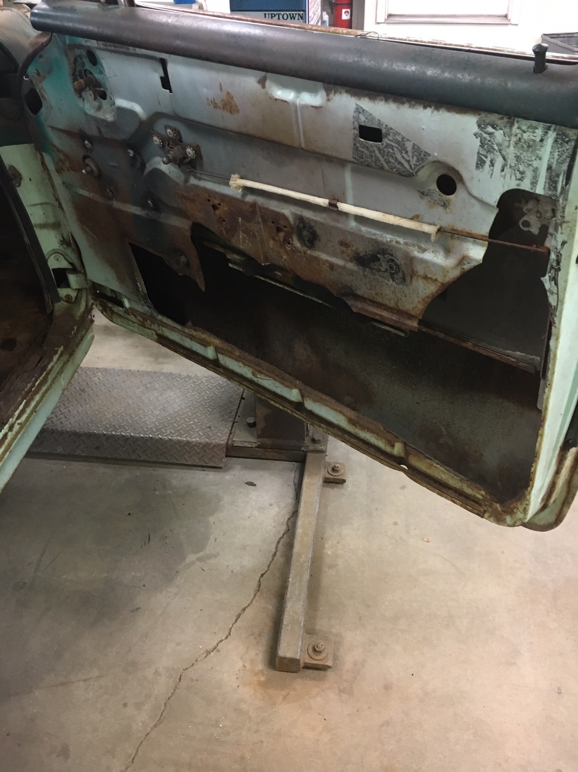

    Picked up the cage kit this morning we'll see if it fits! Have some other stuff to do before we get started on the install.

    Yes I'm planning on building a shield out of some 3/8" plate I have. As well as shielding the trans also inside the tunnel.
