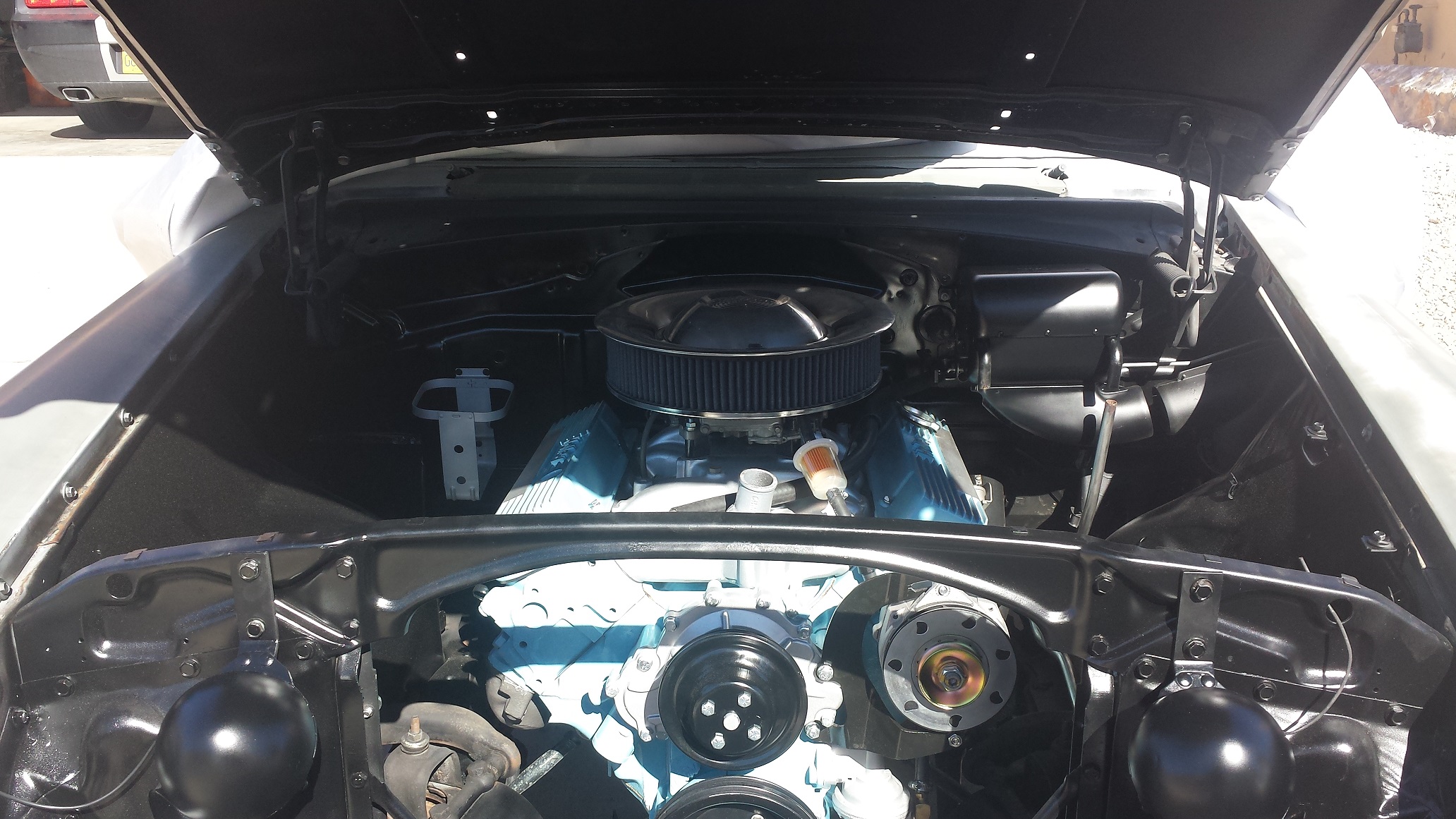

    Good looking build. Like the Pontiac in a Pontiac . BUT looking at the angles of the mounts on the motor ,with the rod ends being able to rotate ,what will keep the motor from rolling over?
    just asking.
    rtp
  2. 56PonchoWagon
    Joined: Feb 21, 2013
    Posts: 82
    56PonchoWagon
    from El Paso TX
    The rods won't be able to move once the jam nuts are all tightened down.

    Just my opinion but I'd probably add something horizontal off the mount over to the frame for extra support so your support you've built isn't doing all the work.

    Are you saying the rods are not strong enough to hold the weight of the engine?

    I think what he's saying is that with a rod end on both ends of your mounts, the engine could possibly rotate on its axis.

    Maybe ok for the weight, but when the engine is under load it's going to put more stress on the parts. I'm not an engineer and not trying to nitpic your build, but i would make it stronger and adding an extra support would do that .

    Oh I see. No the rods are sitting at 45 degree angle in the engine bay so in order for the engine to rotate the rods would have to grow on one side and shrink on the other. After I stab the engine back in I will take some better pics.

    I'm with some of the others, I think you have a problem with the tie rods and Heim joints. With neither side being rigid, the engine can rotate. Here's a quick little CAD drawing showing what we mean. The left side (Good) has the engine in the frame with the tie rods at 45 degrees. On the second (Bad), I rotated the right side tie rod by 20 deg, moved the engine so its right mount matched up with the end of the tie rod, then rotated the left side tie rod and engine to where their new intersection would be. The length of each tie rod did not change - all I did was rotate parts around.
    So unless we're missing something, you may want start over on those front mounts.

    Interesting, I will stab that engine back in this week some time and test it out. If it turns out to be a problem I will keep the mounts but they will just hold the weight of the engine and I will modify some bellhousing mounts to solve any rotational issues. I originally went with that setup to keep the mounts as small as possible in the engine bay so I would hate to change to the much larger weld in pedestal or "biscuit" type I have seen on others.

    When you take it out for the first time,stab the accelerator pedal,,if you are going to have a failure with the motor mounts that will be the best test. HRP

    Well I finally got around to mounting the engine and trans in the wagon and thankfully it is rock solid! Not one millimeter of movement, really dodged a bullet there. 20140928_124158.jpg 20140928_124211.jpg 20140928_124233.jpg 20140928_124248.jpg
