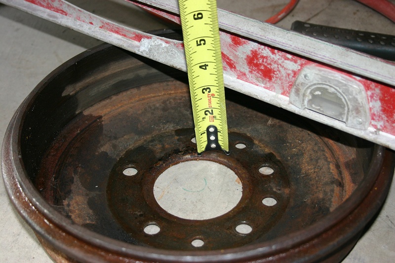

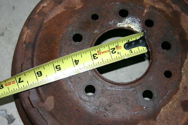

    I need to know where the best place to get rear brake drums for a 1956 oldsmobile..or what other car i could use the drums from...the bolt pattern is a 5X5 and i measured the inside its 11 inch across and 3 inch deep and has a 3 inch hole for the hub...i pulled mine and im pretty sure they are shot...thanks

    hollander manual says 54-56 interchange, olds only. max turning diameter is 11.06"

    thanks johnevans...so basically i just have to find a vehicle that has a 5X5 lug pattern with drum that is 11.00 across right...or is there more to this that im missing?

    A LOT more involved than just the diameter!! Center hole dia., overall depth ,brake face width and the area where it meets the backing plate. Save yourself some grief and just step up for the correct new ones. Old cars ain't a cheap hobby sometimes.

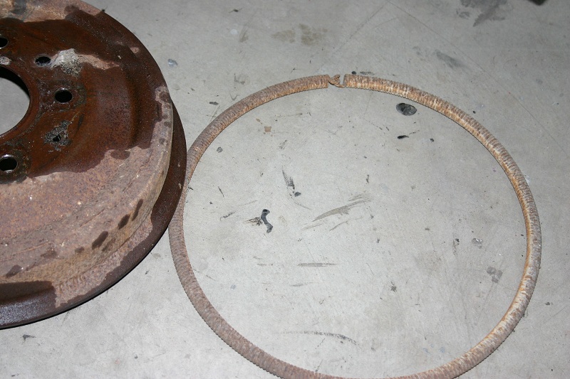

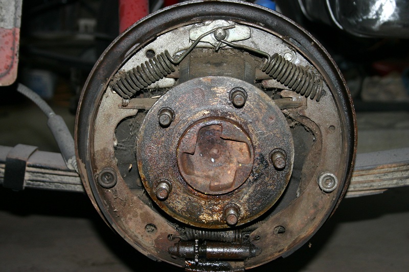

    I think i will do that..pop on off and head on down to napa..couldnt hurt..and while its off take it to see if anything is left to turn..my gut feeling is NOT...it has some deep grooves and a nice lip formed on the backside...just curious what is that spring circle that was on the p***engers side drum for? and look at what i think is the parking brake link..it got all jacked up..i will have to find somewhere to get one..or have to make one:mad:

    Spring is a anti-noise damper and also does a bit for cooling.

    Drum with spring is probably a OEM as I can't recall any after market drums that I ever sold having them. They were know to rust etc and fall off.
