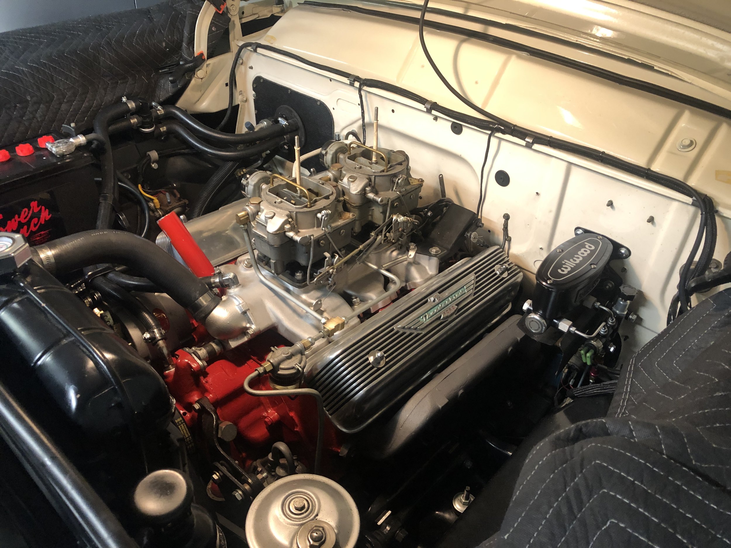

    They work well with add ons too. This 292 doesn’t have much chance of ever leaving our 56 Victoria. IMG_4522.jpeg

    With the right set of pipes there are a rare few engines that sound as good as a Y block. Jimmy Six's engine shows that they can be dressed up and taken to town too.
