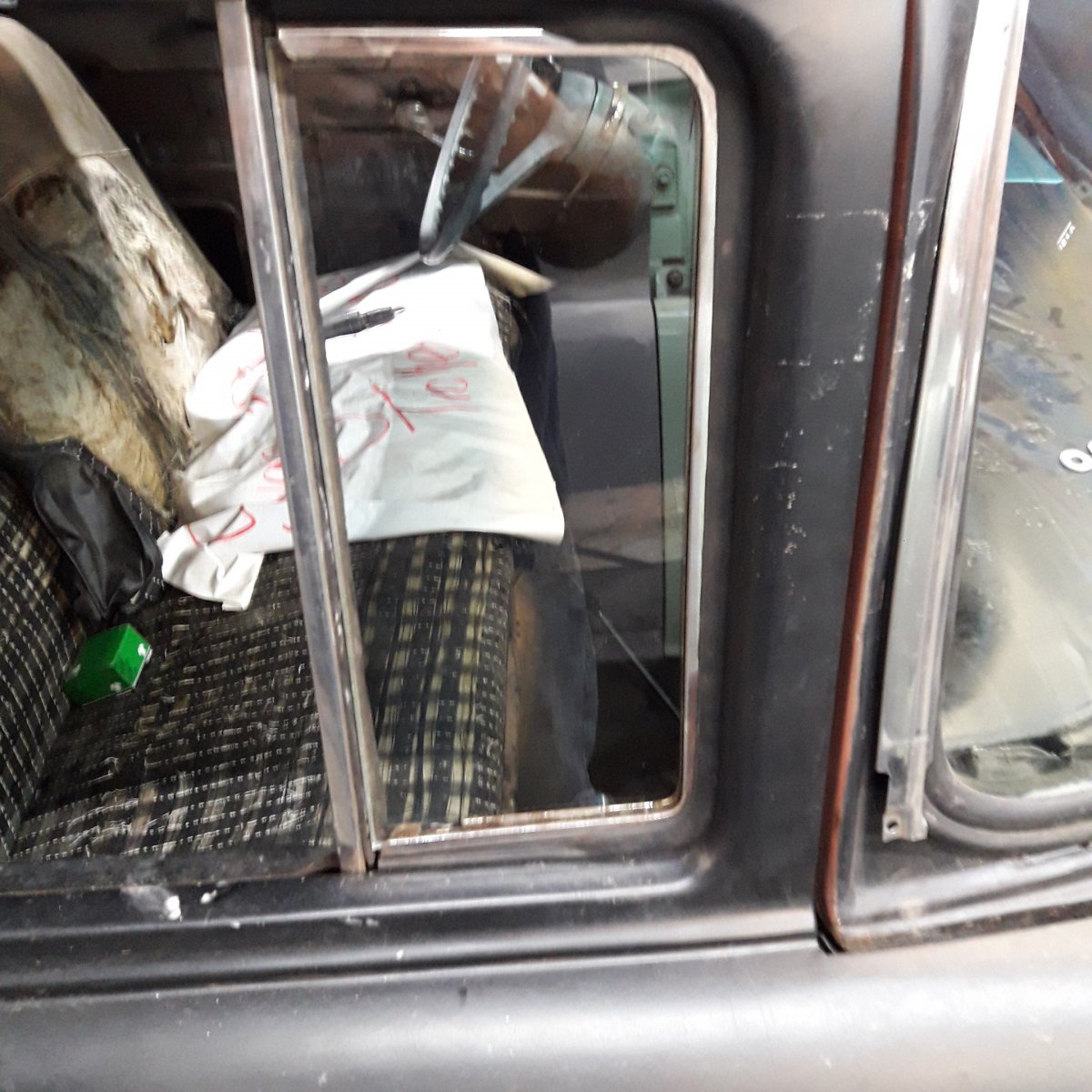

    Your choice when it comes to installing the glass. On something like a model A windshield i use black silicone, because it's encased in the flame, and if you ever need to change the glass again you'll be able to get it out. But on a piece like a wing window i use windshield urethane. If you have to change it you just break it and clean the channel out with a screwdriver :D 20200130_210836.jpg
  11. Lloyd's paint & glass
    Joined: Nov 16, 2019
    Posts: 10,506
    Run a bead around the channel, and press your glass in! Get you a pair of rubber gloves first lol. A handful of single edge razor blades, and clean the squeeze over off of the glass. I spray the glass with window cleaner first to keep it from spreading. Not as bad as it sounds. (Note that i didn't glue this, I've gotta fix the latch first and i gave up for the night) 20200130_211531.jpg

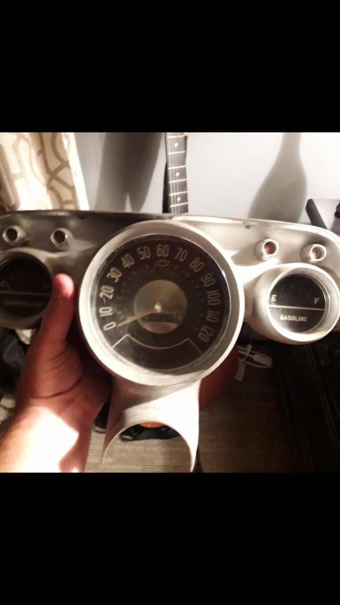

    Got my gauge cluster today, thanks @tyeager55 ;) once again my genius UPS driver took it to the old lady half mile down the road :rolleyes: she sure gets a lot of hot rod parts :D Screenshot_20200203-200455_Gallery.jpg

    :D UPS="Uncaring Package Service".

  30. hotrodjack33
    Joined: Aug 19, 2019
    Posts: 4,767
    hotrodjack33
    Priority 1...install gauge cluster.
    Priority 2...start car.
    Priority 3...try to get the needle all the way to the other side of speedo:D
