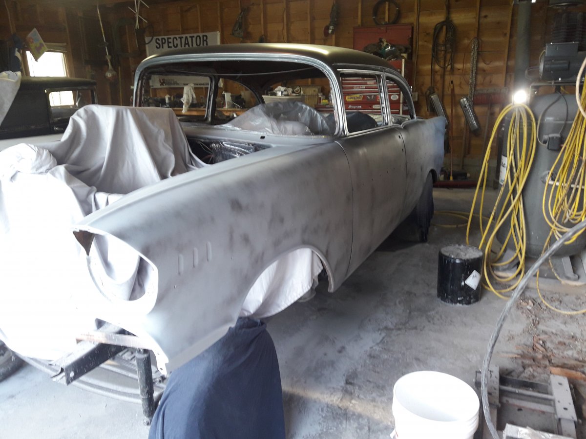

    Oh we'll be there! The reunion is my favorite, never miss it. I'm building a 56 9 passenger for a customer at the moment and it got me wanting one. Seems like I've had so many tri 5's in my shop this year, i had to get involved lol 20190424_185629.jpg 20190424_185629.jpg View attachment 4487716 20190805_125706.jpg

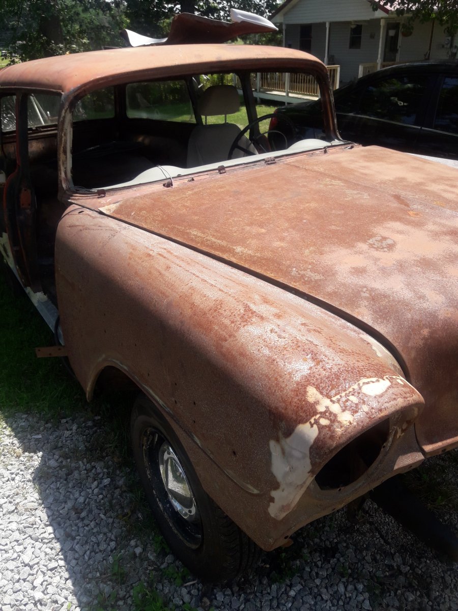

    Oh and if you ever wanna remove rust from those pesky panels that someone stripped and left in the rain before they brought it to you.... POR-15 metal prep. Bout $15. Take a red scotchbrite pad to the panel and blow the dust off, the spray it, k 20190805_125714.jpg eep the panel wet for about a half hour, meaning you go back every 5-10 minutes and respray them. After that just let em dry about 24 hours, wipe them down with a wet towel and dry, blow them dry, and put a coat of epoxy or dtm primer on them and go to town!
