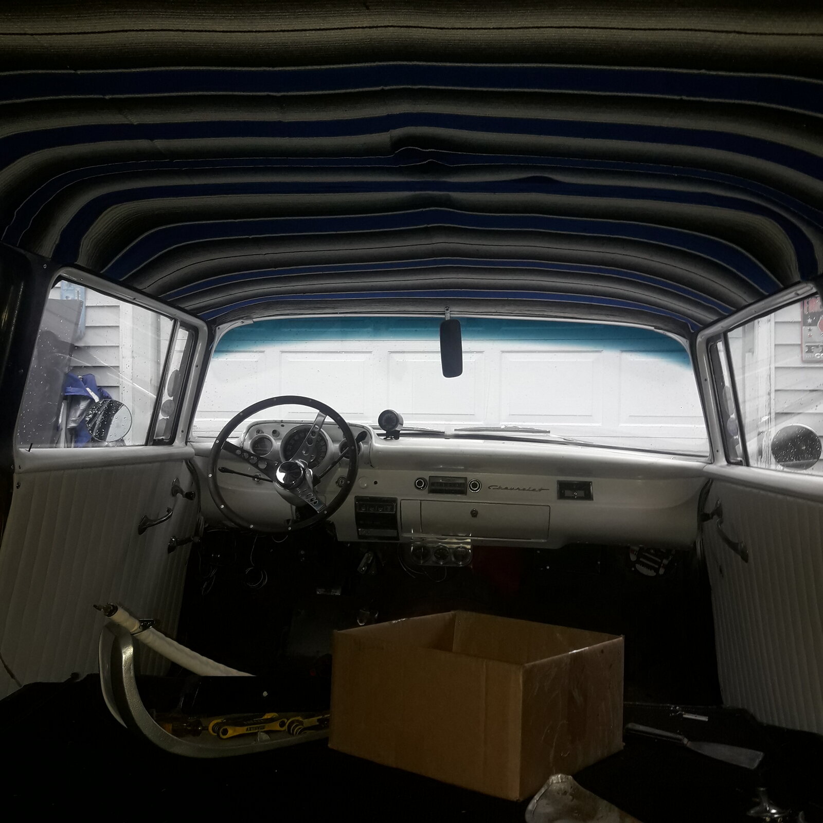

    How is your temporary headliner fitted into place? I have nothing in my '57 and that looks better than nothing by far.

    First, order the HUGE Mexican blanket from Amazon, think it was about $25. Lay it out lengthwise and mark center. Pull the garnish moldings, find center and mark it on the front brace, center brace, and rear brace, in the wagon there was 4. Get a couple of spray cans of headliner adhesive, i use sprayway 92. Spray the front brace, and about 4" of the front of the blanket (headliner) stick the center, then pull to the side and rub it down, repeat on the other side. Then repeat as you move rearward. Then stick the sides, and tuck in the door areas, install the garnish, and you're done :D I'll put a perforated white headliner in it eventually, or the next owner can, but for now this will keep the heat at bay next week ;)
