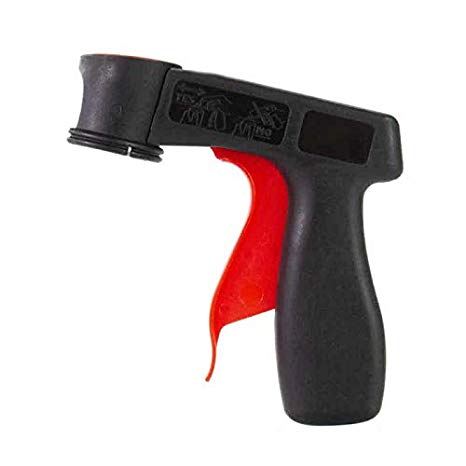

  23. If you're gonna use 40 cans you need one of these:rolleyes:
  24. Lloyd's paint & glass
    Joined: Nov 16, 2019
    Posts: 10,495
    Too late buddy, already got one :p but im going to go with the white :D
