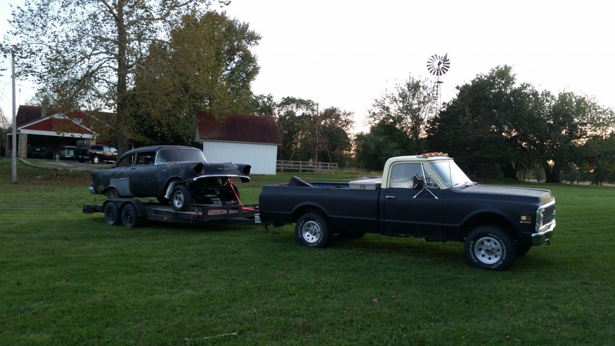

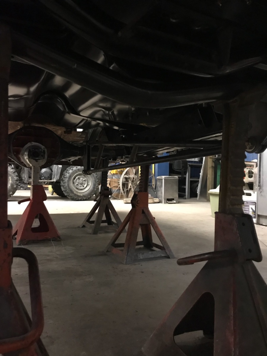

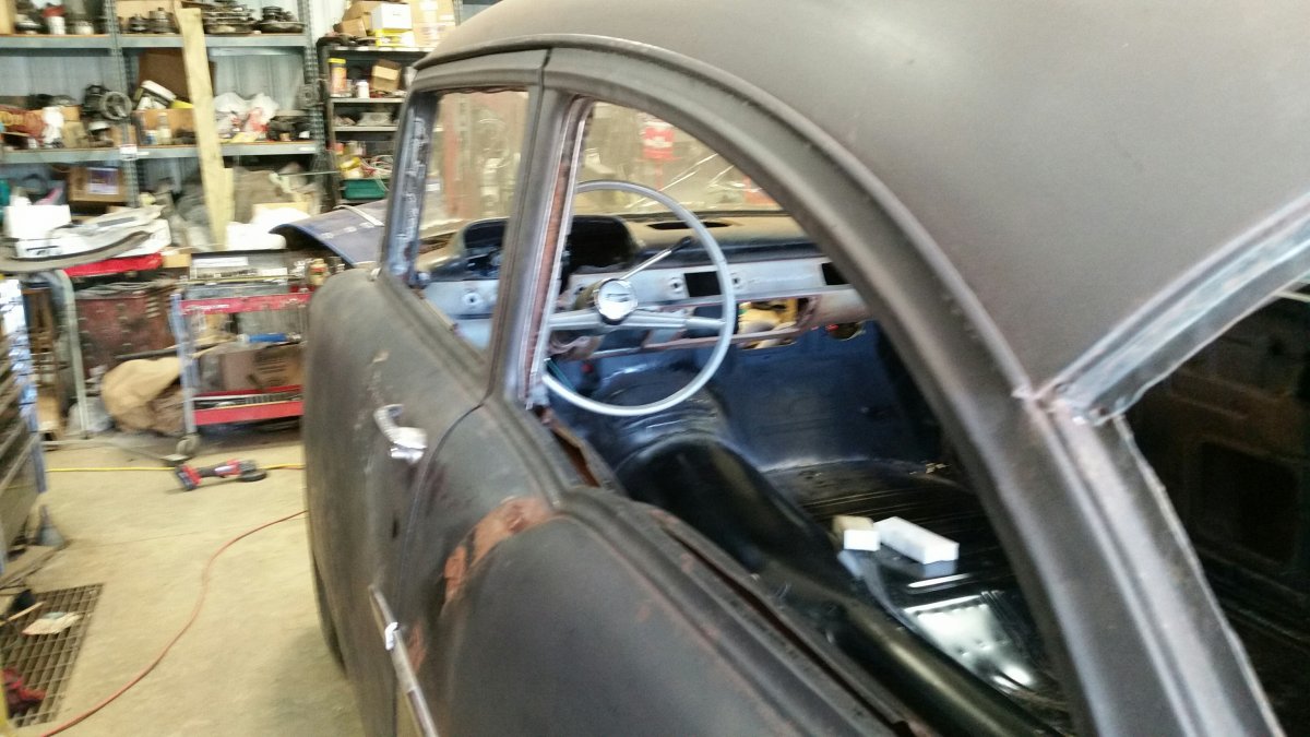

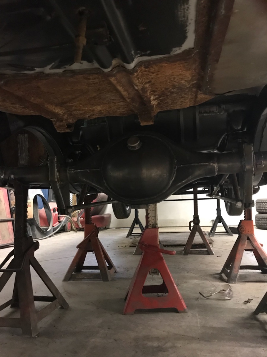

    Married the body with the new straight axle ch***is last night. This body came as a parts car with some other 57's we bought a few years back. When we got the body it was not on a frame just sitting on the ground on the floor pans. It was deemed unbuildable by many, but a few hours patching toe boards, inner quarters, trunk floor and sidewalls, and a new one piece floor and the car is complete once again. I went with the theory that it doesn't have to be pretty, or even right, just as long as it's solid. Who knows how long it has been since it has sat on a frame or rolled?

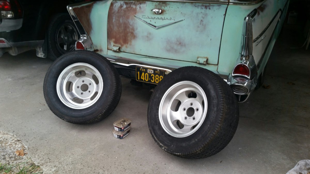

    I did a little mocking up last night to try and determine what wheel and tire size I need to go with as well as rear end size. I initially tried my 15x10 slot pictured earlier in this thread with a used 28x10.5x15 slick. It was obvious that to use those the wheel well would need to be radiused. Although that is the right thing for a g***er I cannot bring myself to cut mine. So the second thing I tried was my Dad's 15x7 slot with the same slick, that is the setup seen in the attached picture. I really like that look, very similar to the blue and white 210 pictured earlier in the thread. So I am currently looking for a set of 15x8 or 15x8.5 slots in good condition. If anyone here has any that they would like to get rid of let me know.

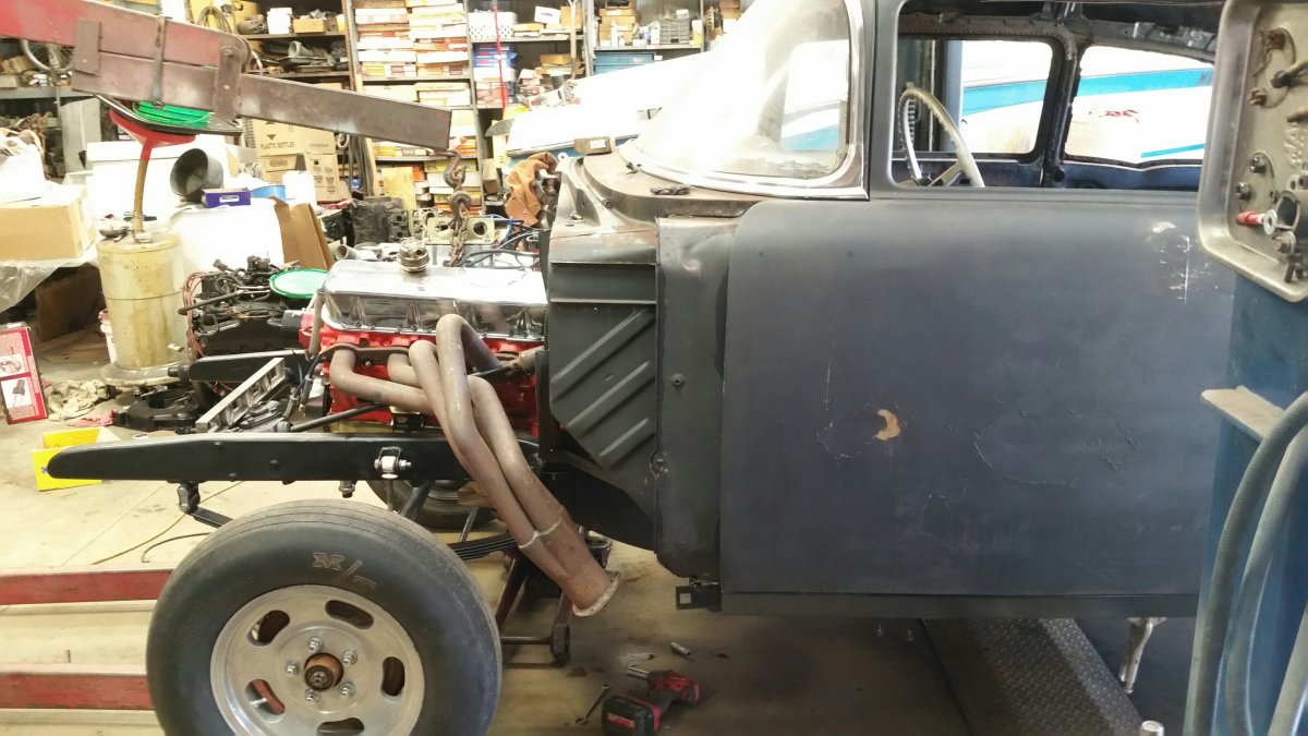

    Good news and bad news. Good news is that I finished welding the floor in on Friday and started the engine and trans mockup. Fooled around with that a little until I was happy with it and welded the motor mount cradle and trans mount brackets in place. Monday night I pulled the motor and trans back out to finish all the welds on the mounts and I was going to clean and paint the engine and drop it back in. I starting draining the oil so I could pull the pan to paint it and install my new one piece oil pan gasket and what came out was not pretty. I have a magnetic drain plug and there was lots of metal on it, including some thin shiny slivers that I am not sure what they are. Basically at least looking at an engine freshening if not more. My budget that was stretched thin is now completely busted. I am thinking about putting my motorcycle up for sale and using those funds to fix the motor, but it depends on what I find when I get it apart.

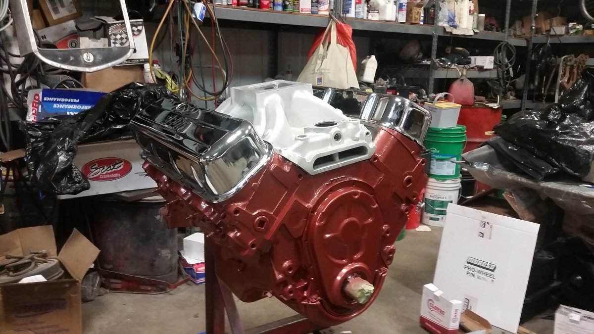

    Well After a very busy summer with no updates I need to catch everyone up with what has been going on with the g***er build. After finding the damage to the engine it really set me back, but I was able to build the motor the way I wanted. I decided to build a 496, I bought some rectangle port heads from my Dad that he had actually bought from @Deuced Up! off the Dragnasty Austin's first build. I also bought some new CP custom pistons thanks to @Panneton Bros. Racing. I had a 6 week wait on the pistons since they were custom order so it was mid July before I was able to pick up everything from the machine shop. I have not yet had the time to ***emble the motor yet and I still have to purchase my new solid roller cam and lifters. The motor build took all of the money I had set back to buy a rear end and have the roll cage built. I could of came up with the money if I needed to, but I didn't hear from the ch***is guy all summer and I didn't bug him since I really didn't have the money. I also mentioned in this thread selling my motorcycle to fund the car, well after advertising it all summer I finally sold it Saturday. The new purchaser was barely out of the driveway and I was dialing up the ch***is shop, supposedly he will get to me in a month, but I have heard that before. the last update I have is I found and purchased a pair of 15x8.5 slots this past weekend which I am pretty happy with. Still undetermined what I will do with all the wheels, might put slicks on the 10s and use the 8.5s for street tires. 20170827_170852_resized.jpg 20170828_200339_resized.jpg 20170828_200349_resized.jpg IMG_20170721_085459[1].jpg

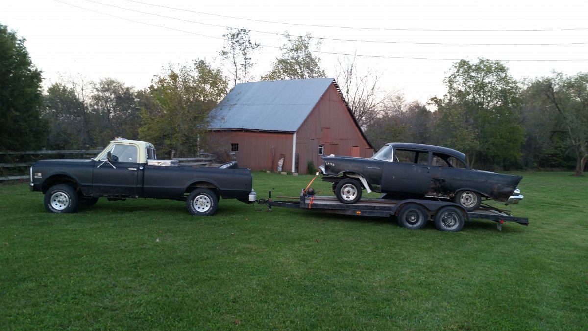

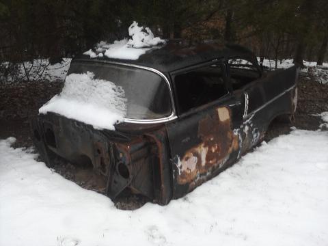

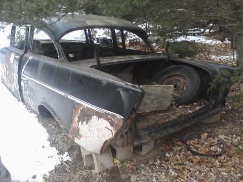

    I recently dug out an old cell phone of mine to find these two pictures. I took these the day I first saw this car, December 2012. I am not sure how long it had been sitting here like this. When we lifted the body up part of the floor stayed on the ground. My dad and I debated back and forth for while what we were going to do with this car. In 2014 Dad bought a better black 57 150 2dr and we decided to part this one out and we sold the trim off of it. In 2016 I decided that I was brave enough to build it and began the process of collecting parts back for it. 0105131217.jpg 0105131218.jpg

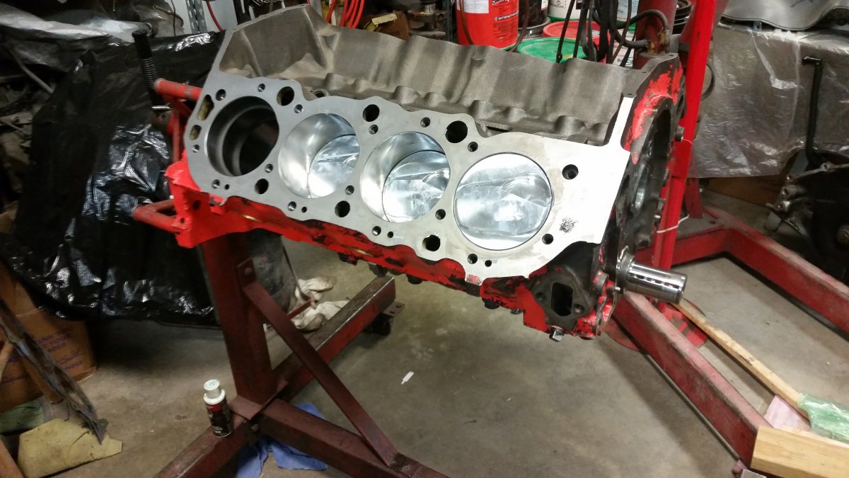

    Engine is finally coming together. I did some preliminary work Monday, checked clearances, checked ring gap, filed the rings. Last night I started ***embling, I got 6 slugs installed before I ran out of steam. I am really happy with how everything is fitting and coming together. Can't wait to hear and feel this thing!

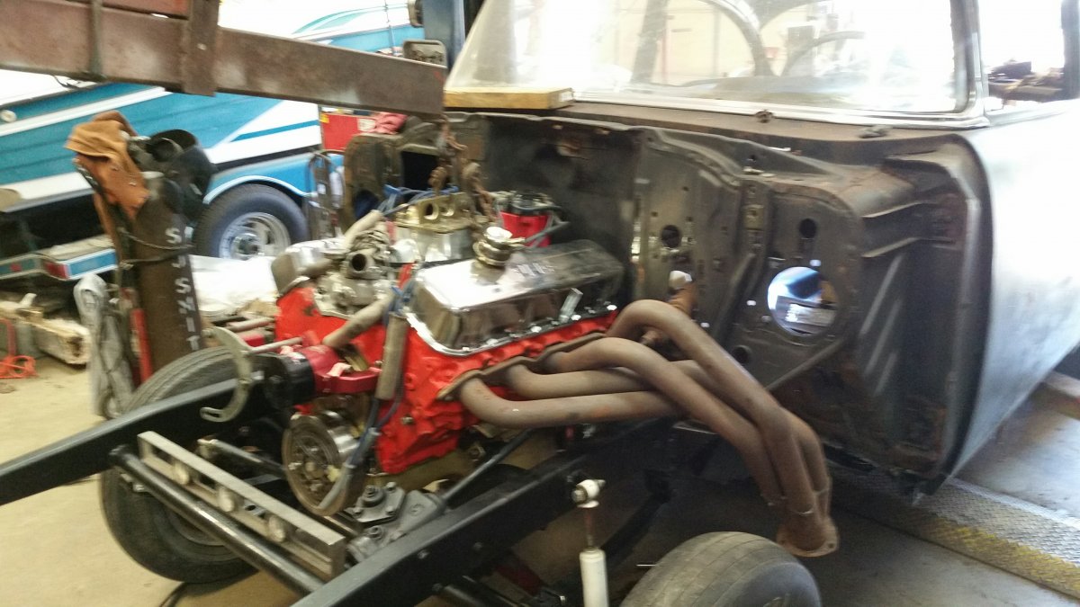

    IMG_0349.jpg IMG_0351.jpg IMG_0369.jpg IMG_0370.jpg IMG_0372.jpg IMG_0371.jpg
  27. malibumonte78
    Joined: Nov 17, 2011
    Posts: 302
    malibumonte78
    It's Back!!!!
    That is right, I got to pick it up this weekend. Roll cage and ladder bar rear suspension are finished and he did a great job. It feel great to have it back in my shop. I have lots to do to have it ready to race this summer, but I am ready to do it. First on the list is clearance the firewall and get the engine and trans installed. I am going to work on all of the things that can be done without making any big purchases, because my g***er fund is depleted for a while. I have some bodywork to finish up. I have everything I need for brakes so I will get them installed and plumbed, plumb the fuel system etc. It is sitting a little lower than I envisioned so one of the first things I am going to do is adjust the rear ride height some.
    20180317_162552.jpg 20180317_162611.jpg received_10212168189341833.jpeg received_10212168190101852.jpeg 20180317_175848.jpg
