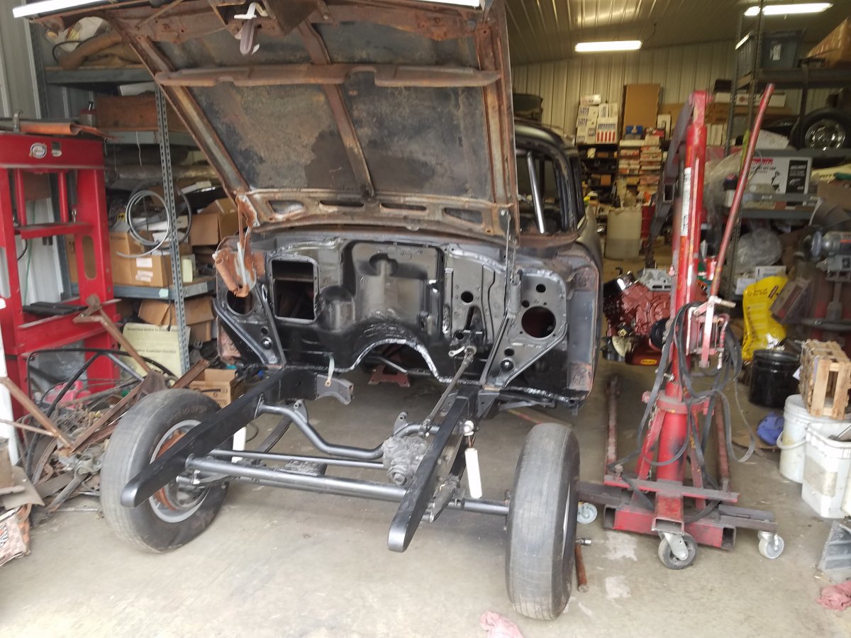

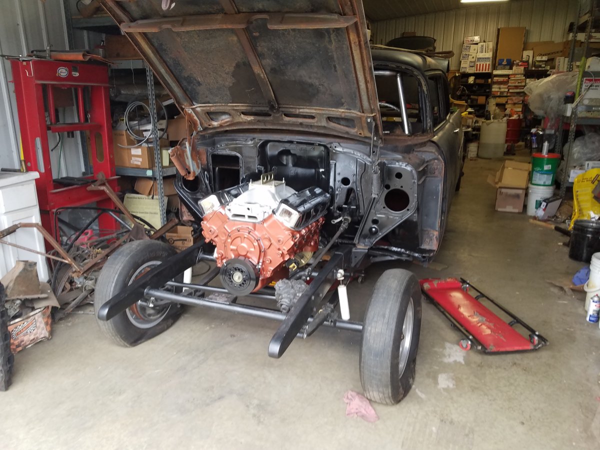

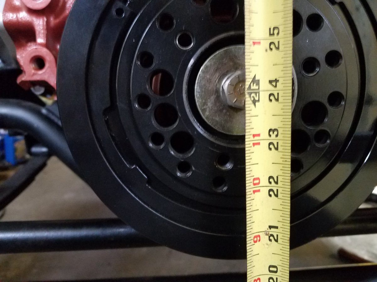

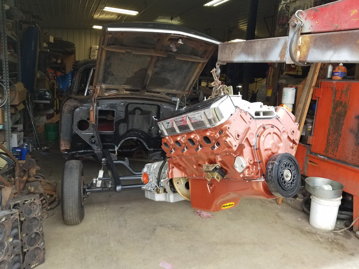

    Engine is in! I had time on Friday to work on the car. I modified the firewall, pulled the mockup block out, and welded up all the holes for the original firewall pad retainers. I then painted the firewall with SPI black epoxy. While the paint was drying I mated the engine and trans, installed mounts, ate lunch etc. After lunch I got the engine on the hook and wheeled over and installed in the car for the final time. With the full weight of the engine the front end did finally drop some. I didn't put the fender back on, but I do believe I am going to be very happy with the stance now that the front end is down some and the rear is up some. I will have to buy shorter front shocks though.

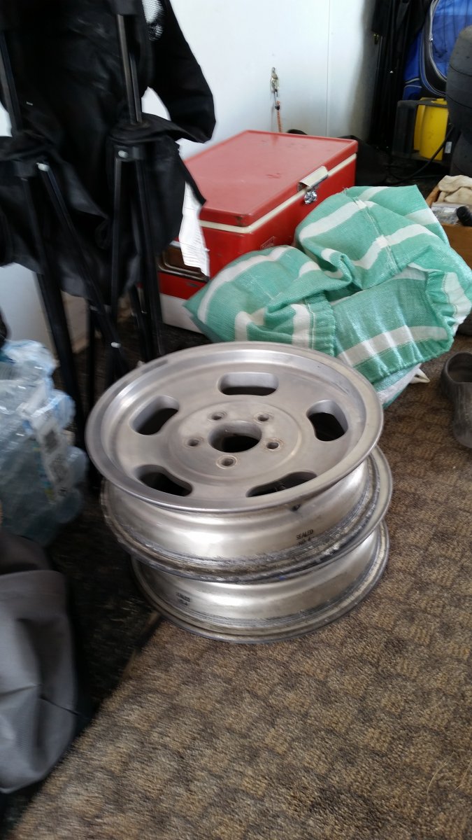

    should be a great project. I have a pair of slots like yours that are 15X8 if you are interested

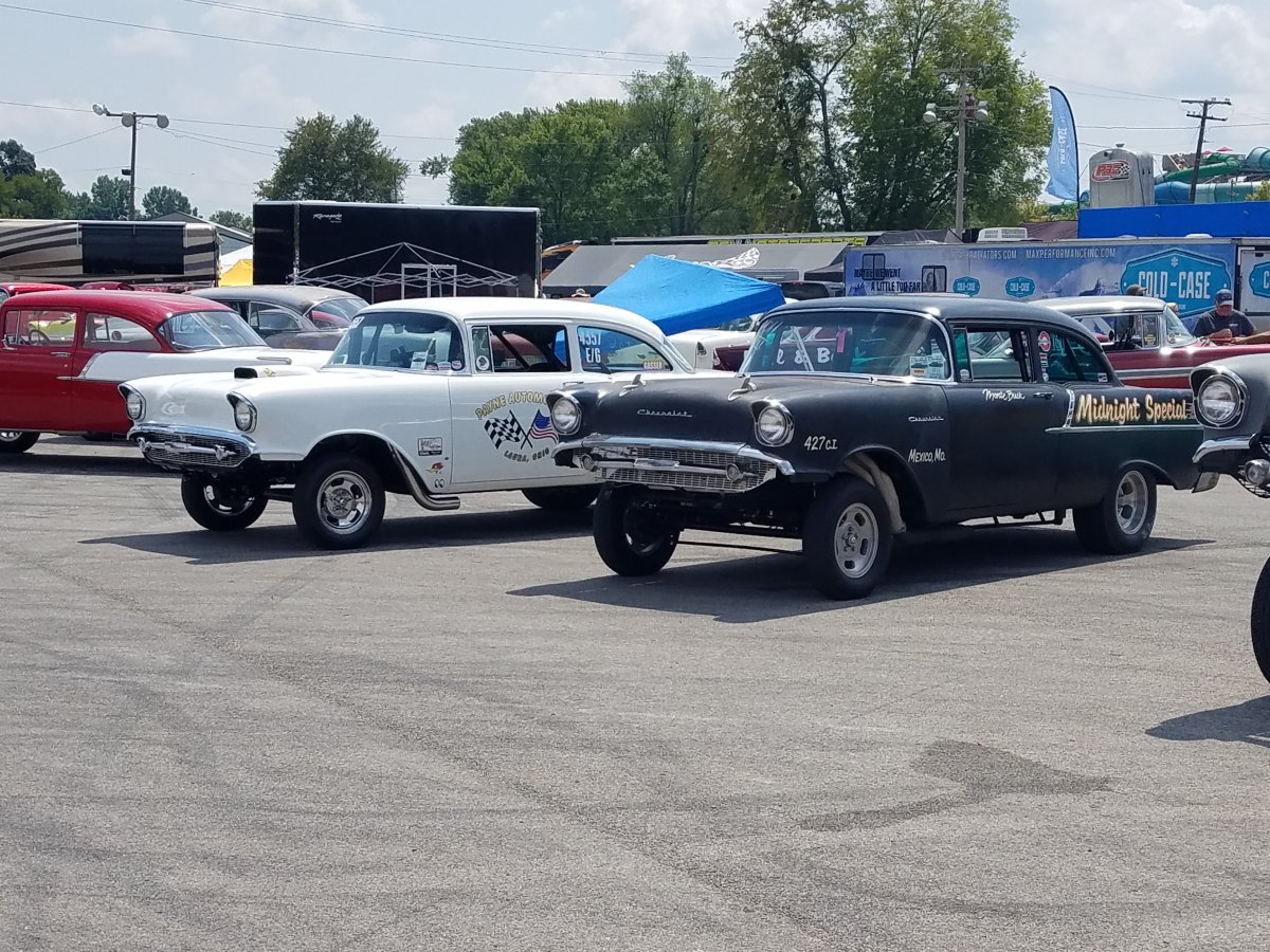

    Well I made it to the Tri-five Nats with the car and it was very well received. I had to fight new car bugs all weekend. It started with the alternator on Wednesday night. We took the car out to get something to eat and a noticed that the tach started bouncing around and the temp was climbing, so I turned around and went back to camp. We charged up the battery overnight and drove it to O'reillys on Thursday morning. Replaced the alternator and battery in the parking lot there. After that we drove up to the host hotel and it was a great experience pulling in and seeing everyone's head snap and look at me. We left the hotel to get teched for racing and pulled up in front of what we thought was the tech shed just in time for a major downpour. After waiting that out we moved to where the new tech shed is and when I got out of the car one of the front tires was leaking! Stupid paper thin drag front tires! Luckily I had a air tank in the trunk so after getting teched we put some air in the tire and went off in search of a plug in the rain. After asking around we found someone who had a plug kit so we got it fixed temporarily. After finding out that the Thursday night races were cancelled we headed up to the host hotel again and to find something to eat. We had a good time at the hotel and around 8:30 it was getting pretty wild and people were lining the street to see some burnouts. As we left the peer pressure got to me and I broke in the new slicks right there to the delight of the crowd. As we pulled in to camp we were reminded of our temporary repair as the plug failed. After making the short walk back to the camper Dad and I remembered the tube that we had in the trailer so we broke down the wheel and tire by hand and installed the tube that night before going to bed.
    I woke up early Friday morning excited about making my first passes with the car. After backing the car out of the trailer and shutting it off I noticed that the fuel pump didn't sound right. Sure enough electric fuel pump motor seized. So I trudge over to the show and start hitting up vendors looking for an electric fuel pump. Luckily I was able to find what I was looking for and get it installed in a reasonable amount of time.
    After waiting out a few sprinkles I finally get a hit at the track about 11:30. I was the in the third set down the track. Did an awesome burnout past the lights that the crowd loved. Cut a great light and pulled about a 1' wheels up launch. Tires shook when it came back down, but I drove through it to a 11.03 @ 115 which happened to be my best ever personal pass. A great start for a new car, but I wasn't a big fan of the tire shake. We adjusted the front shocks to the loosest setting, adjusted the toe in a bit and gave it another try. Shook again and slowed to 11.23. Measured toe again and it was toed out again, so adjusted it again and tried again. Shook so hard this time I had to let out of it. Got to looking at it after the run and the steering rod was bending causing bump steer and toeing out the tires. We asked around to the vendors but none of them had anything with them, so my racing weekend was over. I parked in the gasser gathering and spectated the rest of the weekend.
    Overall it was a great weekend and I enjoyed every minute of it. I had two goals and that was to get a 10 second slip and qualify for the quick 16 gasser shootout and I wasn't able to do either. But I do feel good knowing that the car was capable of doing both of those things if the steering wasn't fighting me.
    I plan on making a heavy duty steering arm and getting out again this year and making that 10 second pass!
