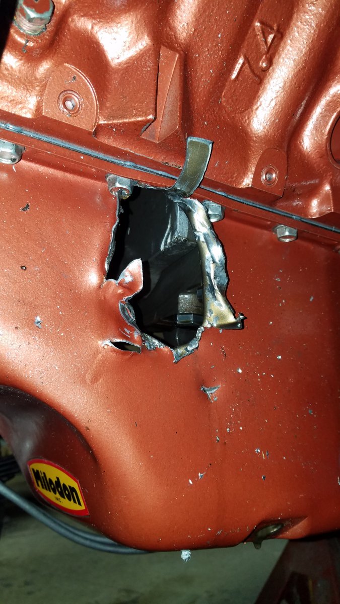

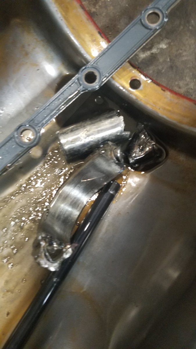

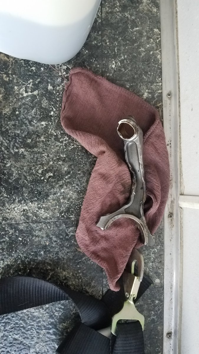

    Well this can't be good:
    Some **** hit the fan
    Spun a bearing and kicked out a rod at Eddyville on 6/8. Exactly 367 days since first startup. It has been a real kick in the teeth. Block, Crank, rods, and pistons are all done. Luckily the top end is all ok. I haven't determined what I am going to do to fix it. Can't afford to build another 496 right now. Might use the 454 crank and rods from the previous build and build another 454. Glory Days race is out for sure, hoping I can pull something together for the Trifive Nationals.

    Sorry man. It ****s, nowhere to go but up from here. Blocks aren't that scarce. Also, it's possible to install a Mark IV crank in a Gen V block with an adapter. Opens up more years worth of engines to you. Gotta buy an oil pan anyhow...
