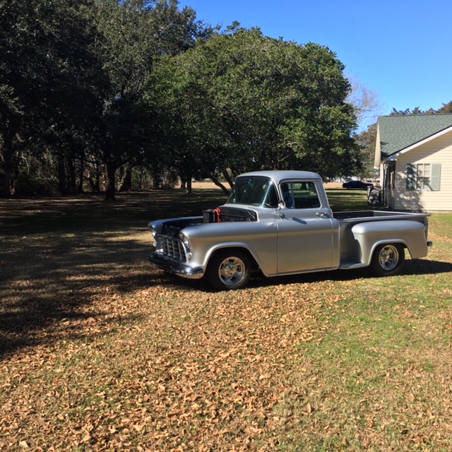

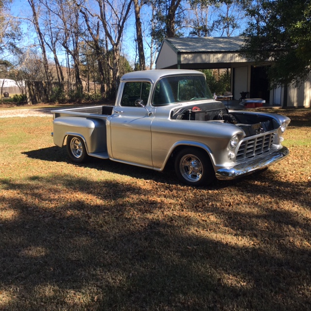

    Here is mine. Heidts coil over front with 500 lb springs. Power rack. Slider leaf springs with lowering blocks.
