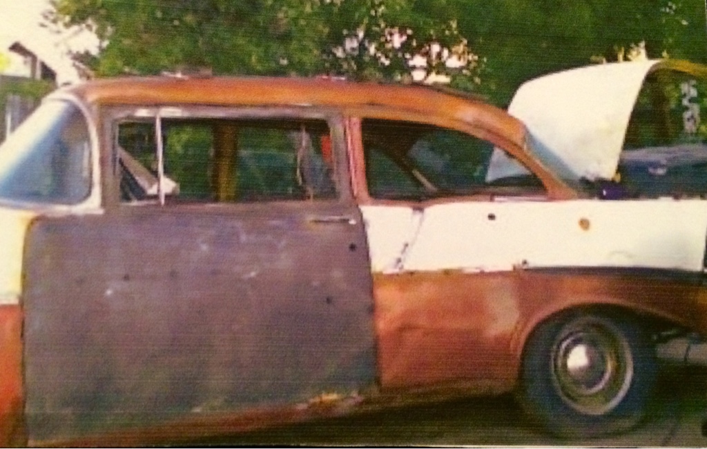

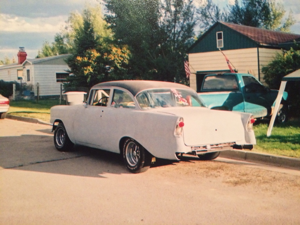

    Thanks guys yes I am stoked to get started I have actually done this before with a 1956 and it turned out slick. I'll post pictures I used 2 door, doors but I think on this 57 I am going to do the 4 door, doors and splice in the extra and also put all the measurements and high detail pictures through the process to show what you can do with what you have and give the little details all the other feeds are missing I'd like to get multiple measurements from a 2 door, door to make this work so any help would be greatly appreciated I get the extra front 4 door, doors this Wednesday! I'll post pics I found a couple of dang good rust free ones...

    Sorry In advance these are pictures of pictures and there some I took in 2007
