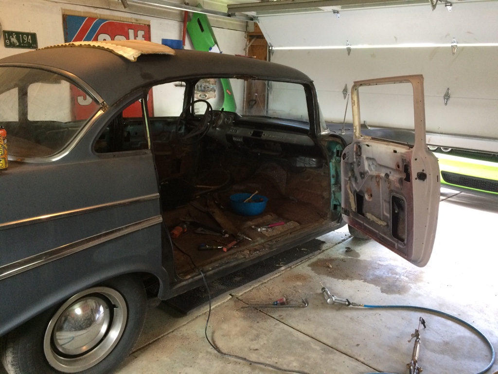

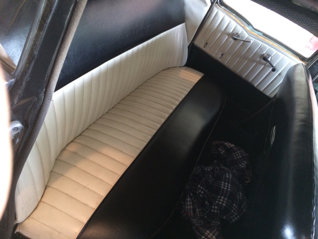

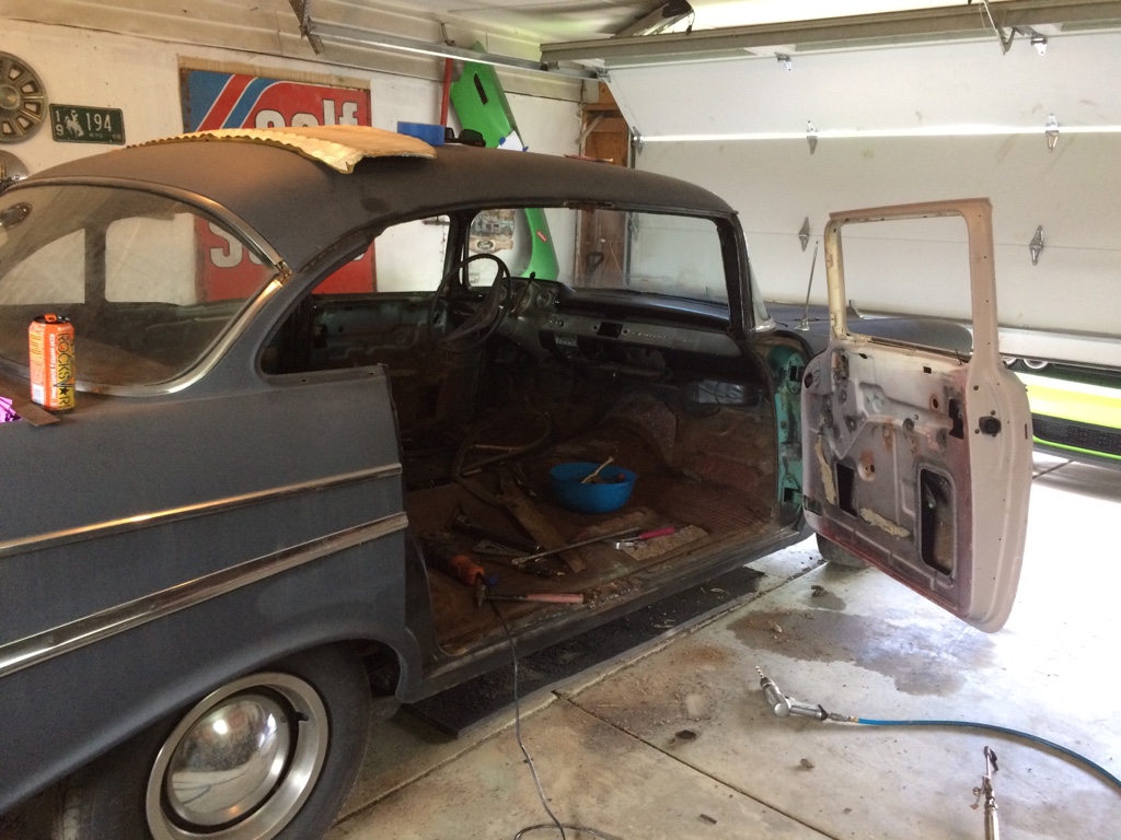

    Today I am going to rip out my interior because actually it has some nice seats in it with great upholstery. I am going to use the same front seat because no one needs to be in the back seat anyhow haha besides my kids are small and can climb over

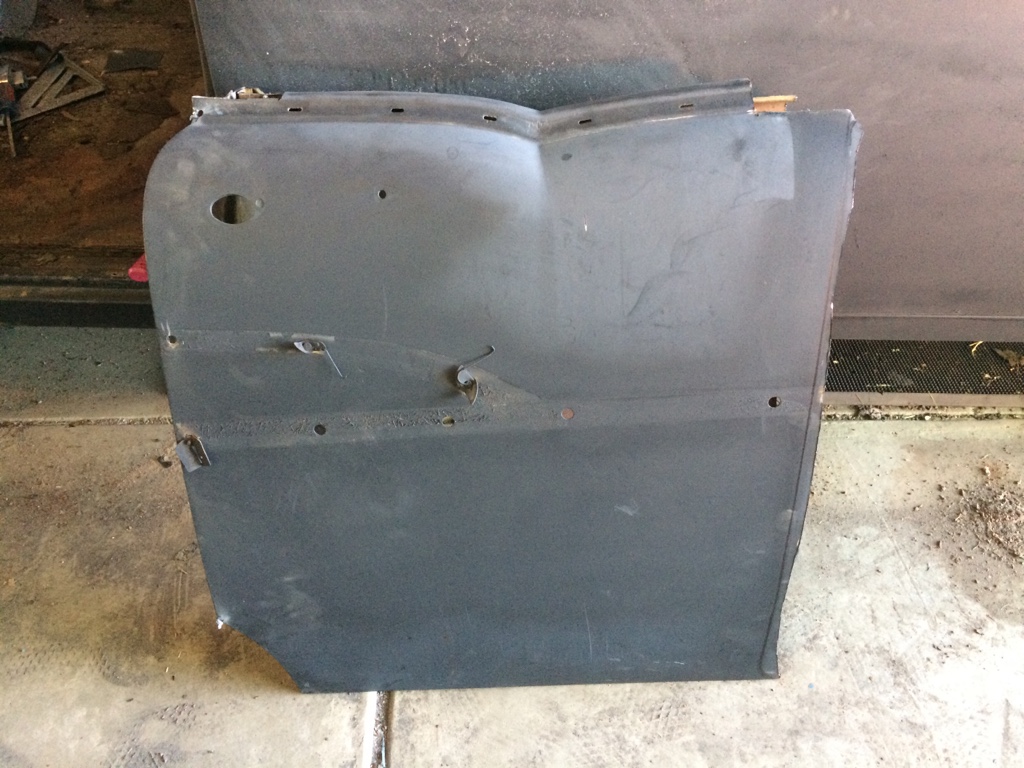

    [​IMG] so I did it I cut out 5 inches of the first door and 11 1/8 of the other I spliced it and this is what I got! It took a bit of fab work and it latched to the post really well even just sitting in place. I had to modify the body line at the top of the door where your arm would rest because it tapers in two directions but other than that it wasn't nearly as much work as expected.

    In my picture above I have everything just tacked it worked out nice! Today a guy called me and he had some 2 door, doors from and old g***er that had the insides cut out but he still had the insides I payed way to much for them but I did get them none the less I will be attaching a photo and full measurements asap also I'll post all of the differences I can see [​IMG]
