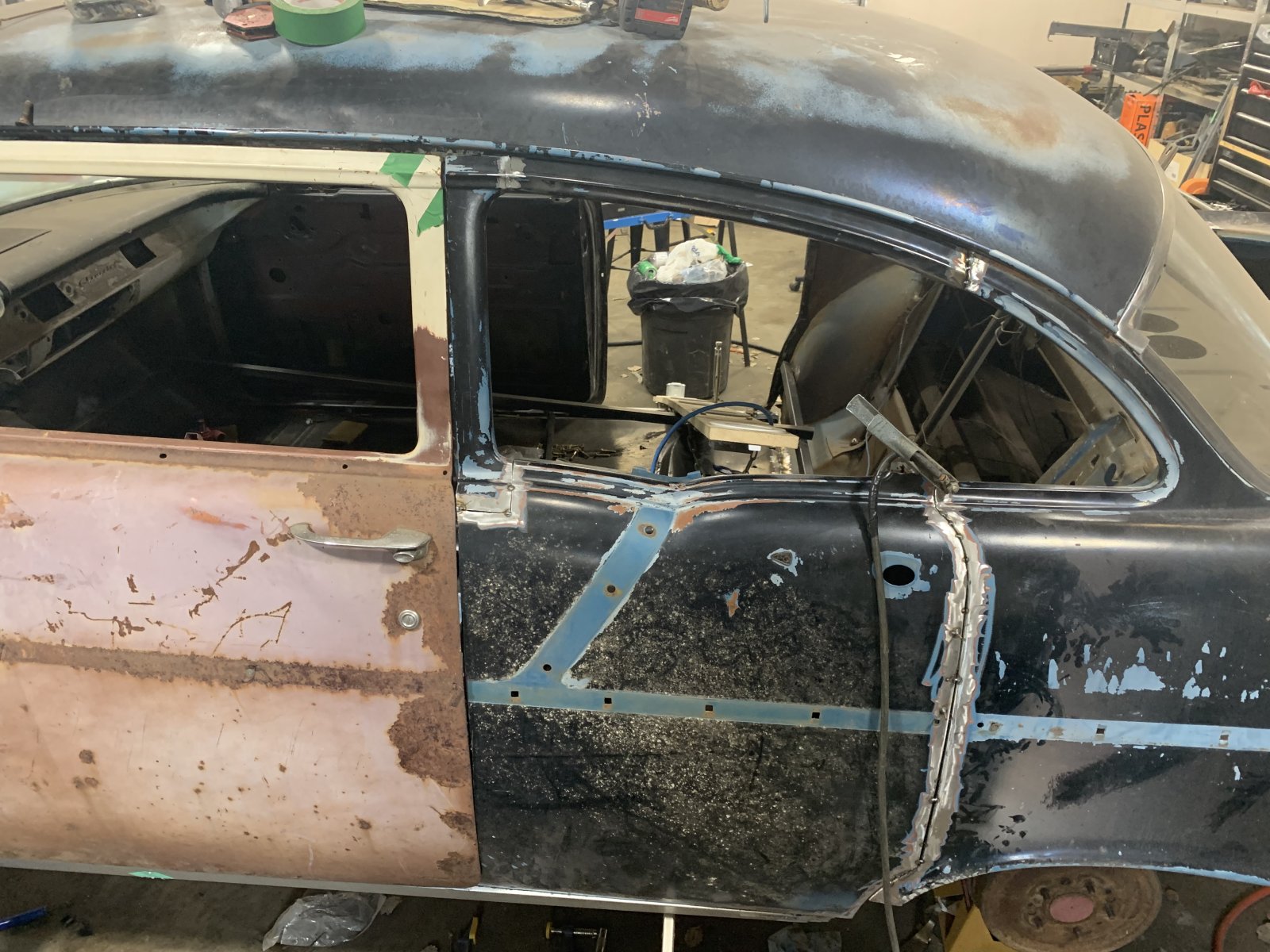

    ^^^^^ Here’s another reason for it. See how the rocker is a bit twisted (see many 57’s this way) inward at the bottom? It use to look worse but I pushed the fender in but now lower door edge is outward a tiny bit (50/50 compromise) so it looks better than it was. 59E1B8CE-9A43-435F-947A-DA6A3D44373B.jpeg

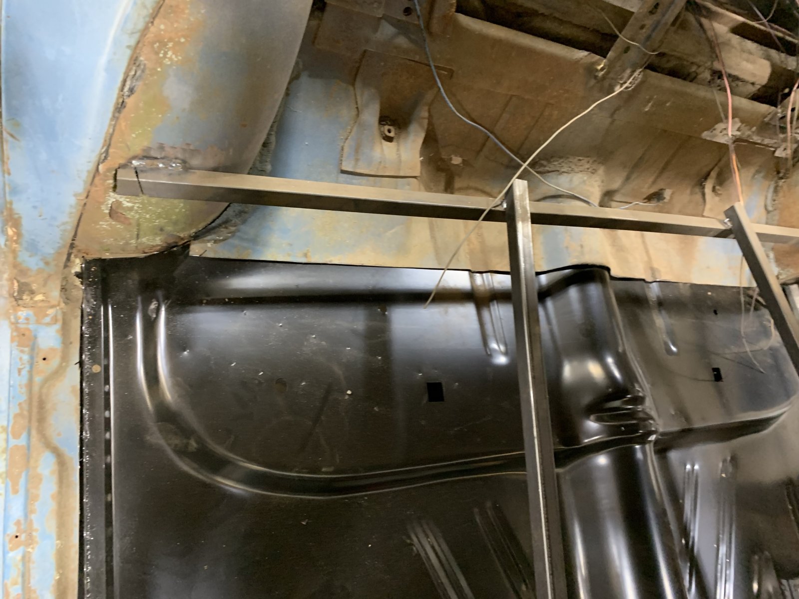

    Got the floor in today. Sort of. After prepping I had just enough time to get it under. Seems to line up pretty good - I cut it and didn’t use the two rear mount - I’ll likely flange and weld that part together. Bit of a gap around the trans tunnel. Looks like after all that rocker work, I’m gonna have to keep at it. That rocker is about 1/2 inch too high…. Should I double shim the floor to meet it? Or lower the rocker? B563E8A8-3808-4FCF-AF46-4D49A3C9FD4C.jpeg FDA45B72-83C0-47F8-BB73-BAD072A0A080.jpeg 33D91B2B-FAA4-4253-B5BF-8488955ADB85.jpeg DD318D17-35C1-4D55-8B15-A2CC2B3E7FA4.jpeg 1E2B46D9-F870-4AC0-83F3-DA7A5A579031.jpeg

    Did you get the 4 door sedan doors with the car, could you hang them and see if they line up with the rockers? If the rockers are too high, the doors aren't going to close. If they're in the right spot, the floor needs to come up.
    I could take roof to rocker measurements of my car if that would help. You should check the roof to rocker measurement on your car on both sides and see if they match. This is a critical alignment part so it's important to get it right.

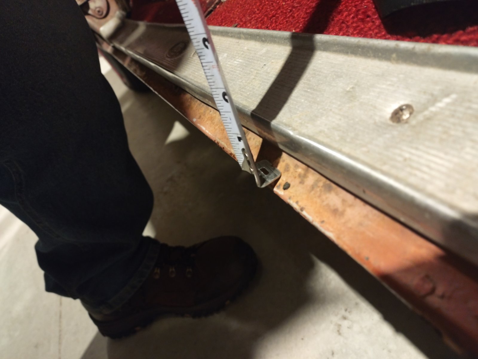

    Sure thing. So I want to make it very clear since I'm using a tape measure and that's not the most accurate thing, see where the foot of my tape measure is? It needs to be right in the center of that outer ledge of the rocker. That ledge isn't parallel to the ground, it slopes down a bit toward the outside of the car, so if you have the end of your tape all the way out to the edge or slid all the way in, the measurement will be off.
    But if you have it lined up right in the center, the distance from there to the underside of the drip rail is exactly 44 inches. That section of my rocker was never replaced (surprisingly), you can see it's got original pink paint there yet. I took the measurement just forward of where the old 4 door pillar was removed.
    I'm curious to see what your measurement for that is, on both sides. Not that the tape measure is an exact thing (it's definitely not, even a slightly differently shaped tape measure foot could throw it off a hair) but if it's wildly off, you'll know where your floor mis-alignment came from.

    Just measure. Drip rail to rocker is the exact same measurement as yours - but that’s likely because I planned the rocker around the door opening. Im betting I need to make the rocker match the floor then pull the roof down another 1/2 inch.
